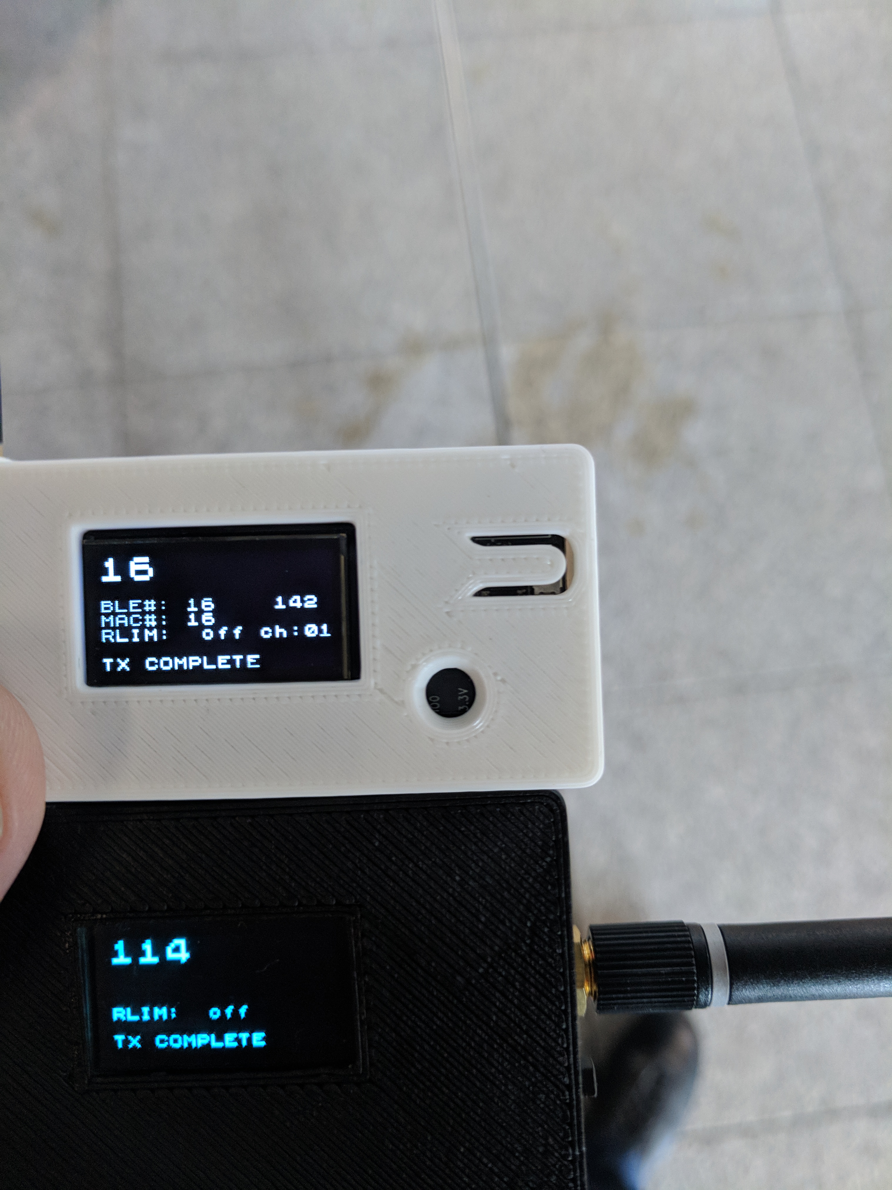

@Charles There must be a bug came in with the new code. Counter display now stucks at 16. Device with older software counts much more.
Humm, we changed lot of things, including Hash & Salt of MAC address. I’m currently trying to understand what all is doing. I’m going to push a new salt & hash, waiting for your comment once done.
Anyway, may be we could have new define to avoid hash & salt and store full MAC (I know not good for privacy but we need to have a working reference to compare). Let me 1H between lunch to see what I can do.
Hey on your picture, what’s the 142 BLE devices seen around and fixed to 16, that’s strange, may be we have a real bug

The 142 BLE could be true, i was in an environment which is known for having ~800 beacons from a marketing company installed.
Hmm, i re-thinked this. It could be correct, if the vendor filter filtered out the most of that 142 BLEs because they are stationary BLE beacons, not mobile devices. That would be the desired result.
But then we still miss the Wifi counts which the other device showed up. In worst case reason for this is, that the hashing consumes to much time and we have packet loss on the device with hashing.

Meanwhile i did a second test in a very densy area. Definately a bug: Counter seems to stuck at 16.
Yeah I changed things on display and done proper casting of counters. should works better, thanks for testing

Merge done, now i see counts > 16 again!

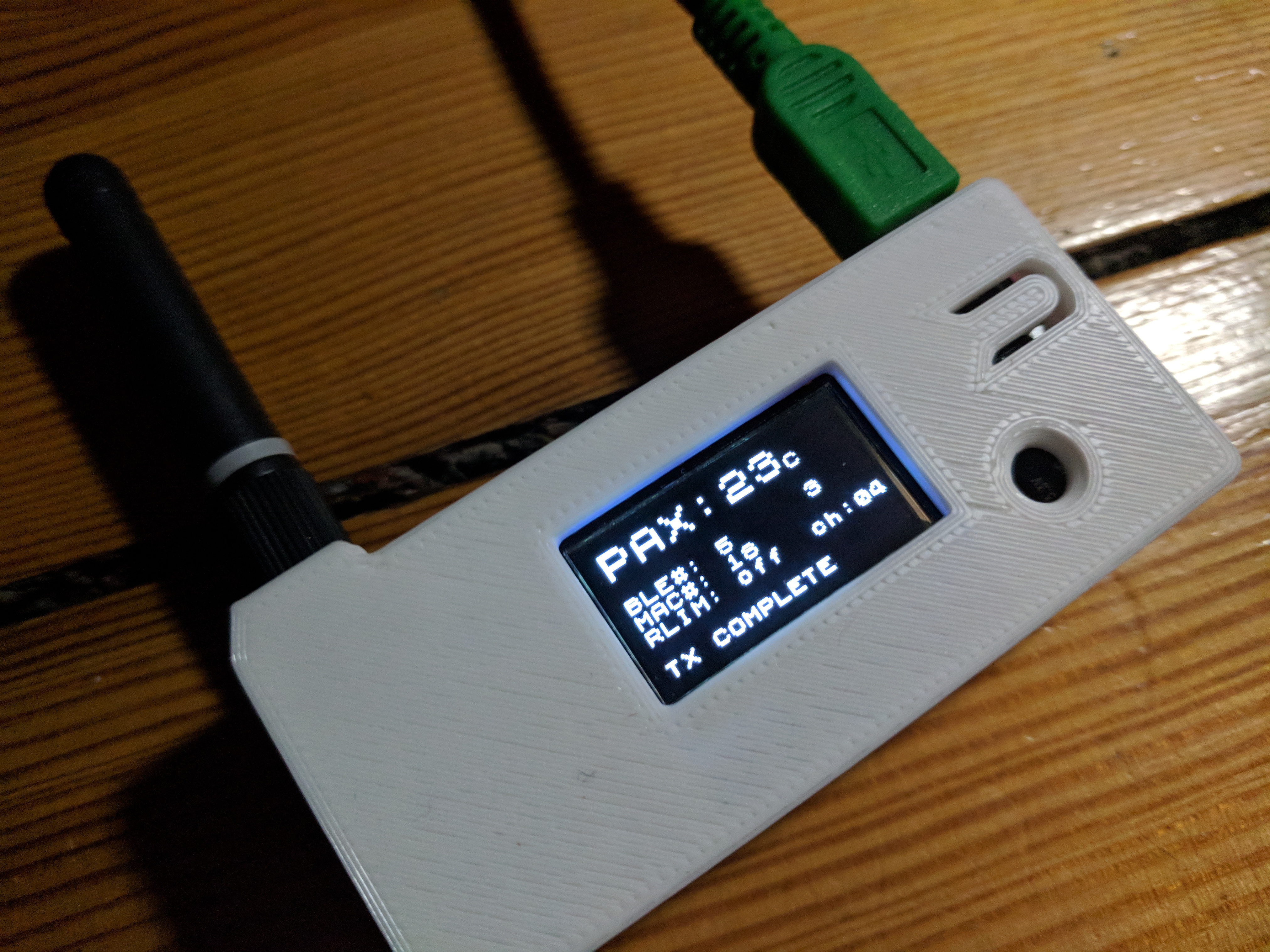

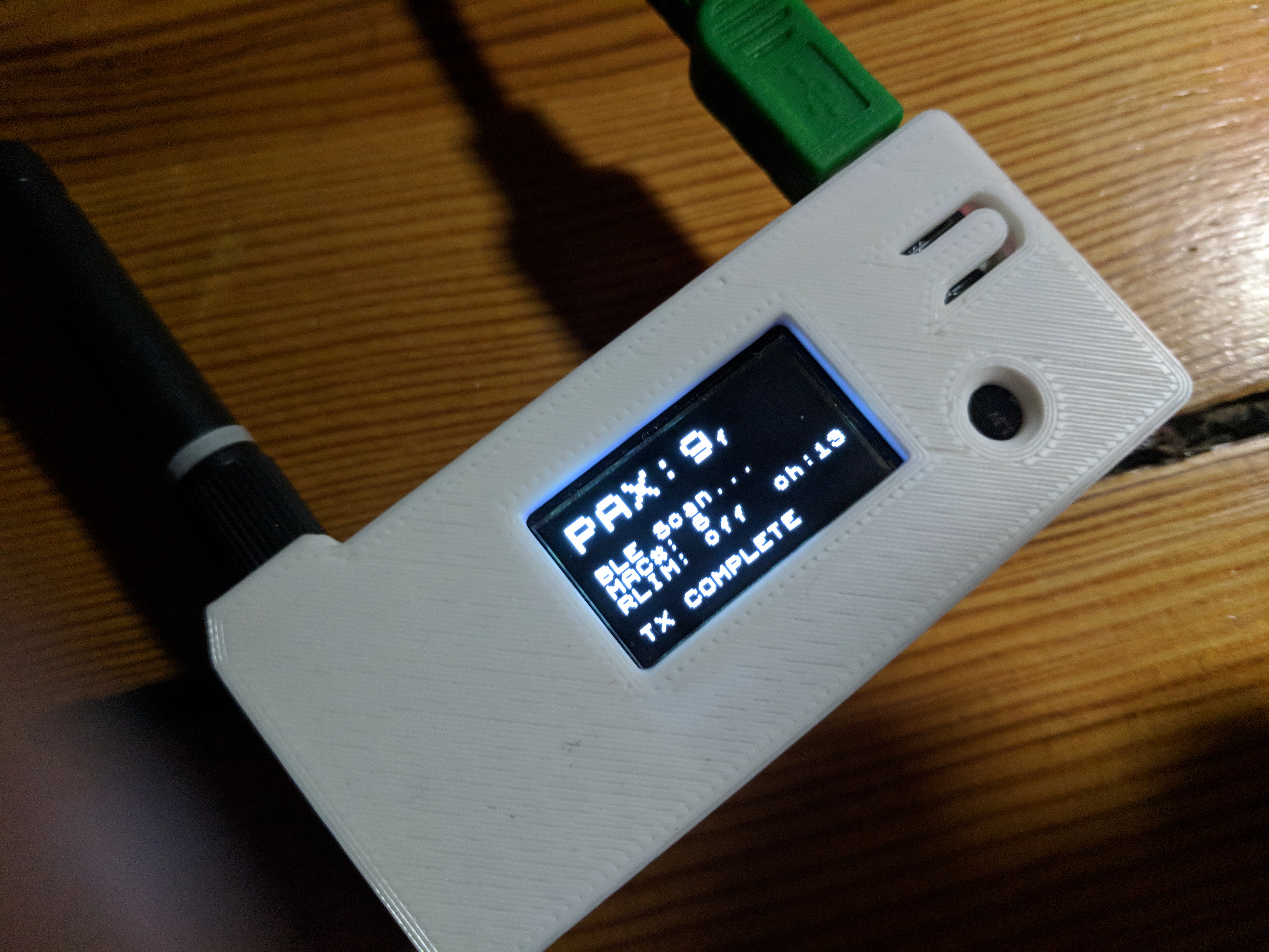

But the display garbage problem still persist, see picture.
funny, this odd bug seems not to produce pixel garbage, but characters.
Looks like something with u8x8 lib, maybe the SSD1306 driver is buggy or not fully compatible with the display controller.
Or data transmission issue on I2C bus?

Would you mind trying new PR? I think the bug is gone
Avoid display in Wifi Callback, in BLE looks like no problem.
aah, that looks good, working still with u8x8.
