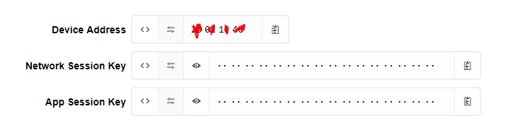

i have read and folow the information about ’ Try to get the ttn-abp.ino example working first.’, in the console i get the message that it is been send but on ttn the device is never seen.
In wat format do the 3 variabels need to be?
The required format depends on your code and library. Most examples explicitly state the required format in comments near the keys and address.
If you click on “<>” in front of a value it will be displayed in a different format (which will be listed so you know which format is being shown)

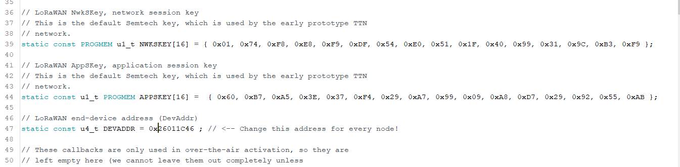

Sorry but i can not get it working, this is what i have now. But the device is never seen. (i will reset thet key’s after a working session).
According to this tutorial the keys should be MSB. Are you using MSB format?
