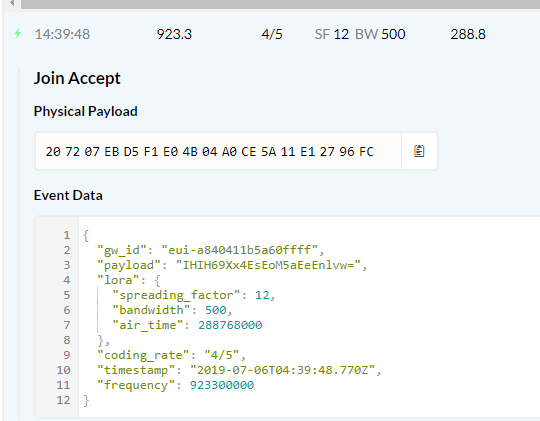

I’ve reached this stage. I can see the join request, and then the join accept, however it looks like the node never receives the join accept. Below I’ve attached my configured settings in LMIC, the Gateway admin settings and what TTN says it is transmitting the Join Accept on.
I cant work out why the end node never receives the join accept.
gatewaysettings joinaccept lcimsettings
The downlink packet uses bandwidth 500, not 125. Are your gateway and node setup to use 500 for downlink?
Try to use ABP in stead of OTAA, LG01-P has Downlink issue due to strict time requirement on the end node rx windows.
