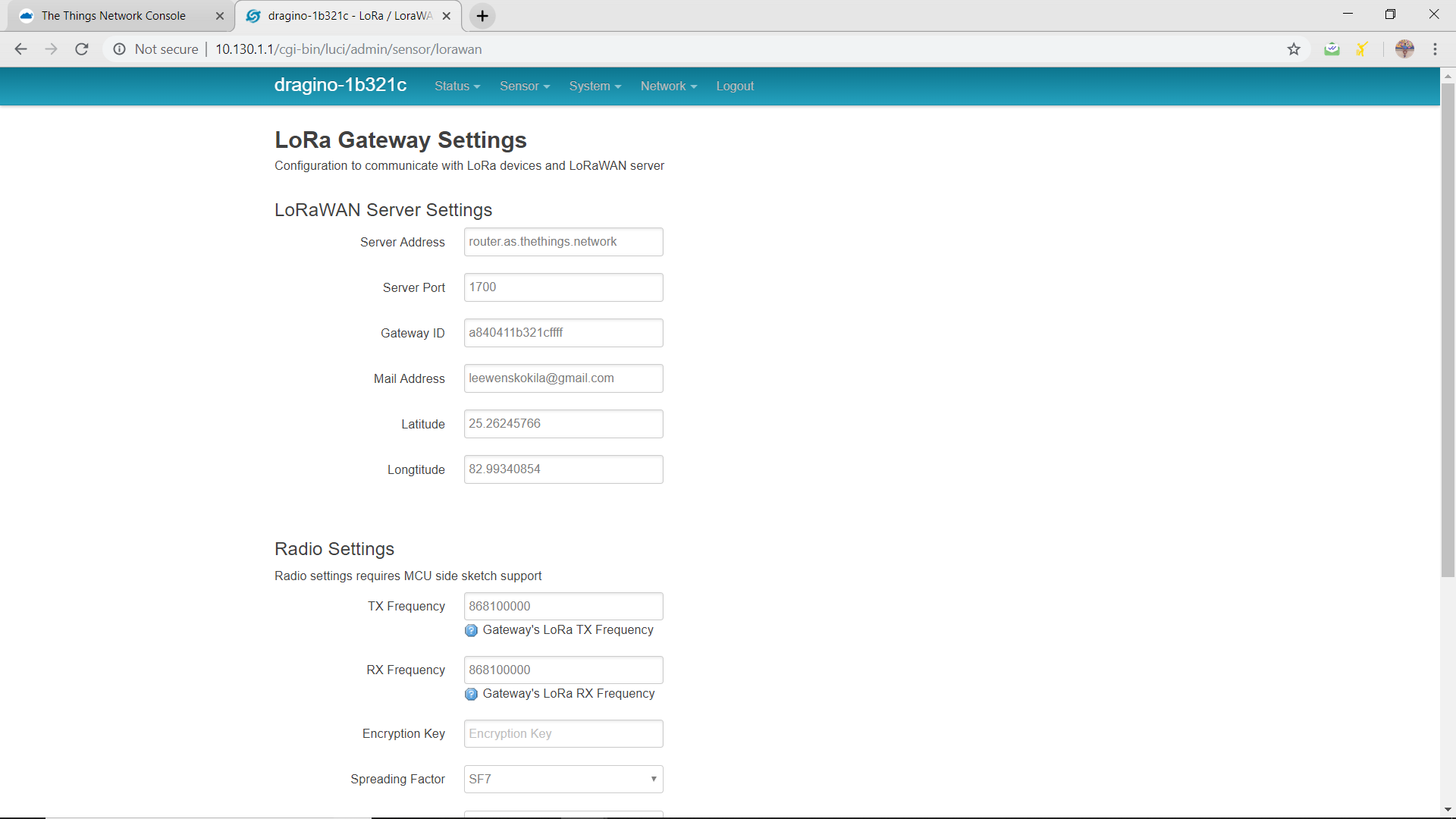

I am trying to connect my Dragino Lora Gateway to TTN server using the link that I mentioned below
https://wiki.dragino.com/index.php?title=Connect_to_TTN

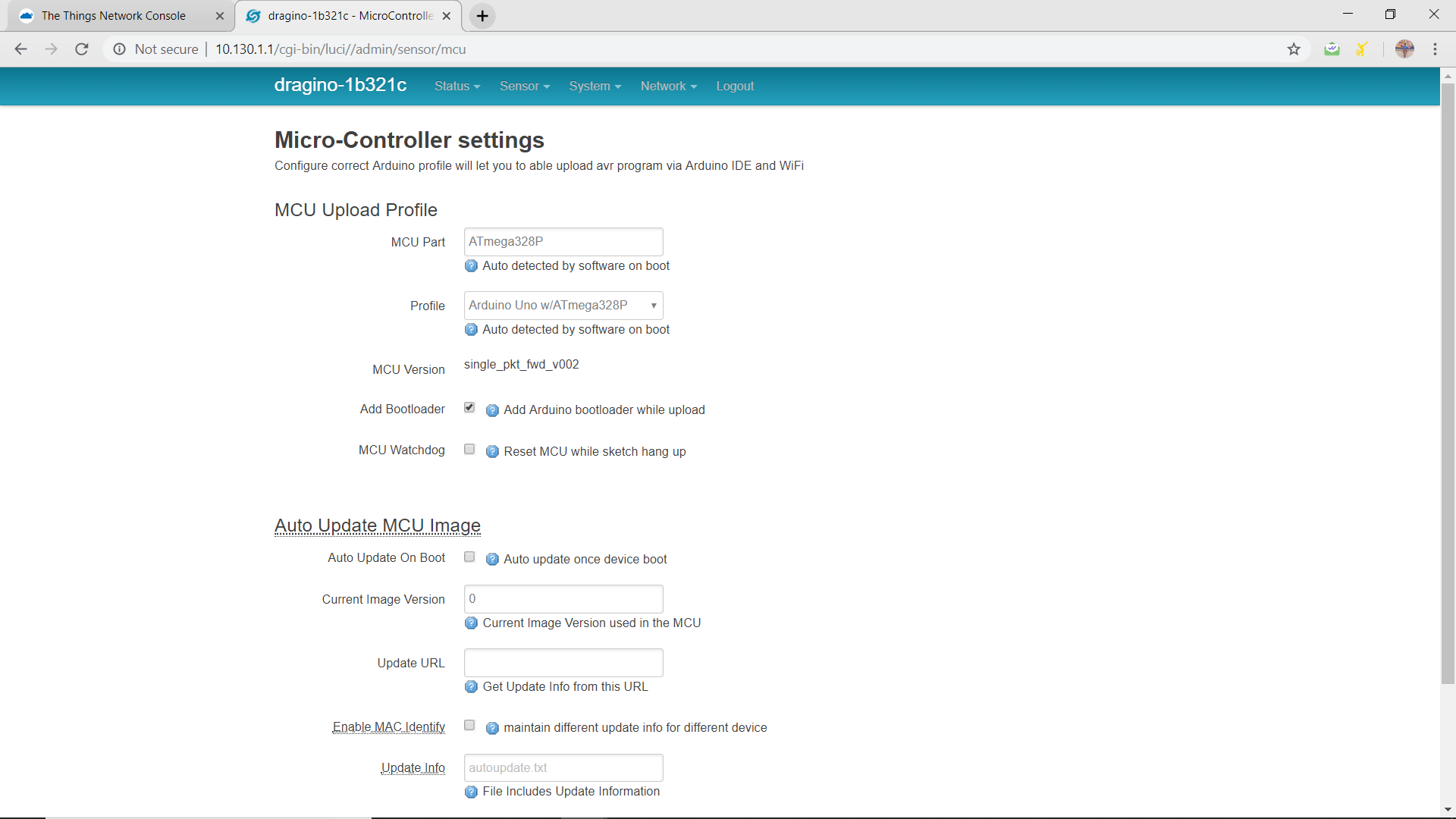

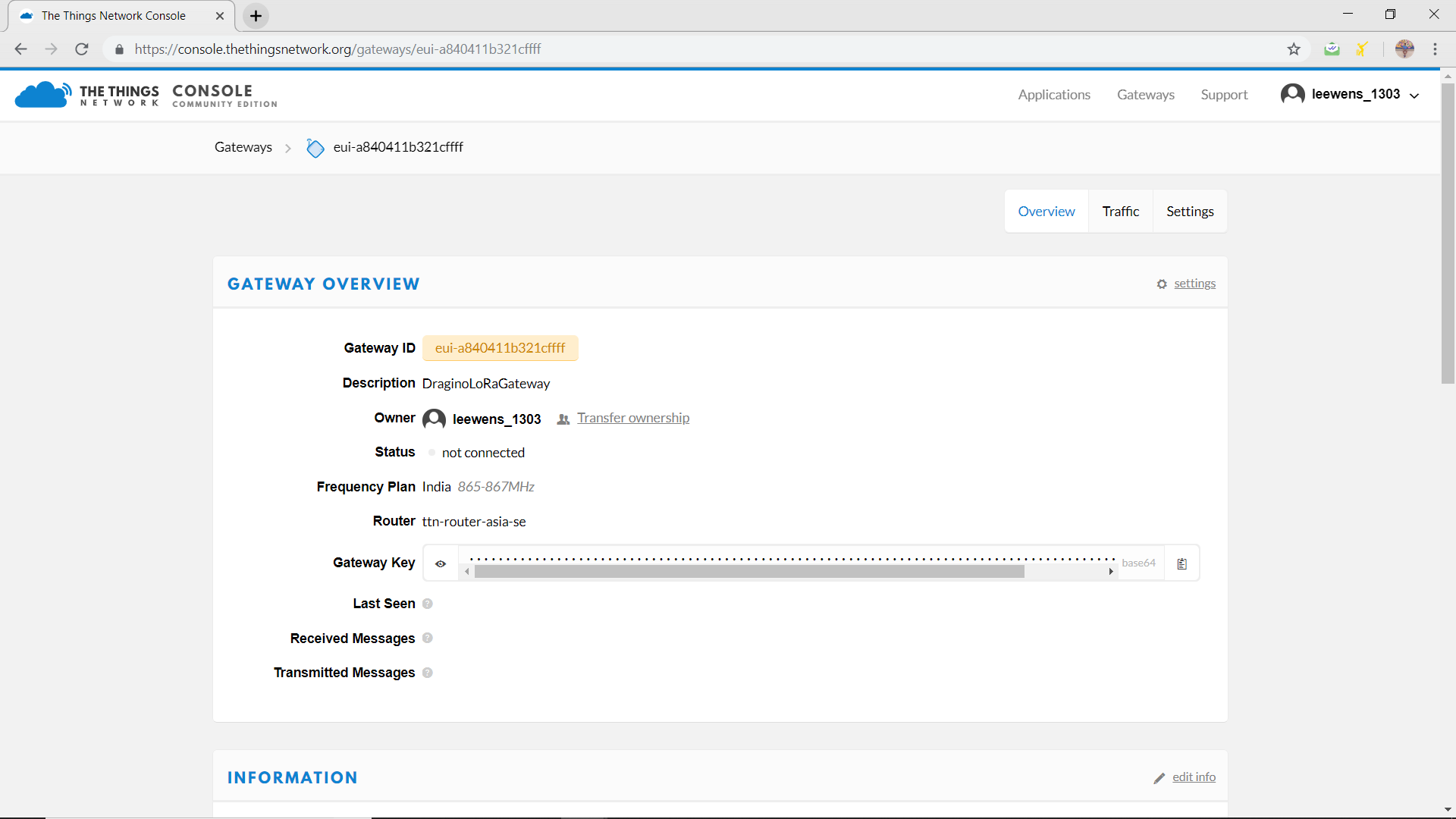

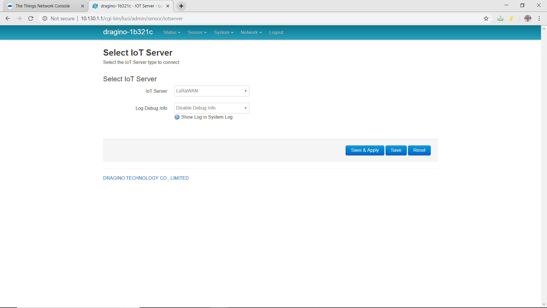

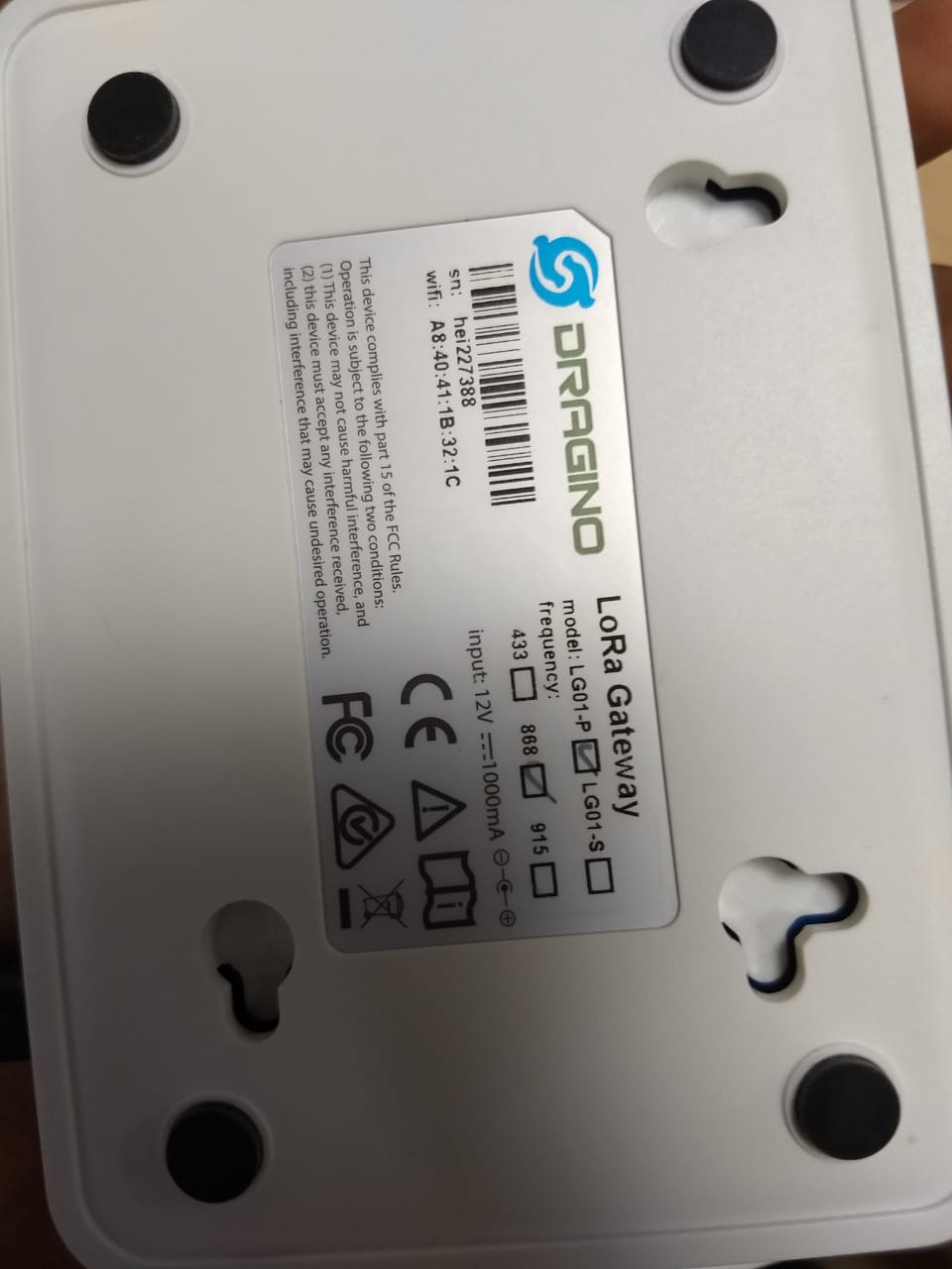

Here are the snapshots of my gateway device sticker on the back side with information about it and TTN page where it shows not connected and also dragino page with IP 10.130.1.1 all step mention in official dragino site that I performed but not able to connect gateway to TTN server. Please help me where I am wrong.

There was a thread on here just yesterday about the Dragino gateway, might be worth a read;
Have you made sure you’ve connected your gateway to the internet?
