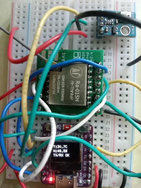

It works fine for me with ESP32-C3 SuperMini and AI RA-01SH.
When I replaced AI RA-01SH with HT-RA62, it did not work. I used RadioLib 7.5.0.
Still don’t know why. Even though the pin of these two modules are exactly the same.
“It did not work” - well, what did not work? radio.begin() - what was the return code? Tx/Rx - what functions, what were the return codes? Lots of tools are provided in RadioLib to get to the cause.. a simple “it did not work” will waste a good module.
ESP32C3 did not boot. Only saw “ESP-ROM:esp32c3-api1-20210207” on serial monitor.
Not even execute setup().
May be problem is come from pin conflict.
So not really an identified issue with RadioLib given that it didn’t even get as far as running it, more about the hardware even getting to the run the firmware.
