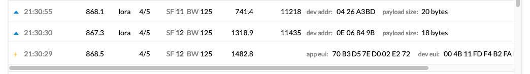

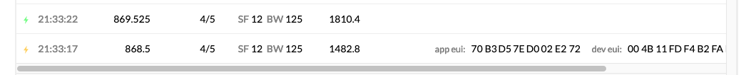

The gateway is in v2, same gateway, same place for both test (just had to reset the device. Here are the gateway data dumps:
Once the device is in v3: no Join Accept from network server
Capture d’écran 2021-02-08 à 21.32.41
Once back in v2: join accept received from network server

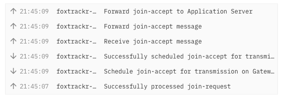

Strangely, I see in console v3 processing for this join … but about 10 minutes later ?!?
Capture d’écran 2021-02-08 à 21.46.46

Step 8 : I saw trace in v7 with a Reception on join-request but it is timestamped at 21:45 when the step 3 was at 21:33

the issue is the timing … 14 minutes late.
And i just got it one time but the device is retrying. So it is strange

No I don’t see it. I just got the log posted on top. But I got it one time only in my multiples test.
Blockquote
Do you have access to the gateway logs?
Via the TTNv2 gateway logs (the one copy pasted on top). Basically there is no join accept request.
