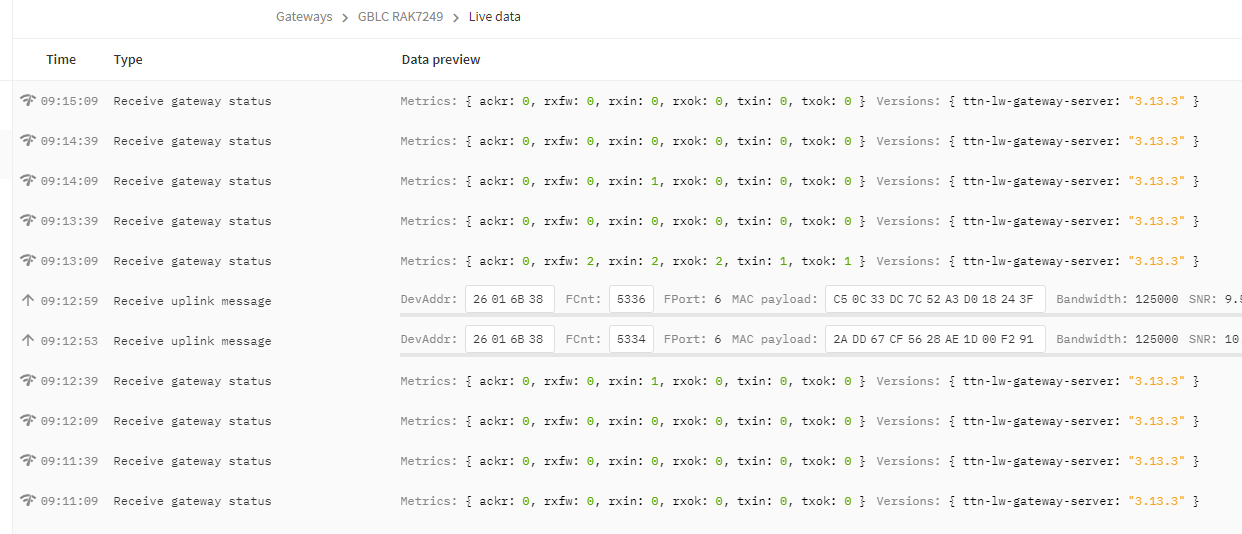

Thanks for your swift response, Yes I am using the same gateway_ID on V3.
So basically, the Gateway_ID is supposed to be globally unique being MAC address which is embedded in the Gateway itself if not mistaken, adding FFFE between the 3rd and 4th position of the MAC address to make it EUI.
We are not supposed to change the Gateway_ID on the Gateway itself or even the console “Correct me if I am wrong”. otherwise if we can by mistake register someone else Gateway_id…
trust you are doing good and thanks for your swift response.
Infact, this is a RAK7249 Gateway having EUI AC1F09FFFE014970 and the owner is me and you can clearly see from the logs, but i have a question, how come this Gateway-ID is under Rez20004 account?.
As I understand it the EUI is considered immutable (often derived from MAC add as you say - ok some GW’s allow a reprogramming of EUI as well but thats a complication here) and the EUI identifies GW to LNS for registration and data exchange, but Gateway-ID is a ‘label’ and can be anything you like or that is convenient (as long as using right character limits) but should not be too obvious as others in same cluster may use same name - ‘mygateway’ likley to be picked by others - hence you get error saying GW ID already in use. e.g. I could go for ‘jeffs-brilliant-ttn-gw’, but another Jeff might choose same (ok unlikely) before me but then I could use ‘jeffs-brilliant-ttn-gw2’ and be ok (assuming another Jeff has’t… you get my drift) in many cases I’ve seen people adopt the eui for ID also (as in this case) but given that is just a convenient label it could be finger trouble and a mis-type of id from similar model leads to situation like this with same GW ID under different account… just thinking… or there could be situations of prior ownership/registration, mischievous claiming (seen recently in Greece?) etc.
