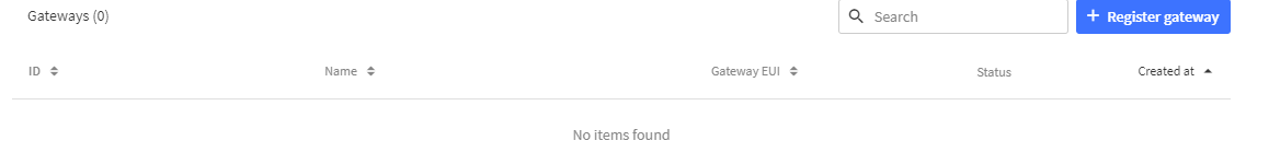

Capture
I have got a LtAP LR8 LTE kit with hardware ID 353036203A002E00
my gateway list
Where are you? Which cluster have you logged into/previously registered into/deleted from?

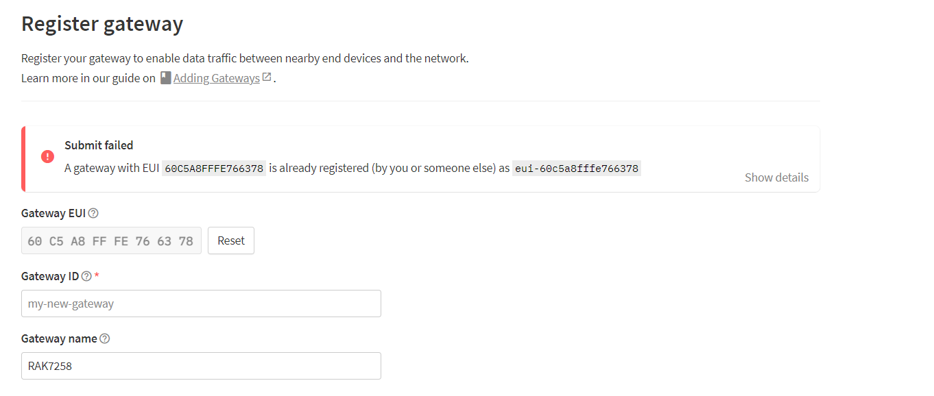

Hi I have been trying to register the registered gateway using different ID but it says that A gateway with EUI 60C5A8FFFE766378 is already registered (by you or someone else) as eui-60c5a8fffe766378. What should I do now? Pls help…
