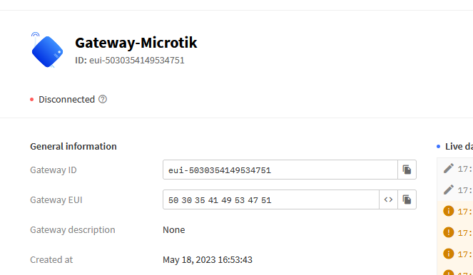

I did search indeed, found some threads about people saying their EUI was already redistered like this one:
In those threads I did understand that it was necessary for someone who had already registered the EUI to delete their gateway or someone for the team did reply that they would delete cause it was not in use.
Anyway if I understood from your answer, I could choose a different EUI for my gateway.

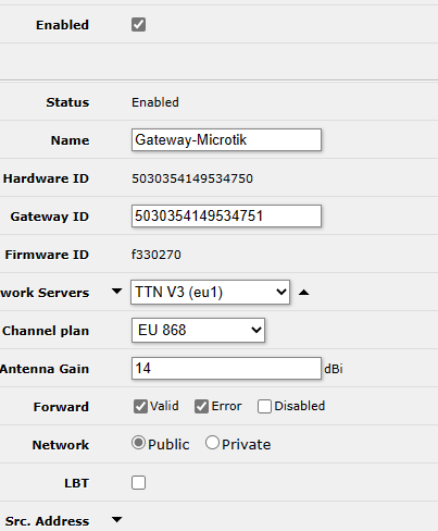

I did set it on the gateway:
Unfortunately this way the gateway isn’t connecting:

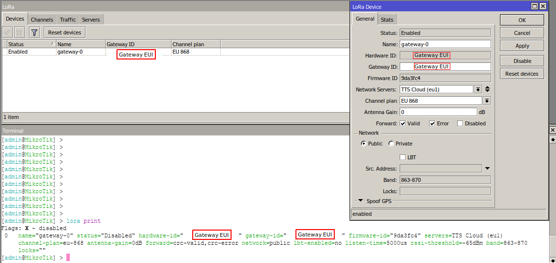

The guide by Microtik tells to use the default Gateway Id (which is the same as the Hardware Id) as EUI:

The gateway is connected to the internet, lora is configured properly, so I guess the problem is the same as user ether had, but as I can not edit Hardware Id, and that Id is already in use I don’t see a workaround.
