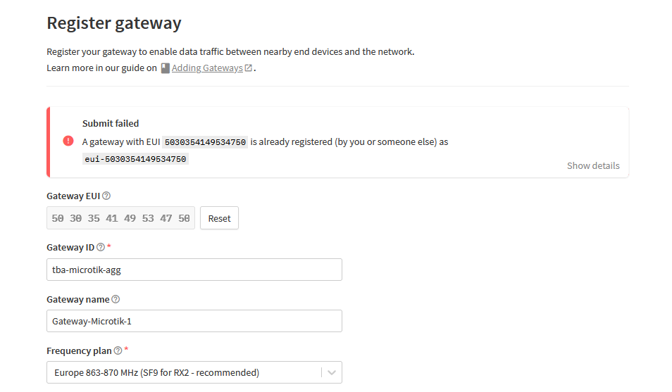

I just received a LtAP LR8 LTE kit. After configuring it I did proceed to configure it as new Gateway in the TTS Community edition. When trying to set up I get the message:
" a gateway with EUI 5030354149534750 is already registered (by you or someone else) as eui-5030354149534750"
“code”: 6,
“message”: “error:pkg/identityserver:gateway_eui_taken (a gateway with EUI 5030354149534750 is already registered (by you or someone else) as eui-5030354149534750)”,
“details”: [
“namespace”: “pkg/identityserver”,
“name”: “gateway_eui_taken”,
“message_format”: “a gateway with EUI {gateway_eui} is already registered (by you or someone else) as {gateway_id}”,
“attributes”: {
“administrative_contact”: “jgerstmeier”,
“gateway_eui”: “5030354149534750”,
“gateway_id”: “eui-5030354149534750”
“correlation_id”: “783d39f2fd8f4b418d6f58df2594bac0”,
“code”: 6
I don’t get why, this EUI is the one in the device box label and I’ve never used it. May it have been tested and sent back after registering it on the platform?

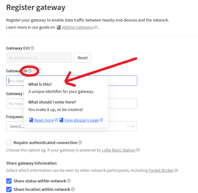

:slight_smile: Just overwrite the gw-id offered by the system at time of registration. System helpfully suggests a GW at time of reg based on the EUI…fine 1st time around but no good for a previously registered GW that has been deleted as
Also the GW-ID = ‘eui-xxxxxxxxx’ is very cryptic a version say
GW-ID = ‘allomart-dgno-gw-no1’ much more user friendly or say
GW-ID = ‘foxes-farm-north-field’ or ‘foxes-farm-south-field’ or ‘allomarts-warehouse-gw-no1’ or whatever…
…get creative :wink:

I had no problem with the Gateway Id, when trying to register I did choose a different one. The problem is I can not use the EUI provided by the gateway (5030354149534750):
imagen
As you can see I can set a custom Gateway ID, but what about the EUI? If I use a free EUI it will not match the default EUI of the Gateway and it won’t connect. Sorry for my ignorance about the TTS, but I don’t get the workaround you are suggesting
