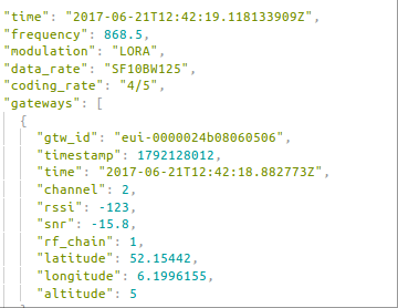

just tried again at home
in console/device : reset frame counters
reset kiss lora and almost immediatly join was accepted (study room at home)
see screenshot
Signal received bij gateway de Mheen
frames: 0, 2, 3 and then kiss lora keeps sending ( blue light and terminal screen, but nothing in my console)
So i keep hoping .
I do not have any idea what could be wrong.

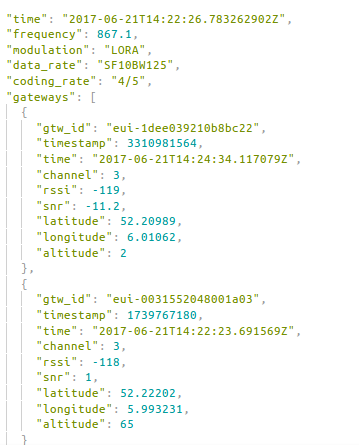

“time”: “2017-06-21T12:26:05.910675984Z”,
“frequency”: 867.3,
“modulation”: “LORA”,
“data_rate”: “SF8BW125”,
“coding_rate”: “4/5”,
“gateways”: [
“gtw_id”: “eui-0031552048001a03”,
“timestamp”: 3348826692,
“time”: “2017-06-21T12:26:04.818055Z”,
“channel”: 4,
“rssi”: -107,
“snr”: 7,
“latitude”: 52.22202,
“longitude”: 5.993231,
“altitude”: 65
“latitude”: 52.216347,
“longitude”: 5.9813824,
“altitude”: 16
Estimated Airtime
102.912 ms

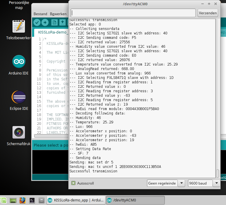

When looking at the KissLoRa demosoftware it’s conform what you can see in de Arduino IDE serial monitor below.
So for the moment I’ll keep the Kiss LoRa in the “original form”.

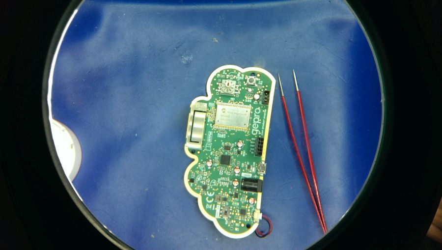

Today I changed C24 to a 10nH inductor. Intial results look fine.![]()

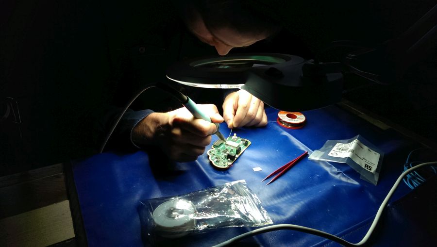

Yesterday at the TTN Apeldoorn meetup we successfully modified the KISS gadget.
