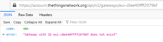

Just want to check - these deletions in V3
per
or did you also delete in V2?
After many failed tries to register in v3, i deleted it from v2 also but i still get the same error
This is a red herring I’m afraid, being on v2 won’t affect v3.
