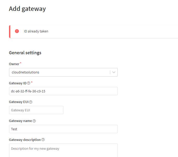

Hello, good night, I have the same problem, I deleted my gateway and now I try to add it again, it tells me ID Already taken. Can you help me?
I have replied already when I said:
The answer you are looking for is already in the topic above - please read it and please use the forum search for this question that has been asked several times.
Good morning Nick, I need to re-register my gateway, but it does not allow me, from what I understand it is left in the TTN database, I give you the ID to see if the people of TTN can delete it or return to assign to my account.
You have said the error message is âID Already takenâ
The ID is not the same as the gateway EUI, the ID is for your reference. It can not be the same as any other gateway ID on TTN, even for other people.

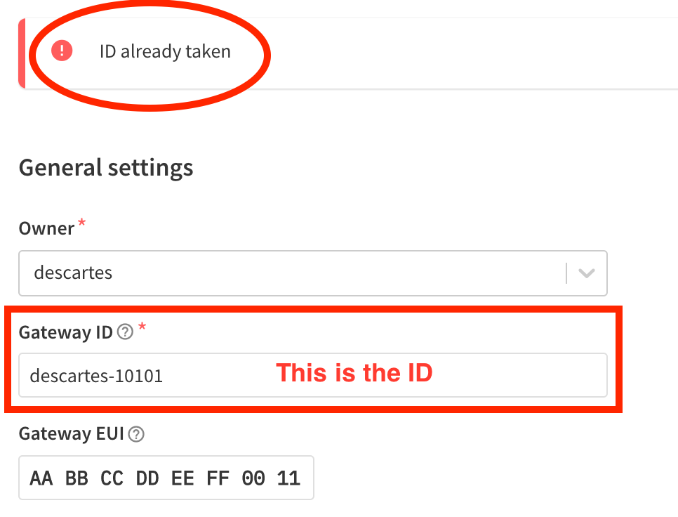

To solve any confusion about which field you are entering the information, I have duplicated the issue and Iâve highlighted the field that I need to change to fix the problem.
The ID can not be the same as any other gateway on TTS CE, you will have to find a different ID to use.
If you are still having the same problem, please can you take a screen shot to show us what you are entering.
Thank you very much, I still have the same problem, the ID that you attach is the ID that the gateway gives me
According to what I understand, that is the ID that I have to enter when I register a new gateway
You put what used to be called the Gateway ID in to the EUI box - like I put AA-BB-CC-DD-EE-FF-00-11 and then give your gateway an ID.
You will have to enter the EUI and you will have to use something different in the gateway ID box.

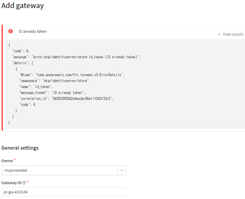

I have to use the ID I deleted previously. The gateway device settings are already set that way, so I canât change the settings. Can I check where pl-gw-4101d4 is already registered? Or canât I just delete it?
imho if you have deleted the gateway ID in the console you can not use it anymore. That is the reason why they warn not to delete the ID. Itâs lost.
What sort of gateway makes use of some arbitrary id? Which is another way of asking, what is this mystery gateway.
It was you that already registered it, so not not much checking needed.
No, read the docs:
https://www.thethingsindustries.com/docs/reference/id-eui-constraints/#deleted-entities
