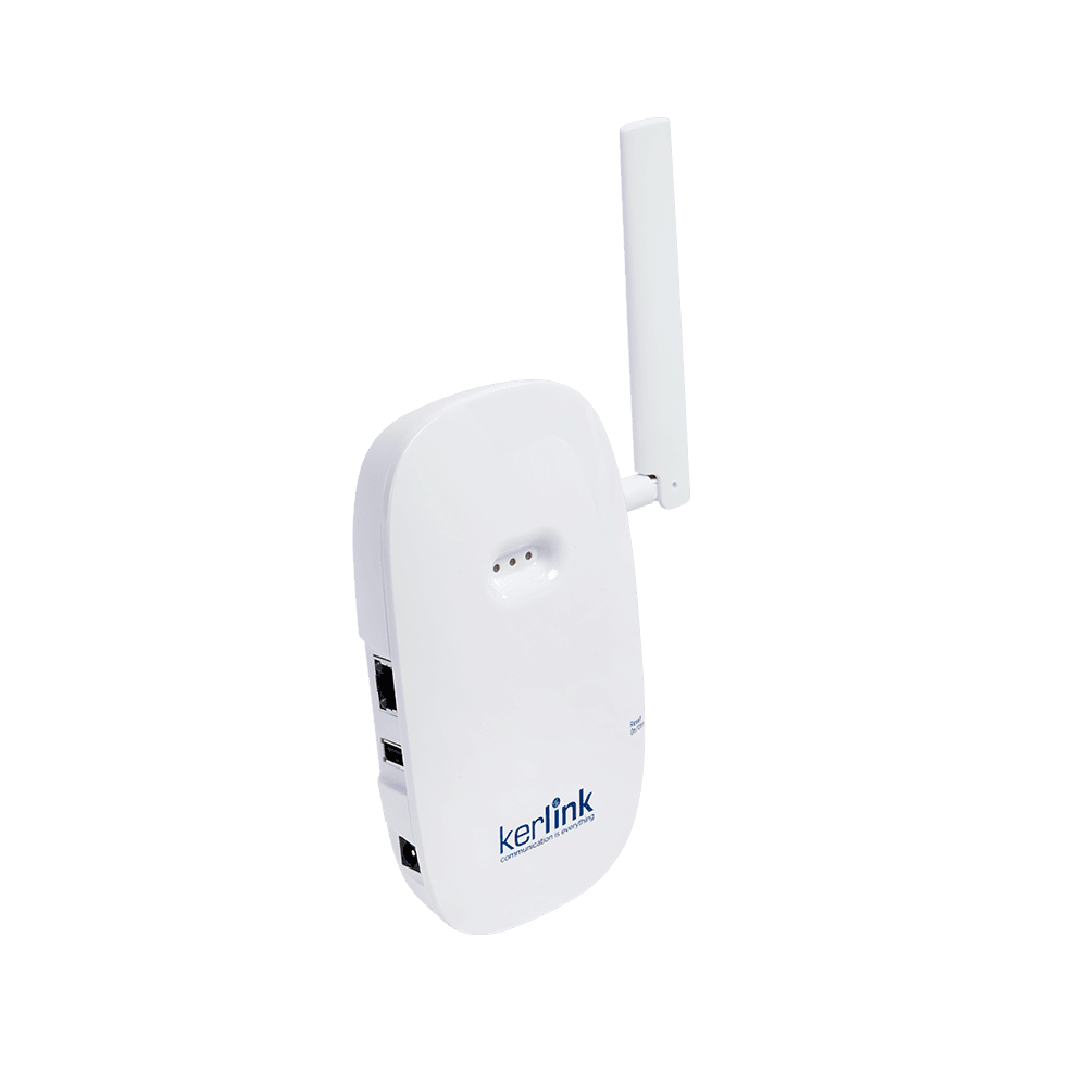

Perhaps the TTIG? So to add to the above:
  1. Ensure you get the names of things correct - there are lots of complications and getting the words right helps enormously with seeking help.

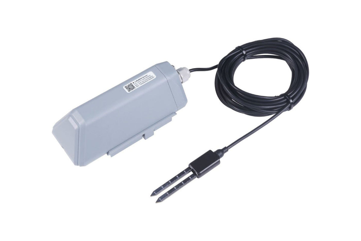

and I’m not sure TTI sell a soil moisture & temperature sensor, so:
  1. Be specific so we can give you more definitive advice.
You run the risk of buying a gateway &/or a sensor that isn’t going to be a good fit for your use case.
thank you Descartes.
I was thinking to get these two as they both appear from TTI. I thought they would work easily together (key for a beginner like me…)
Ah, the TTI shop!
LoRaWAN has a detailed specification to ensure that gateways and devices and infrastructure work together. Occasionally this glitches, but mostly interoperability is expected.
I’ll leave @Jeff-UK to comment on the Kerlink gateway but it looks like a good starter to me.
As for the Seeed Soil Moisture sensor it looks like the probe is resistive so whilst it will get you started I’d not get more than a couple before finding out about capacitive sensing with levels - so it can sense the moisture level at various levels along the length of the probe and won’t corrode over time. The 0 ~ 100% (m³/m³) implies a range from bone dry to actually being in a bucket of water so you will have to calibrate the readings to your own situation as soil type makes a lot of difference.
The standard observation for sensors that detect things on the ground or below is that the actual antenna needs to be on a post at chest/head height. If you put it on the ground its signal will be significantly reduced.

Subject to @Jeff-UK’s observations on the Kerlink, I’d just go with it.

I have not used either of those devices. But. I think 800 meters should work ok.
I have the TTIG ( the things indoor gateway) in my house, but located at the top of my house, indoors. And I have a simple adafruit ā€œfeatherā€ with a temperature sensor 1 km distance, it communicates very well.
