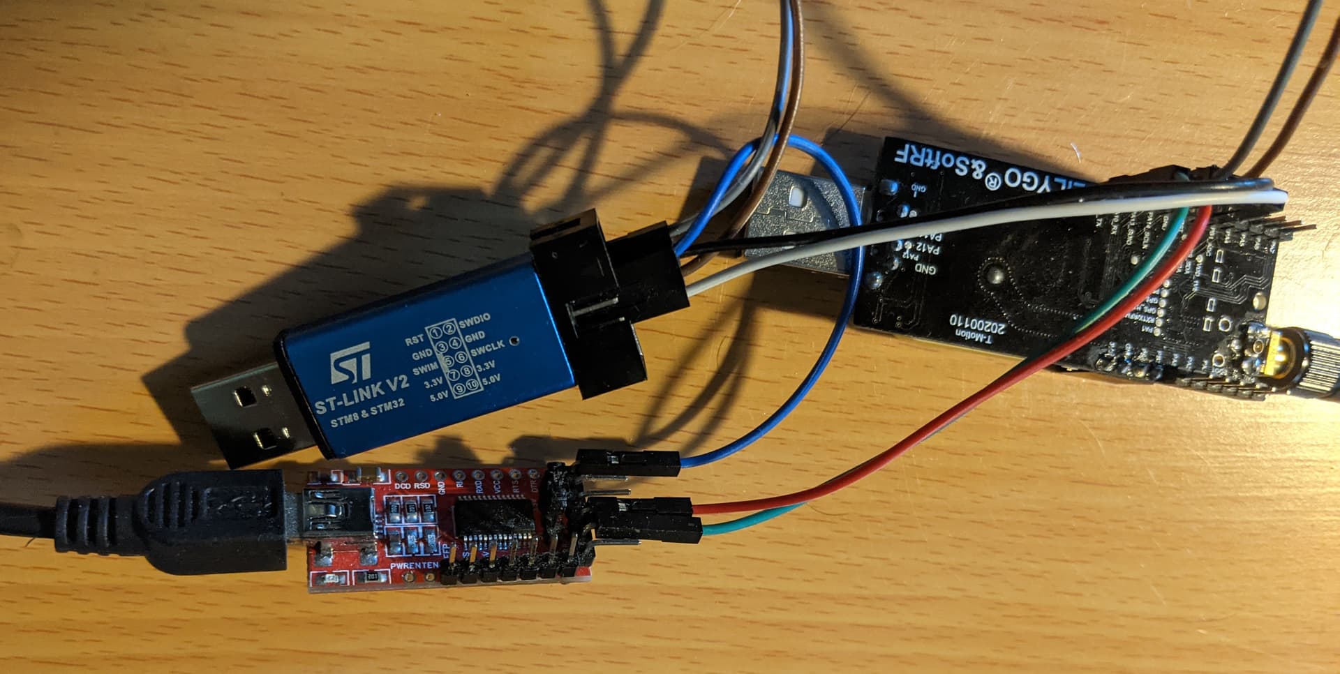

Are you aware of T-Motion USB_Driver_Doc.pdf ?
Will probably help to enable upload over USB and/or Serial over USB for serial monitor.

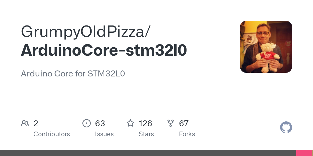

The S76G contains STM32L073 which is supported by @GrumpyOldPizza’s Arduino core. It has LoRaWAN support integrated based on Semtech’s LoRaMAC-node.
It has no BSP for the T-Motion so (some) standard Arduino pin definitions may/will be incorrect (use pin numbers instead).
The Arduino Core for STM32L0 based boards can be found here:

Yeah, I know, ArduinoCore-stm32l0 needs to be updated to LoRaWAN 1.0.4 (aka LoRaMac-node 4.5.2), and all the work that had been done in ArduinoCore-stm32wb has to be backported …
Why not with with stm32duino … loaded question. In general to do LoRaWAN properly (not just a quick hack, quick proof of concept) you need a lot more internal structures than typical Arduino Cores supply. Doing strict timing without proper RTC code and multiple IPLs for ISRs I do find always lacking substantially. LMIC is nice, but you end up with a suboptimial solution, that is a tad convoluted. Just my 2 cents.
I have to admit that ArduinoCore-stm32l0 is kind of tied to TypeABZ from muRata. Turns out that this chip/module is simply the sweet spot. I might add Type1SJ support and perhaps S76G … Does anybody have by chance the full docs for the CXD5603GF GNSS chip used on latter one ?

I was not aware of this doc. I simply use the external ST-Link programmer.

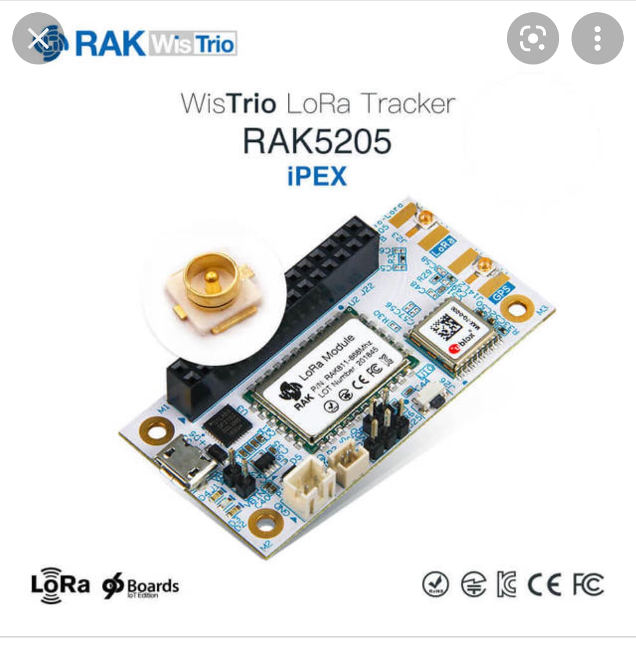

Hello i will like to buy the closest board to RAK Trio i use that for all my project but now its not available to buy so i am looking something similar and lightweight with ipex connectors
