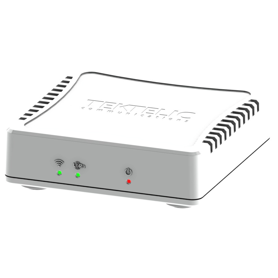

As an example of how prices are declining for fully compliant devices, see this for about 125 Euros

Interesting development. Seems similar to the TTN gateway because of FreeRTOS.
However:
Customers interested in attachment to different Network Servers should get in touch with TEKTELIC support.
It suggests that it will be difficult to configure your self or to TTN

#6
At the bottom of the page here,
right below the description of that gateway and their others, they have the LoRa Alliance Member “Certified System” logo.
Incidentally, I just learned that their shipping for that gateway is somewhat expensive… about $65 (US) to most of the world.

(Russ Nelson) #8
The Pico is not supported for use with TTN. They’ll sell you one, and hand you some documentation and sample files, but don’t expect them to answer any questions.
It might be supported in the future, but isn’t now. I’m sending mine back.

(Russ Nelson) #9
I forgot to mention that the Pico goes silent after about 90 minutes. Stops forwarding packets. Definitely do not buy one until Tektelic advertises and provides TTN support.

(Bradzcave) #17
I just got mine going…
http://noc.thethingsnetwork.org:8085/api/v2/gateways/pico-gw-647fdafffe0052d9
configuration wasn’t easy but I’m happy to help others after going through their tech support. I needed new binary and config files and their docs are not great. if more people are buying them (best price going right now), then I’ll make a config script for this gateway.

(Bradzcave) #20
Very… it’s solid and a good price. Lots of devices using this gateway even though its indoors. But… only config via TFTP, so it’s not just a few clicks to get it to use different networks. Some strangeness about it always using zero for snr and rssi too (support never answered this, probably cut some corners on their low end?)

(Littleoz2) #21
I have just got one of these,
How did you configure it to connect to TTN?

(Bradzcave) #22
Did you get the latest binaries on their portal site?
You need too be very careful the file names for your config files (or else your tftp commands will fail).

(Littleoz2) #23
Portal Site?
I didn’t receive any user guide or documentation with the device, and the user guide I found online all it said about configuring it was to plug power and network into it haha.
(Littleoz2) #24
Where did you get the binaries from?
I found a configuration User Guide on support.tektelic.com/portal, which says about the firmware but can’t find anywhere to download it from
