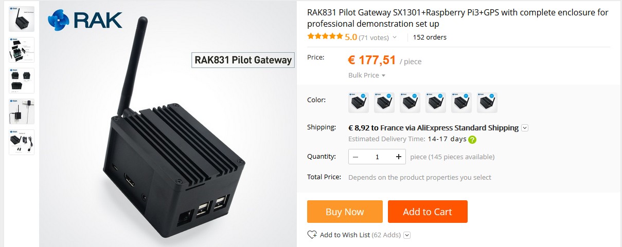

rakgw
Thanks! I did saw it at some point but didn’t figured out what it was exactly. Any comment on performance / setup issues ? Look like the perfect solution :blush:
I saw @Jeff-UK bought a couple… if not a dozen :stuck_out_tongue:
I have 2 myself and they work pretty good.
Also there’s a lot of info and dedicated topics about this gateway.
Damn someone is counting! :wink: 5 registered on TTN (so far) a bunch more due in Jan & Feb :wink: Have also built my own equivalents using RPi 2’s (lower power but no WiFi unless adding a dongle) & 3’s with RAK interface BD as well as using RPi Zero W’s (much lower power but WiFi only unless adding Enet/USB dongle) and @Charles interface bd, but complete package is easier in some ways. As you have already found there is equivalent (minus GPS) from iMST with the Lite GW. Options where built in metal box mean WiFi can be a bit hit and miss but as long as you are close to AP then no real issues. Another low cost GW to consider - the one I set up fastest - time is money on my pro vs hobby side! - with no need to flash images etc is the Laird RG1xx…from unboxing I can get registered on TTN and online in aro 4 mins, aro 5 if having to lookup/set up WiFi (over Enet connection) :slight_smile: Just one cautionary tail wrt main adapter and use in UK that you need to watch for - not a problem in rest of Eu. Iast one a bit beyond your €200 - is that before shipping & taxes? If so Rak shipper may catch you out (esp if choosing the faster e.g. DHL delivery options vs Ali Express std dely) or you may get lucky wrt VAT & brokerage charges…you takes your chances…

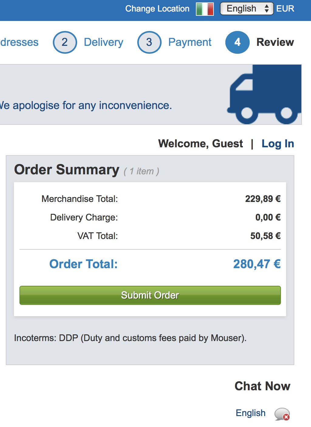

Damn this thing is ugly! I literraly didn’t considered it at first sight :smile: . But if the inside is worth the price and the setup speed I guess I can close my eyes a little. For the records the Laird RG186 (868Mhz version) is 229€ with free shipping from Mouser.

But everything added up, and considering that the Rak may have extra fees, I guess the Laird might be a better option.

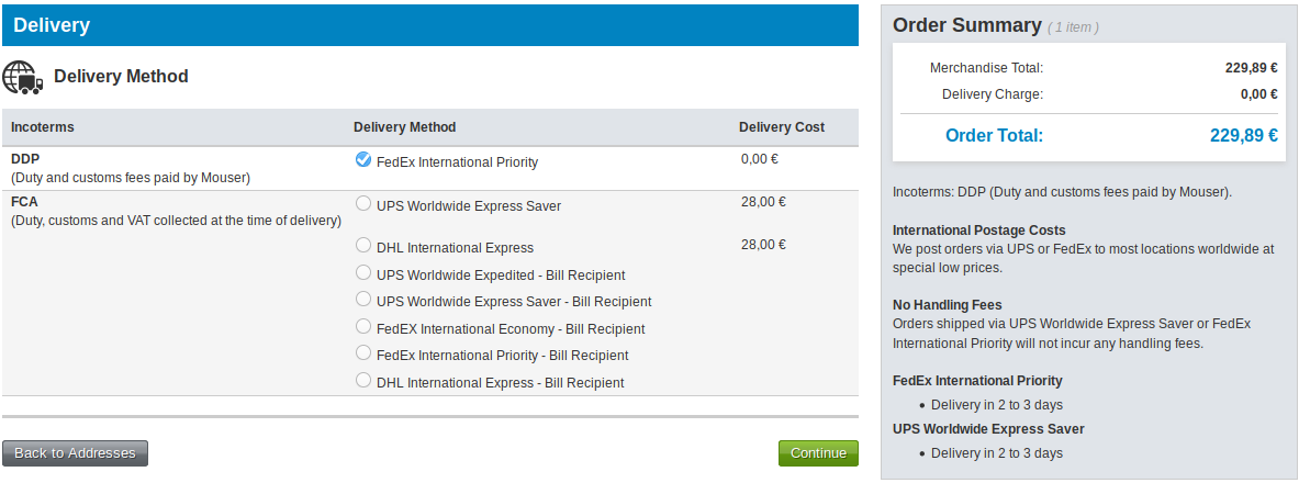

plus VAT :wink:
no-additionnal-vat
That’s what I thought but can’t see where it may be added :man_shrugging:
At the very end:

  • RAK831/Pi3 (AliExpress), black aluminium casing, has GPS but you need to install GPS software. Aluminium housing did not block too much WiFi signal to my surprise. Make sure to order the right frequency! (AliExpress uses the phrase ‘color’ for this). The module was delivered with a minimal antenna…

Thanks @teus for the tips. Finally, I will go for the RAK solution for dev purpose, and will certainly switch to Laird for production. The 100euros difference with the VAT is worth the little configuration needed.
