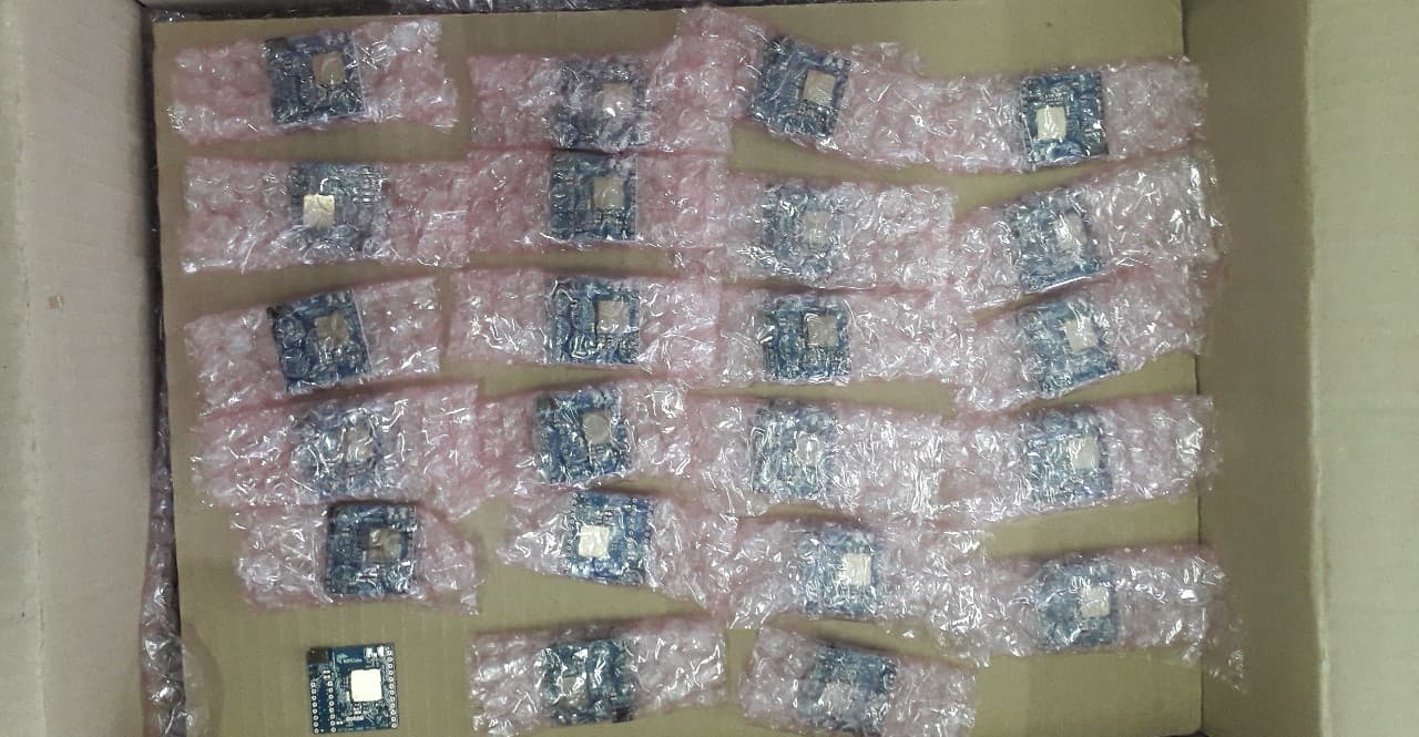

(Radek Vozák) #38
What about our Cube? It has temperature and humidity sensor on board. It is around 40EUR + case IP65 from GAINTA what we use for another sensor. So it will be about 50EUR per 1 pc.
http://chytra-obec.cz/KETCubeDatasheet.pdf
We have about 100pcs ready to ship.
ketcube
