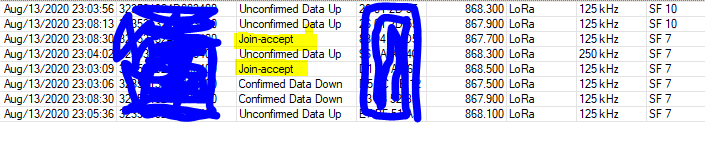

As can be seen there are some LoRa traffic
Are you basing your ā€œnot connectedā€ on the Last Seen message?
If so, did you see this at the top of the forum home page?
If not, do applications or single devices get information through which is the real test.
There’s multiple join accepts e.g. TX in response to RX, in that traffic log so I think your assessment is 100% correct, although the existence of the proprietary line there reminds me this list shows CRC-error packets by default e.g. noise that looks like LoRa. </pet peeve>

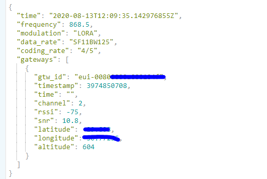

From WinBox I can see my packet on gateway.
But on my application on TTN the data comes from another Gateway close by. So my gateway are definitely not connected the the TTN network.
So the traffic screen shot shows a pile of downlinks which could only come from a network server that you are connected to.
Maybe your device (what is it, where is it?) just didn’t happen to pickup your gateway - maybe something physical has change - obstruction, interference, antenna not quite connected?
With the different options on the Mikrotik, does it show the gateway to server exchanges / traffic?
The screenshot could be less clipped, but those actually look to be receive records, ie, transmissions sent by another gateway which have been received by this one.

These Join-Accept packets were the leading me to believe there are traffic from the TTN to the gateway.
If the left column that’s cropped off now says ā€œTXā€ I’d entirely agree.
But in your previous post from an earlier run, it clearly said ā€œRXā€
(Granted, I can’t rule out the possibility of a web GUI bug mislabeling everything as ā€œRXā€)
But then it’s possible to note that those downlinks don’t seem to be time-correlated to any received uplinks recieved by this gateway which could have triggered them, so I’m still learning towards intercepting the transmissions of another gateway.
Kinda odd that traffic isn’t sorted by timestamp, either. But even looking through that I’m not seeing uplink/downlink pairings, except perhaps with something clipped off.
Yes, after looking now again I think you are correct, this is traffic from the node to the gateway.
Actually it’s downlink traffic from a gateway to a node.
It’s just such transmitted by another gateway than yours, and merely overheard by your gateway.
The Dev Addr confirms that my node are transmitting and been received by the gateway
I don’t see the packet in my application.
From where my node is, it cant see any other gateway, but my gateway do pick up other nodes.
I moved this afternoon my Multiteck gateway to the location of where my Mikrotik is and it does see my node and forwards the packet to the application.
As can bee seen the RSSI is +/- -70, so not a level issue.
