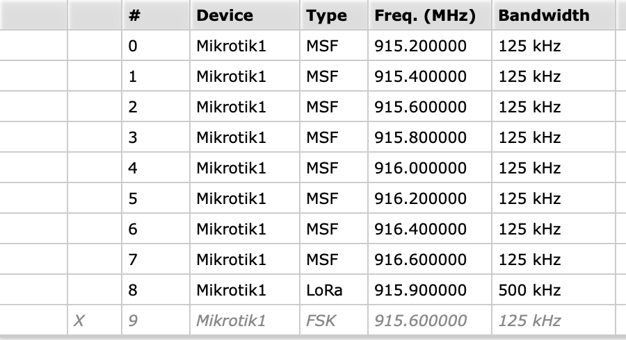

I think so. I just configured mine for AU915 and these are the frequencies it decided to use - they are AU915 but not subband 2 (which TTN uses) which are 916.8 - 918.2
Mikrotik frequencies
I don’t know how to fix this, other than using the custom option but I can’t see how to define the channels when I select that (on the mobile app) - just found a forum post. Needs a bug with Mikrotik I think [raised one]. AS923 seems to match the TTN frequencies…and you can use that in NZ as well (Spark use it)

Hello. Thanks for that. Your list of frequencies in that screenshot matches my list precisely (unsurprisingly). I also had found that forum post discussing the matter. I will contact Mikrotik and suggest they add an entry in the drop-down list for “AU 915 Sub 2” which they could configure with the correct frequencies.
I am using Webfig. When you select LoRa -> Devices -> (Gateway) there is no option to select a custom band, nor do I see where to define it anyway. I can only select from the prepared list: AS 923, AU 915, EU 868, IN 865, KR 920, RU 864, US 915 Sub 1, US 915 Sub 2.

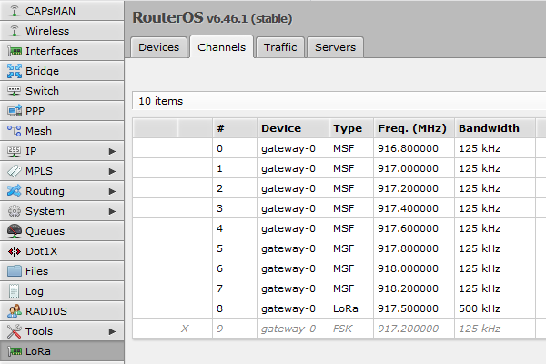

Ok, I used the details in that forum post (https://forum.mikrotik.com/viewtopic.php?f=2&t=155803) with the MikroTik terminal on the gateway to set the channel plan to ‘custom’ and load up the TTN AU915 frequencies.
My channels now look like this:
Is that right?
Before this I edited my Ursalink UC1122 channel plan to match what I think it should be for AU915, and it stopped communicating (which is what I expected as there was no longer any overlap in frequencies).
After this, the Ursalink node appeared again. But, it’s supposed to be sending every minute, and I’m not seeing that. I’m only seeing occasional messages. Will look deeper.
