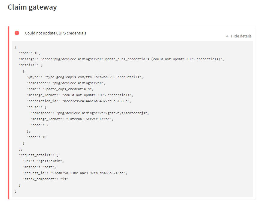

error:pkg/deviceclaimingserver:update_cups_credentials
This indicates that the claiming process failed for a reason that’s not the user’s fault, most likely that an upstream server was not reachable by the claiming service. I need to build in some fault tolerance here so this is for me to look at.
@jpmeijers: Could you PM me your EUI? I’ll take a look.

Thanks a lot @jpmeijers for reporting the issue. My suspicion was right in that the upstream server was flaky. This is quite a rare one (happened only twice the last 2 weeks based on the server logs) and you were the unlucky one. I’ve added some resilience to this part which will be deployed soon.
For now, unfortunately, I don’t have a better solution other than asking you to delete the gateway and retry claiming with a different ID. We have some ideas of improving this to allow claiming with the same ID but that’ll come in a future release.
Please let me know how this goes.

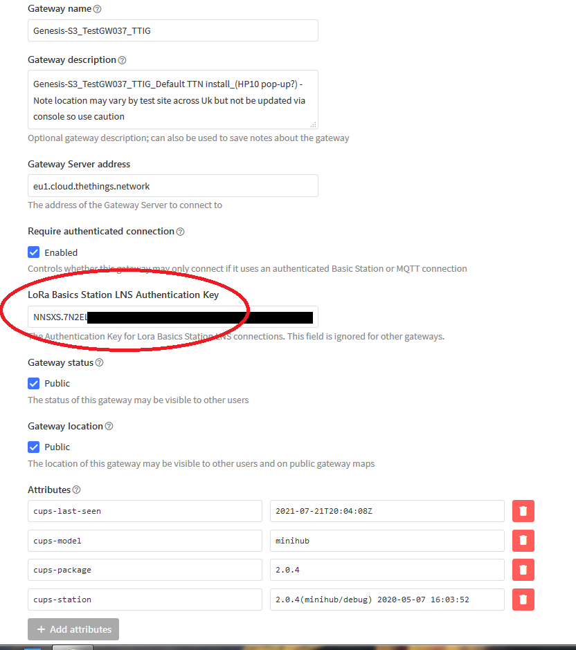

On monday evening I decided to migrate the only other unit I had physical access to - TestGW037 - and so had claim code. As with TestGW036 the claim process went smoothly and again after a quick power cycle I could see it come online and start handling traffic. I remembered that one of the consequences of prior poor eyesight (before the bionic uplift :slight_smile: ) and small printing on the TTIG labels was I often resorted to using a magnifying glass or taking smartphone pic to zoom in and make sure I was not mis-typing EUI or WiFi codes. - a trawl through some 2 years worth of photo archives revealed I had pictures of lables, and hence the Wi-fi codes, for ~60% of deployed TTIG estate - result!
Armed with that I decided to try my 1st remote TTIG migration - based in Congleton, Cheshire (a relocation late '20 from north Manchester), where GW is none critical as site is awaiting sensor deployment next month so a low traffic/no traffic site as yet… If all went wrong I knew the site host had easy access to power-cycle, recover or return if needed. This ‘claim’ also went well with no issues. I decided to not disturb the site host to power cycle (not least as it was late night) but rather settled down to see how long it took to self refresh and complete migration. The image above reflects some 20-22hrs after claim…hence ‘disconnected’ at that time… a subsequent check after approx 25hrs (late Tues night/early Wed morning) showed it had self refreshed and was now online! :slight_smile:

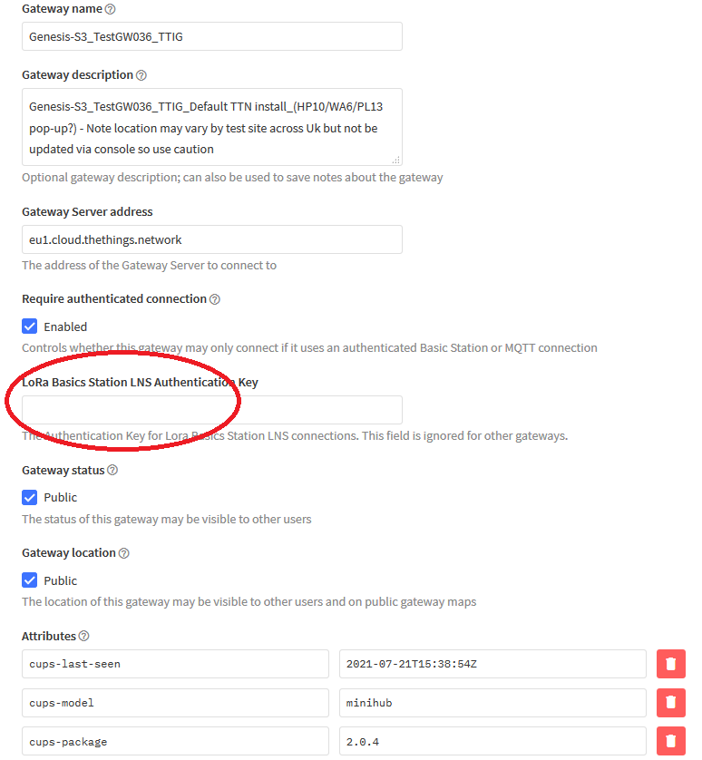

I’ve read the various comments wrt lack of LNS network key populating in the console indicating a failed claim… as can be seen from 1st claim 3 weeks back (link above) for TestGW036 there is no key shown - and yet the GW has performed admirably. TestGW037 shows a LNS key inplace:

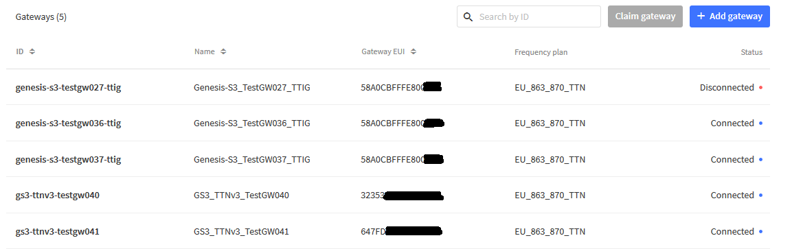

As does the remote TestGW027:
But as stated, for TestGW036 nothing:
Though it is seeing traffic nd is connected just fine! - go figure…
TL:DR Based on experience through this week with now 3 for 3 on the TTIG’s I will be kicking off the migration of the rest of the remote estate for which I have ready access to Wifi keys starting next week (poss tonight for one of the most remote (Hamburg, DE) GW’s, otherwise that will wait till mid late Aug.)

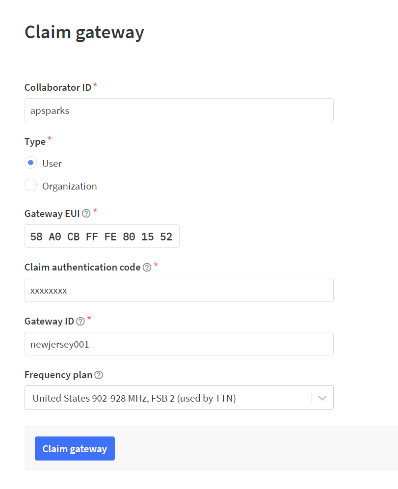

When I try to Claim my V2 TTIG Gateway to migrate to V3 using the instructions above provided by @htdvisser I receive the following error: “gateway with EUI 58A0CBFFFE801552 already exists and is not authorized for claiming”.
  • My account is still active.
  • My V2 Gateway is still active and shows up in my V2 Console as connected.
  • I wrongfully registered my TTIG Gateway as a V3 gateway (Gateway ID: communipaw2) but subsequently deleted it.
  • I don’t show any Gateways in my V3 Gateways Console.
Any assistance would be greatly appreciated.
and let me guess — you tried to claim it into v.3 now and you used “communipaw2” for the gateway-ID again ? Be sure that you are presenting the correct messages with ID or/and EUI to this forum - otherwise its like taking a deep look into our glas-sphere …
I’m not sure what I missed, but I can assure you I’m not trying to claim the gateway in V3 using the same Device-ID (communipaw2). I read enough comments in the Forum stating you cannot reuse a Device ID once its deleted. The error mentions the EUI ID. I tried several new Device-ID’s combined with the EUI ID of the device, but no luck.
Here is how I try to Claim my V2 Gateway in V3 (Claim authentication code masked):
Below is the Exact Error Message:

Can you confirm where/which sales channel you bought the TTIG through?
It looks like this particular gateway was indeed previously registered as communipaw2, but the collaborator (I guess you) revoked their (your) own rights, so it was orphaned. I just deleted the gateway, and you should be able to claim it now.

I really appreciate your help @htdvisser. I was able to claim my gateway successfully in V3.
I am not sure how I revoked my own rights in V3, otherwise I would warn others NOT to do the same. I still “owned” the gateway in V2 and retained all my rights there. FYI…I purchased the TTIG gateway new in 2019.
