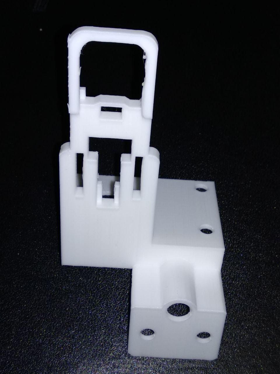

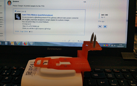

Phone Charger 3d printed adapter for the TTIG

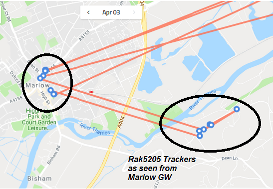

and what antenna/node/tracker/power did you use ?
Mix of usual standby’s - Semtech/iMST LoRaMotes (Folded F PCB ant’s) and RAK5205 Trackers (PCB Patch ant’s or small RAK rubber ducks
) or RAK811 break boards. Signal range was topology and clutter limited rather than power/SF. On 2nd day I also set up a SMTC LoRa IOTSTK as reference platform logging locally vs through TTN or Cayenne from 2 of the LoRaMotes so I has some comparison of coverage between TTIG & my ‘reference’ platform. - Results look very similar on 1st pass as not pushing range this close in…still analysing

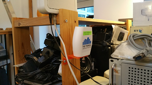

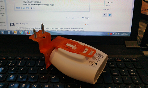

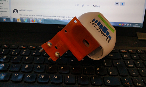

Printed one this afternoon…another just finished and 3 more in process
EU mains pin/adapter holes no use here in UK but as you can see have alternate plans…just needed a holder as obviously unit cant stand up when powered given bottom cable entry;-)
e.g.: wall or wooden frame mounting etc.
BTW given relatively poor internal antenna would recommend NOT winding excess cable around unit when in operation as may further mask/perturb signal but rather let it hang free

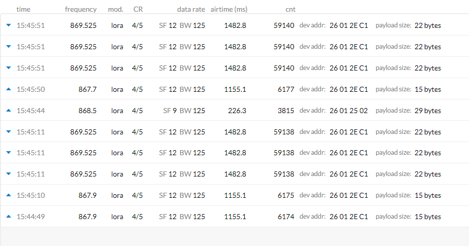

some strange tripletts, shown by TTIG
