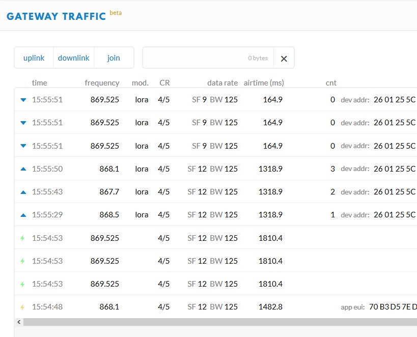

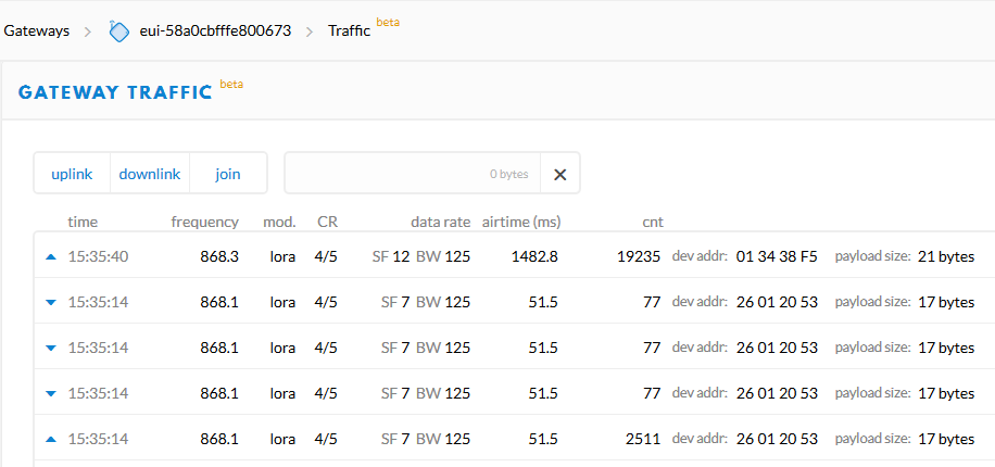

Brilliant, exact same here!!! I thought I was going mad - RAK831 is not doing this and yet the TTIG sat next to it is going crazy on triplet downlinks/join confirms.
yep⌠Iâve seen that before too, can even replicate :
Hummm, went to have a closer look at mine soak testing and 1 is showng same behaviour
Looking closely this appears to be a repeating down link for a Laird RS1xx sensor that asks for occasional confirmed packets as part of keep alive/watchdog process.
Looking at @BoRRoZ and @bluesensing1 screen grabs like its the GW repeating downlink (ack or join accept?) in each case!? Is that expected behaviour I wonderâŚ

I donât understand in which way the gateway could be causing the console to show multiple downlinks. Each downlink shown in the console should be issued by the back-end, not generated by the gateway.
Only thing I can think of is the Semtech to Basic Station translation layer somehow NACKing the downlinks and the back-end repeating them.

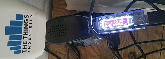

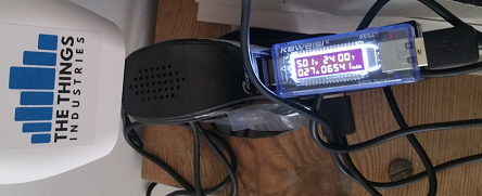

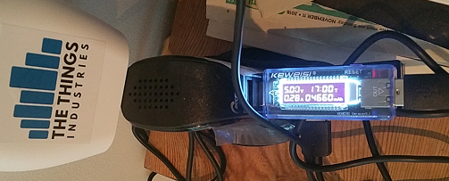

I forgot to post update on power consumption:
4660mAh after 17hrs
5466mAh after 20hrsâŚ
And after a full 24HrsâŚ6541mAh
Thatâs around 55% of an original SMTC LoRa IoT STK (RPi2B based), 75-80% of a Laird RG186, 73-77% of a RAK831/RPi0W/Hallard interface board, and ~40% of a RAK Pilot (RAK831/RPi3B+) under similar test conditions.

well, go figure:
today i brought a different gateway (RAK2245) to where the triple-downlink-generating (ADR) node is sending. after starting it up it received the uplinks fine, no downlinks there - TTIG still returning triplets.
climbing up to the attic i found the TTIG (as others mentioned) is flashing itâs LED. checking itâs power supply i found it was a 1A, which i assumed might be a bit on the weak side, so i thought iâd try hooking it up to the raspi, which itself is powered with 2A only - but who knows ⌠lo and behold - for several minutes the TTIG returned single downlinks only.
coming home now, opening the console for the two gateways unfortunately weâre back at triple downlinks from the TTIG. whereas the other gateway seems to sometimes try to take over the ADR-control and sends a downlink by itself instead - a single one i may underscore.
so yes. to me these triple-downlinks look like an issue of the TTIG (though being all but logical, as - as @cslorabox mentioned in another place - shouldnât be able to âinventâ downlinks by itself ⌠but quite obvioulsy, something one could interpret like this is happening.

The TTIG does not put downlink information in the console, the back-end does. So I think the TTIG or the Semtech to Basic Station gateway software between the back-end and the TTIG is triggering strange back-end behavior.
@johan @htdvisser any idea what is happening? Is logging an issue on github for the V2 stack of any use?
The TTIG with the Basic Station PF has itâs own scheduler which might be causing some issue here. Will investigate.

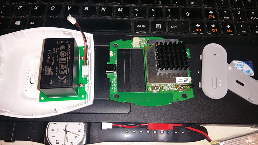

I just add a link to this pdf file with the fotoâs off the modify off the TTIG gateway use it with a external antenne.
Just use a standaard SMA pigtail
and now just use a standaard 868 mhz rubber duck antenne.

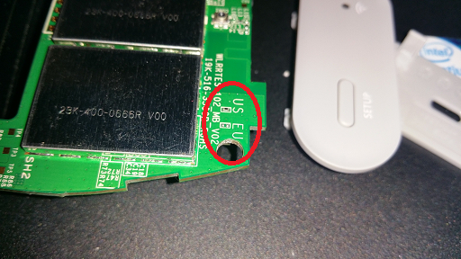

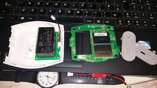

After leaving my âconnectedâ but none functioning unit on line for a long period with many resets and checking automatic updates in console and even leaving beta option ticked just in case I finally gave up today and figured as I was thinking of modding for external ant using sma pigtail as others above I figured start with the failed unitâŚwas also thinking to check for loose connectors or re-seating the radio bd just in case. Voided warranty:
All seemed sound from mechanical pov so was about to power up the open bd to check for operation when I noticed one small detail!
Per other peoples images it looks like the device is mis-shipped or mis-labled or mis-manufactured with the zero ohm resistor in the US position vs EU!
Guess I will have to try and relocate component over the weekend to see if it fixes problem (at same time as adding the external Ant
So 5 x 868Mhz ordered, 4 delivered and functioning with one that looks like a 915MhzâŚ
Remove the two gray end pieces with a small screwdriver.
Below these two end pieces you will find two Phillips screws, unscrew them.
Split the white parts of each other with a small flat head screwdriver. There are a few slots next to each other that easily come loose.
Make room for the SMA connector in both parts on the USB connector side
Drill a hole in one of the gray end pieces (USB side, there is already a marking on the back)
Screw the SMA connector on the gray plate, perhaps use an extra ring for sturdiness.
If you have the right pigtail you can simply swap the plugs of the antenna, and push the existing plug away between the print and housing.
Follow the photos It is easy
Gently pry of the grey top and bottom covers - you can see in pictures just posted there are 4 small lugs holding each in place - doesnât take much to force/twist to remove You will then see 2 x T5 (very fine star) screws holding assy together - despite using correct screwdriver I managed to strip one of mine!
remove, then with a small amount of force, starting at on end of side split you can leverage the halves apart - again 4 lugs hold together which can be forced apart with a little pressure
