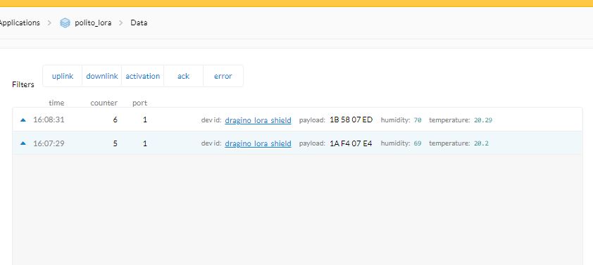

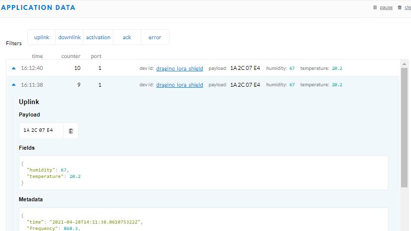

in the application in data part I can see the data in uplink
but in gateway part there is no any traffic tap
I was working with my ttn about half an hour ago and everything was fine but now I can no see even my gateway is connected or no?

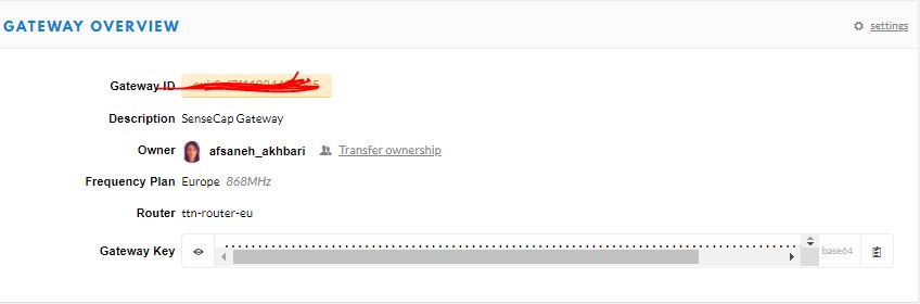

Do you see node traffic appearing in you applications? If so GW is stll routing just fine and it is the known issue with info. BTW hiding GW EUI limits our ability to help - eg by checking status in the NOC. If your GW is publically declared then such details usually available in the clear and hiding therefore doesnt achieve much

Yes I can see only uplink in application-data part
I have uploaded my gateway status which was working before which device Id is clear

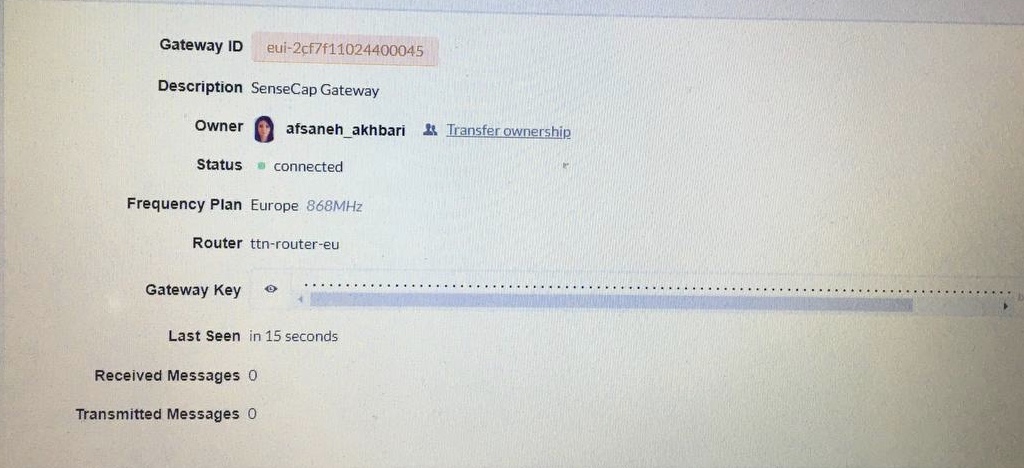

This shows it was live just 15 seconds before your screen grab - typically they update every 30secs, some perhaps every minute (a TTIG may be longer) or when they receive a packet - so contrary to what you say it does not appear to have disappeared from TTN - can you clarify or explain what you mean on this. If you look at the traffic page from same view are you seeing any messages passing through? (Note this only captures LIVE traffic - historic data wont show and list will apear blank if you only open after a message has passed through…)

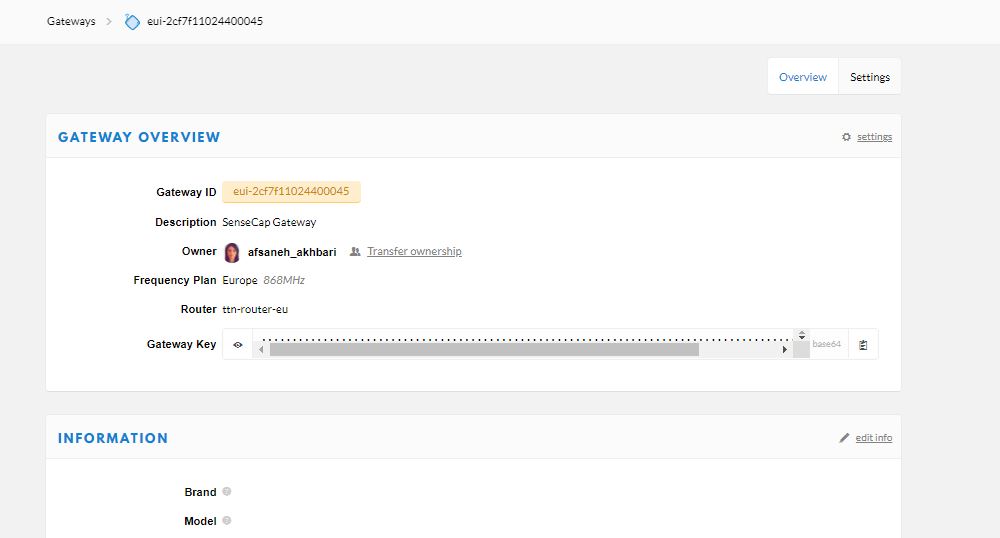

as you can see i do not have any traffic tab to see data but i can see uplink data in application part.
these pictures have been taken 1 sec ago

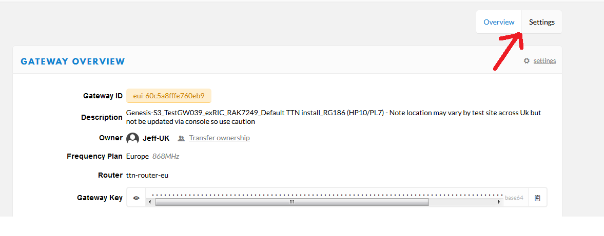

Ah see what you mean now - have just opened one of my console pages (actually checked 3 or 4) and see same problem… Looks like will have to flag something on slack OPS channel as not sure why the Traffic tab has suddenly disappeared : Paging Jac @kersing and Nick @descartes - are you guys seeing same problem - no Traffic tab in Console GW view?

EDIT: It’s a web app (yeah, it’s an app), so one refresh later and the traffic tab disappears!
EXTRA: It’s not in the HTML either!
@Jeff-UK Yep, confirmed. Missing in action… Along with last seen and message counters on the information page.

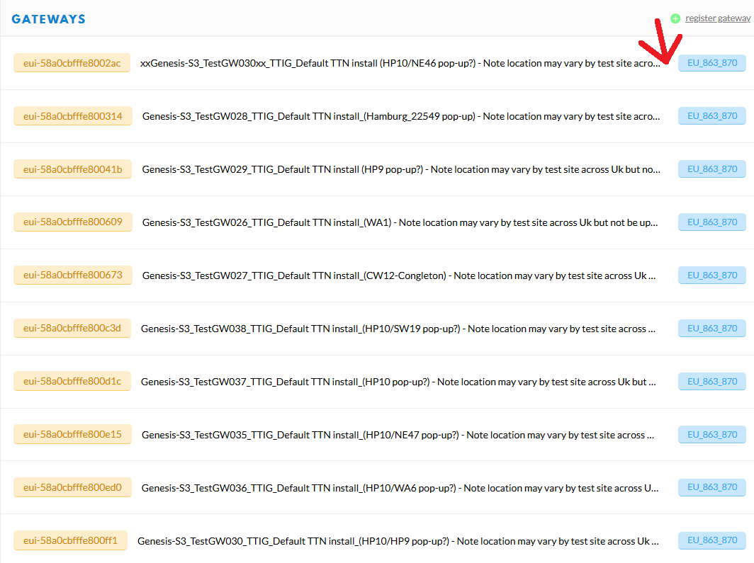

E.g. besides the change to individual GW status and traffic (and the value that has for helping debug device issues or gw problems it seems this has also impacted the GW overview page
Listing all GW’s is closest thing to a simple individual/user/group NOC and as you can see connected/notconnected status no longer listed.:
With, in my personal vs community or clients case, several dozen GW’s to monitor and manage a quick scroll up or down would tell me if any had gone offline or not - if lots suddenly offline then I could guess it was the NOC problem and then if concerned dive in to indivdual devices/applications to see if traffic still coming through and all ok with routing or if indeed the GW was down and needing attention. It is not practical/too time consuming to step through ALL of them in the abscence of an overview.
