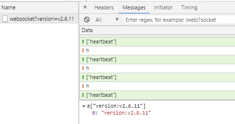

Curiously the V2 websocket is still showing heartbeat messages.
But I see no traffic :frowning:

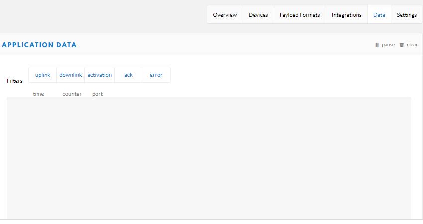

hi
in gateway side everything is working fine but i can not see my packets in application-data part.
empty
is this a problem of mine or a general problem?
I see application traffic for my devices so suspect it’s your end… is node joined and transmitting ok, do you see activity in your gw log and traffic page etc.
it is working now,
i was not able to see packets on application part for about one hour but now it is ok,
thank you.

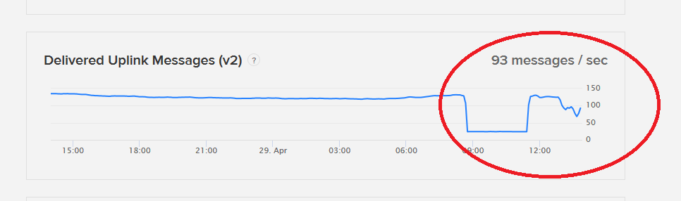

Looking deeper it depends on when you were checking - there was significant outage of V2 earlier which was recovered but then seemed to go into decline again
yes i had difficulty exactly in the mentioned period
Things are up and down and up and down and up and down at present.
Rinse, repeat.
