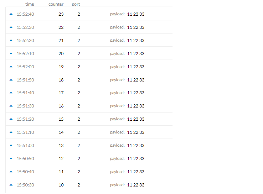

(Neliz) #2
OK what the hell is this…
I am struggeling 4 hours with this, at one point I am like, ok you know what… I just make a post on the forum… and 5 minutes later 23 payload packages comes in…
payload
like how is this possible…

(Neliz) #5
So thats the weird thing… everytime my node sends a package in ABP, the package is nicely displayed in the console.
However with OTAA, for example, sometimes for 1 hour or so no packages comes in, and then all of a sudden 20 packages. To sum it up, it show payload randomly in the console, however the frame count is accurate.
So I see in the UART that the node sends 10x a message, and the 11th message is displayed in the TTN console with a counter 11.
I use the Things gateway.
