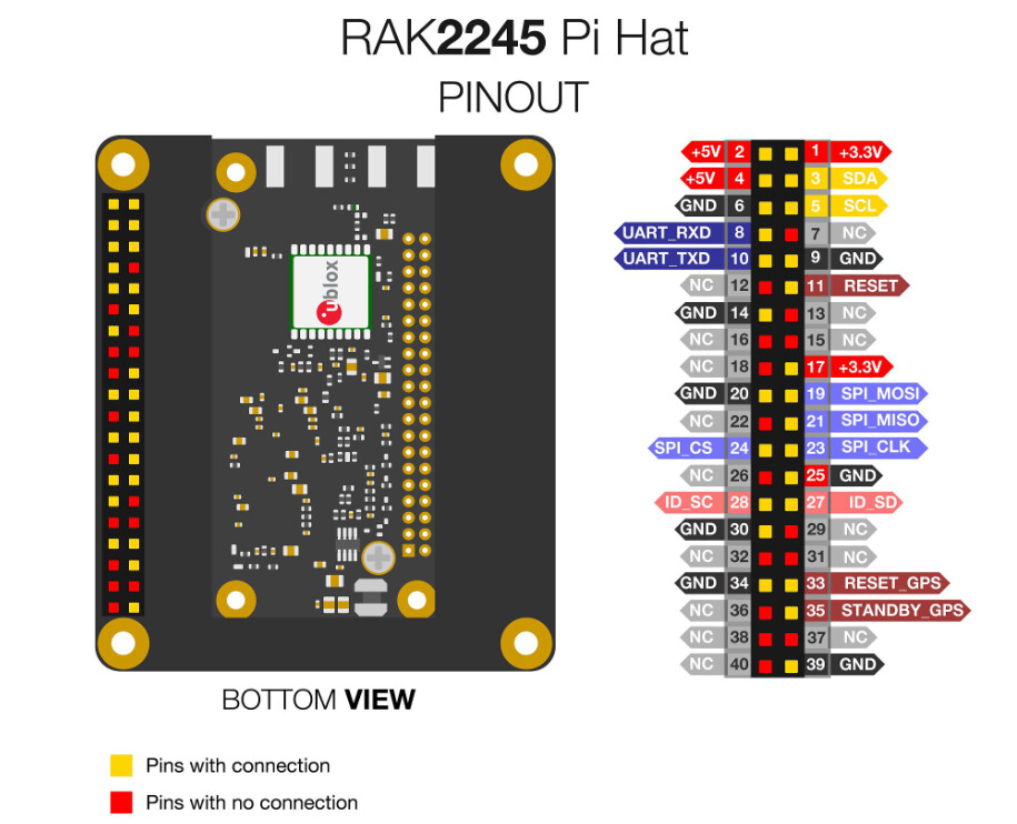

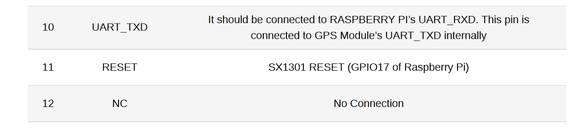

At this point GPS is a ‘dont care’ from TTN operation perspective, and the key task of starting the concentrator, so what you want is GPIO17 = Pi HAT 40 pin connector pin 11 for the concentrator reset (SX130x reset) as shown
