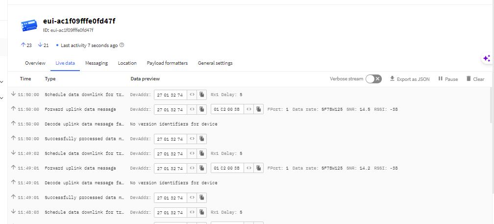

I have a RAK2560 WisNode Sensor Hub as well as a RAK gateway.

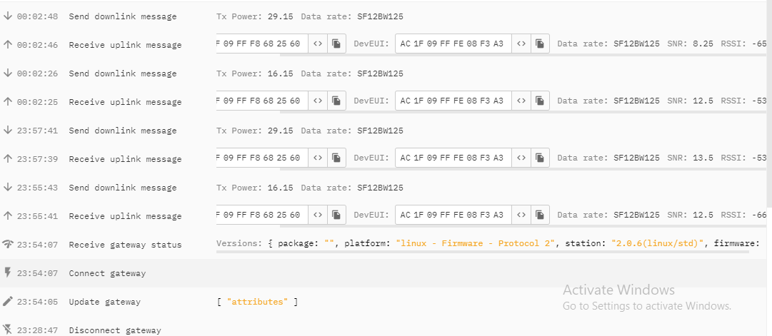

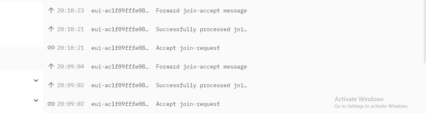

I successfully added them to TTN. The sensor first sent data for a few minutes before stopping until I selected join network from WisToolBox, after which it kept transmitting data for a few minutes before stopping until I selected join network.
Recently, even when I select Join Network, no data is sent. The sensor just sends the join request.
This is a picture of the application live data.
