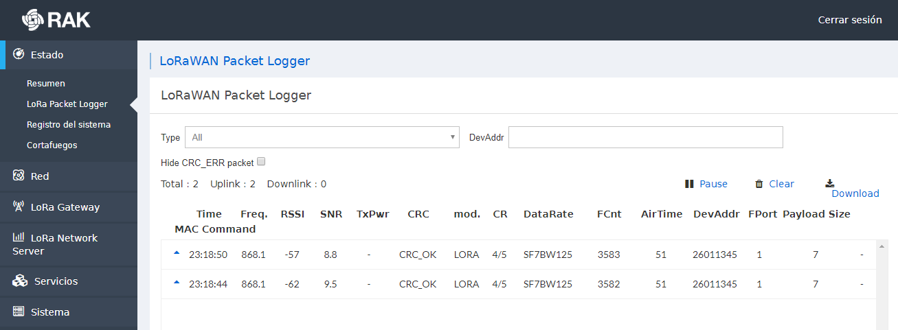

The packets appear in the RAK7258 logger correctly.

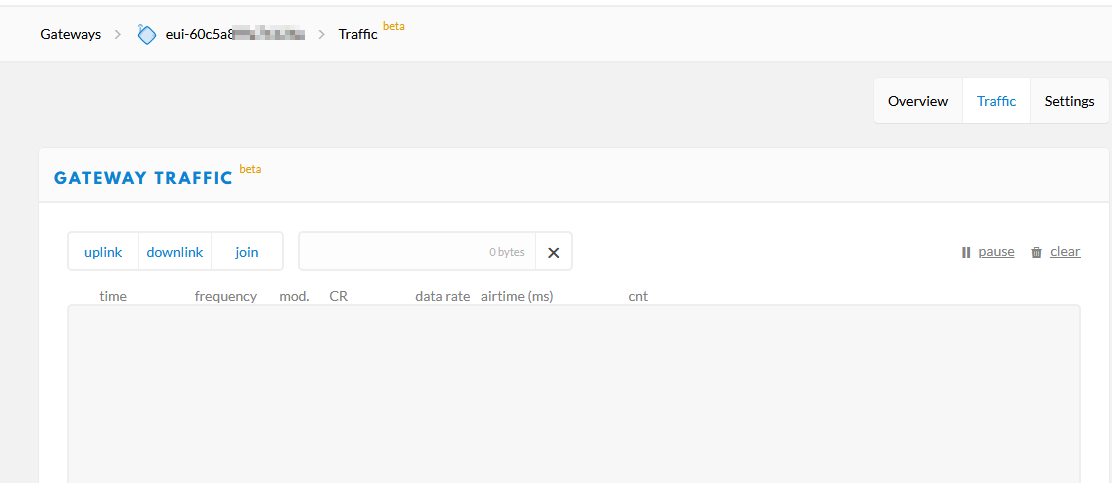

But they don’t appear in the TTN console

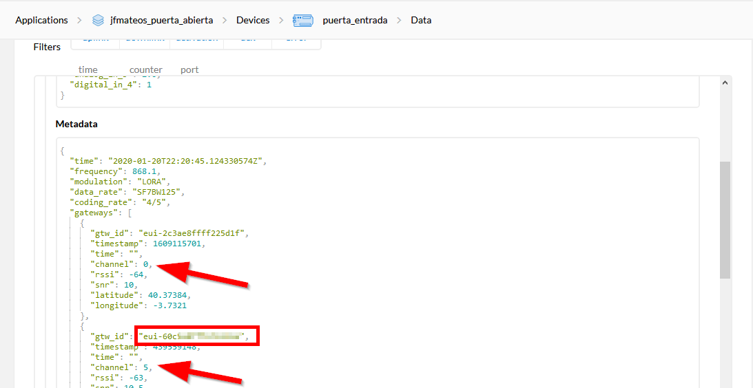

Nevertheless, I can see in the application console that the packets have also been received by the RAK7258
The only odd thing is that the channel is different
