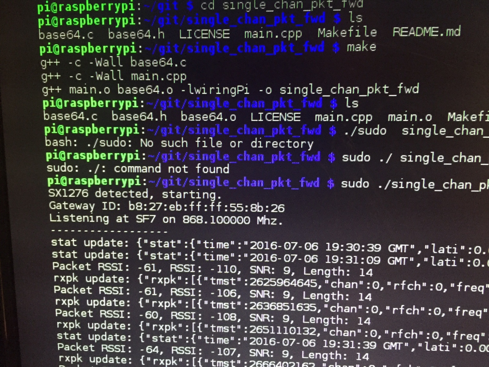

I’ve a problem with my gateway:
I can see that the Gateway receives packages at the terminal of the RPI, but I can’t see the messages at the TTN dashboard.

First thing to check: Is the gateway connected to staging? Not the ‘old’ environment? (Check the IP addresses you are sending to, for Europe it should be 40.114.249.243)
More information in this thread.
@kersing
Thank you very much! I used the wrong IP, now everything is working as expected!
Got mine working as well!

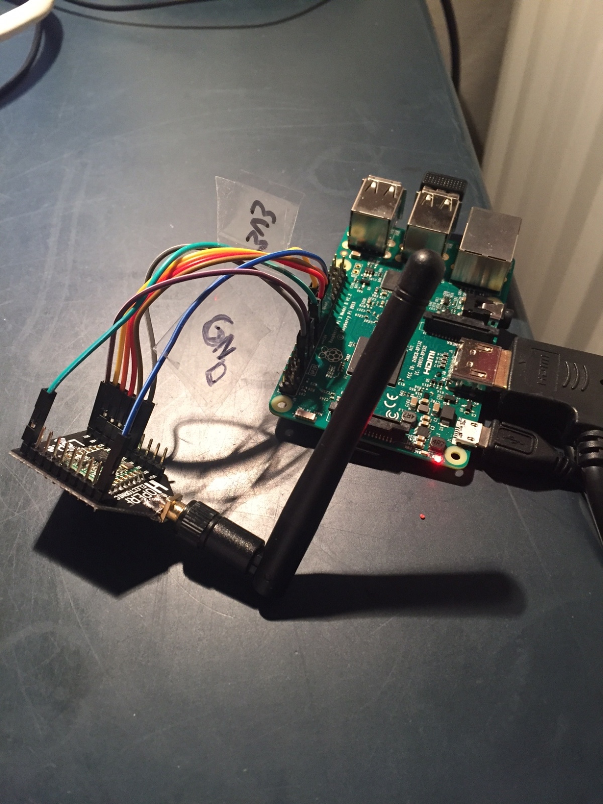

Gateway based on RPI and SX1272

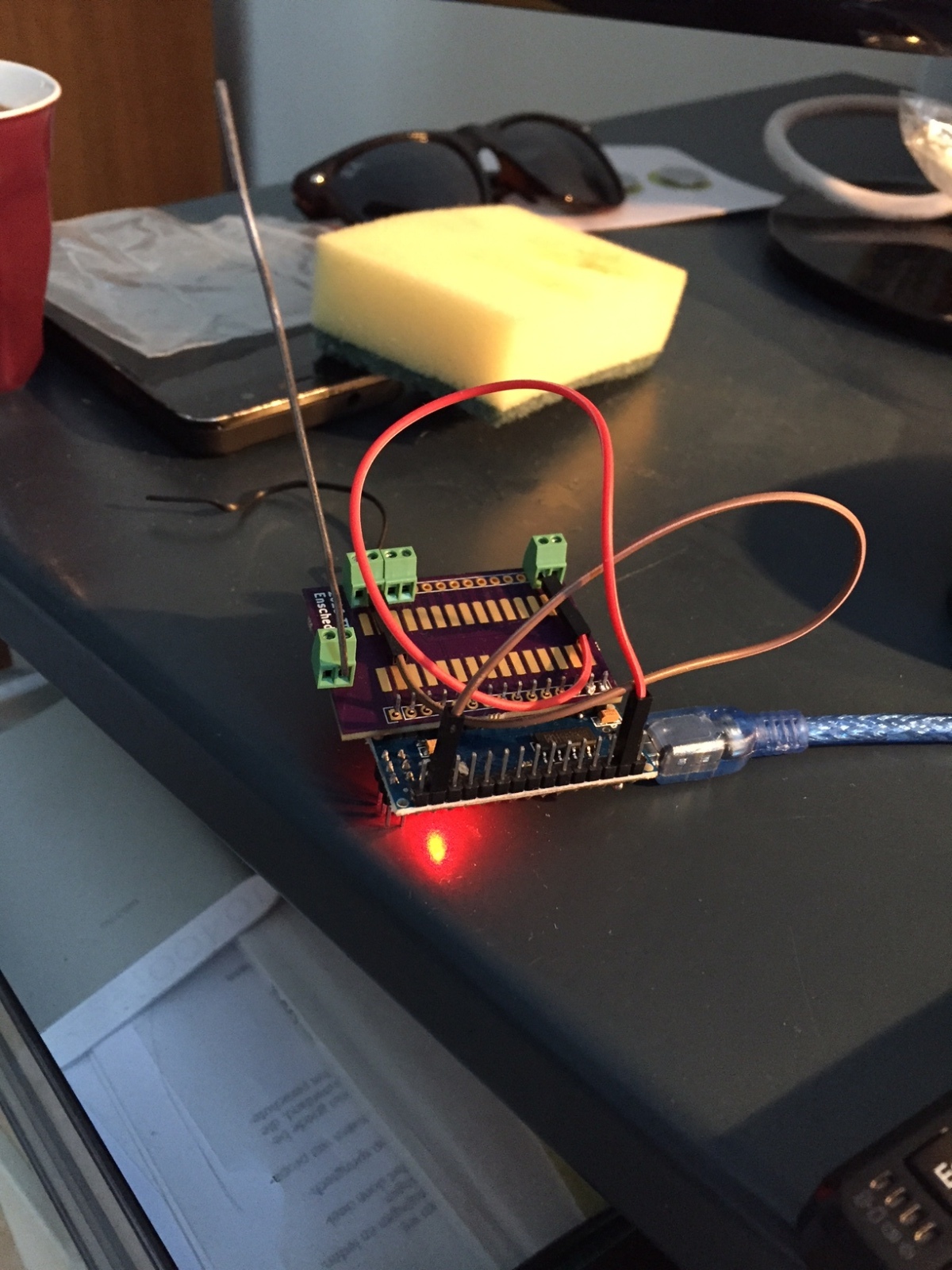

Node based on Arduino nano and RN2483:
So what ranges do you get?
I get 200 to 250 meters from the attic with a dead spot where there are too many houses (walls) in between.
