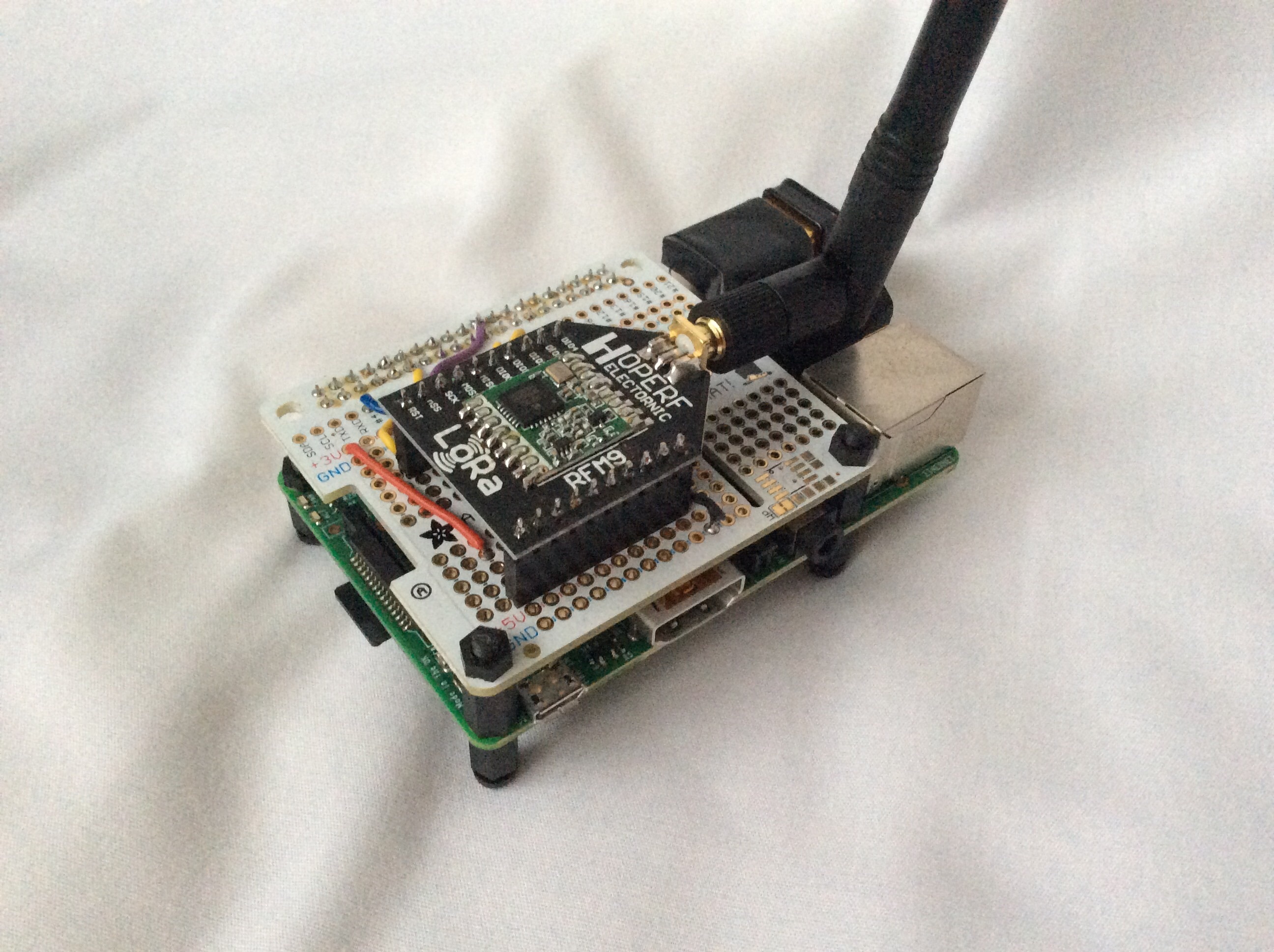

I have released a first version of a single channel gateway. This is a proof-of-concept implementation, that can be used for development and node testing. It is not a replacement for a real multi channel/multi SF gateway! It supports some LoRaWAN features, but due to its static nature (single channel) it is not fully LoRaWAN compatible (and will never be).
By default it works with the TTN backend, for testing and development.
It runs on a Raspberry Pi (any model), using an SX1272 (for example the HopeRF RFM92W) over the SPI bus.
@Batilan already kindly offered to tidy and structure the code, add cli options, etc.
The code and instructions you can found here:
Example hardware:

@Thomas : That’s great work! Thanks! Exactly what I need for further development of my nodes. :clap:
sad: no support for sx1276 (the only on I’ve on my table)
b.t.w. where did you find the breakout board for the sx1272?
Nice! Added to the wiki.
