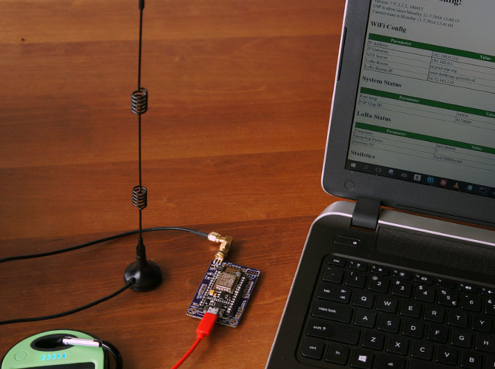

I created a bug in the transition from floating point NodeMCU firmware to the integer only version. Fixed now on github. I receive messages on my node again.
My LUA Single Channel Gateway works quite reliable now.

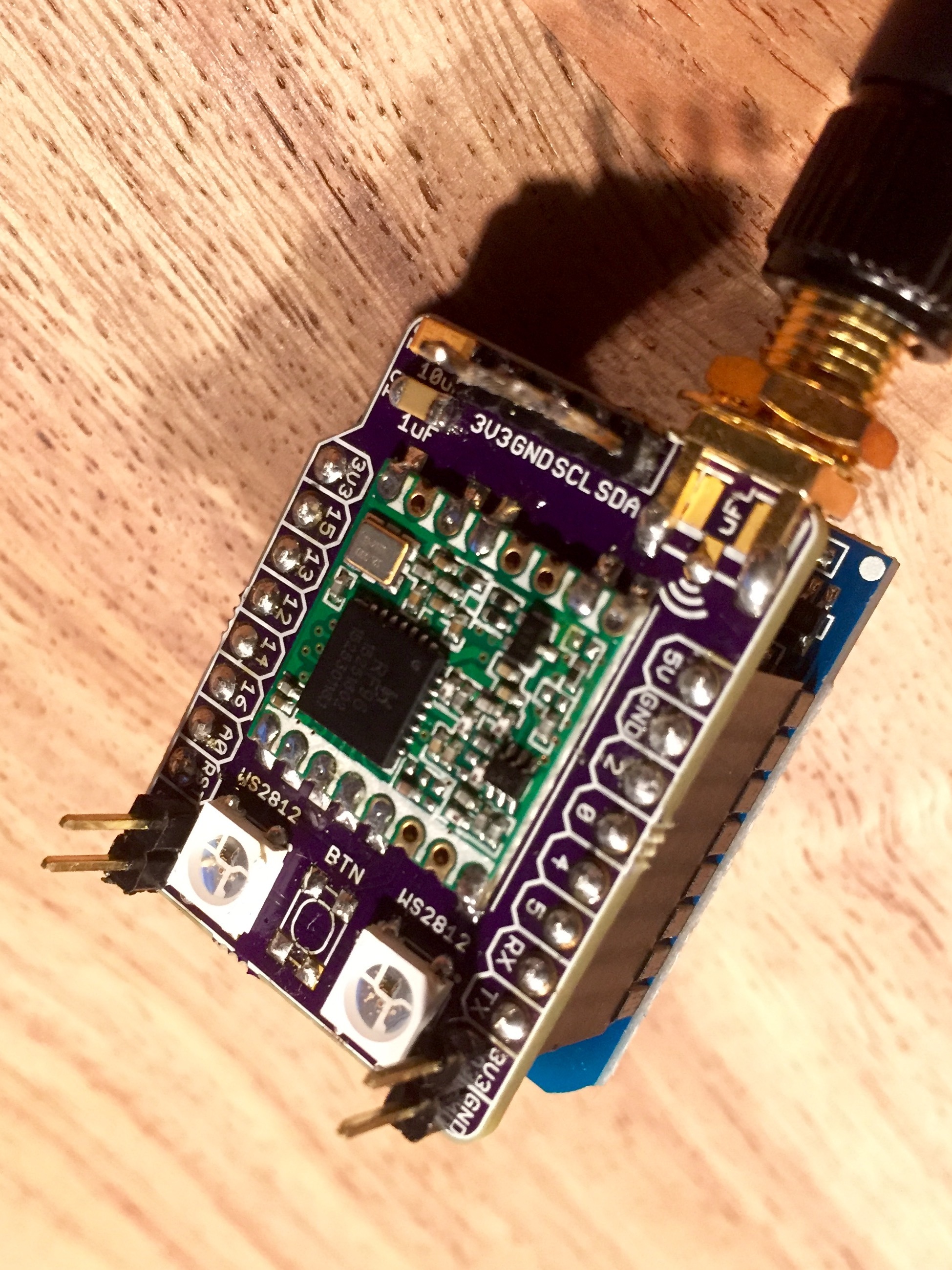

His little brother …
@PH3V
hey nice picture,

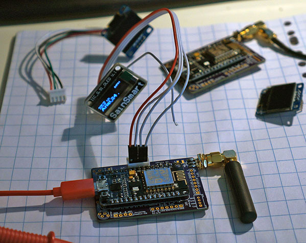

I’ve got some firmware with OLED support (on my RF69 gateway) that funny scroll between informative screen using this awesome library
If you are in a hurry check the OLED library demo here it very simple to implement and we added SH1106 support for 1.3" Oled
I will implement it first on my Wemos RN2483 node so you’ll have example but I’m sorry I have no release date for this (I’m working on 4 different firmware at the same time, quite complicated)
