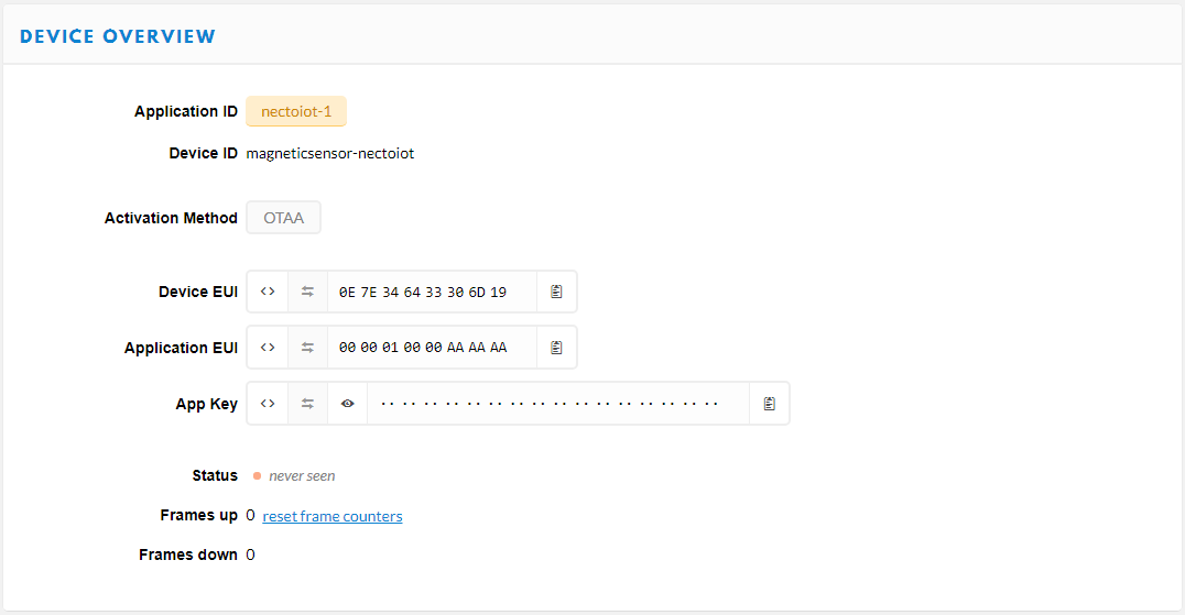

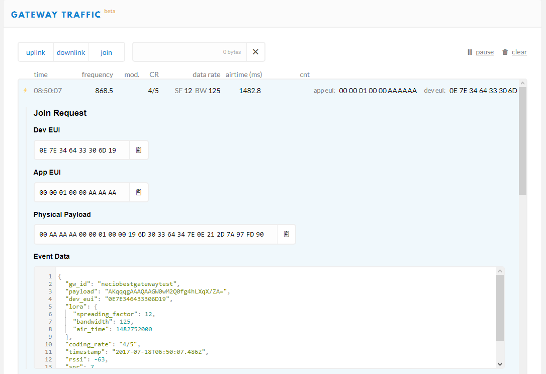

Hi again,
I’m sorry but I am really unable to find out the problem.
Here two screen shots with my devices settings and the message that my gateway received.
If someone has any idea… I’m stuck on this since yesterday…
When APP and Devuce EUI match and the back-end does not recognize the OTAA request the App Key might be the issue. Did you program your device with the App Key in the correct format?
