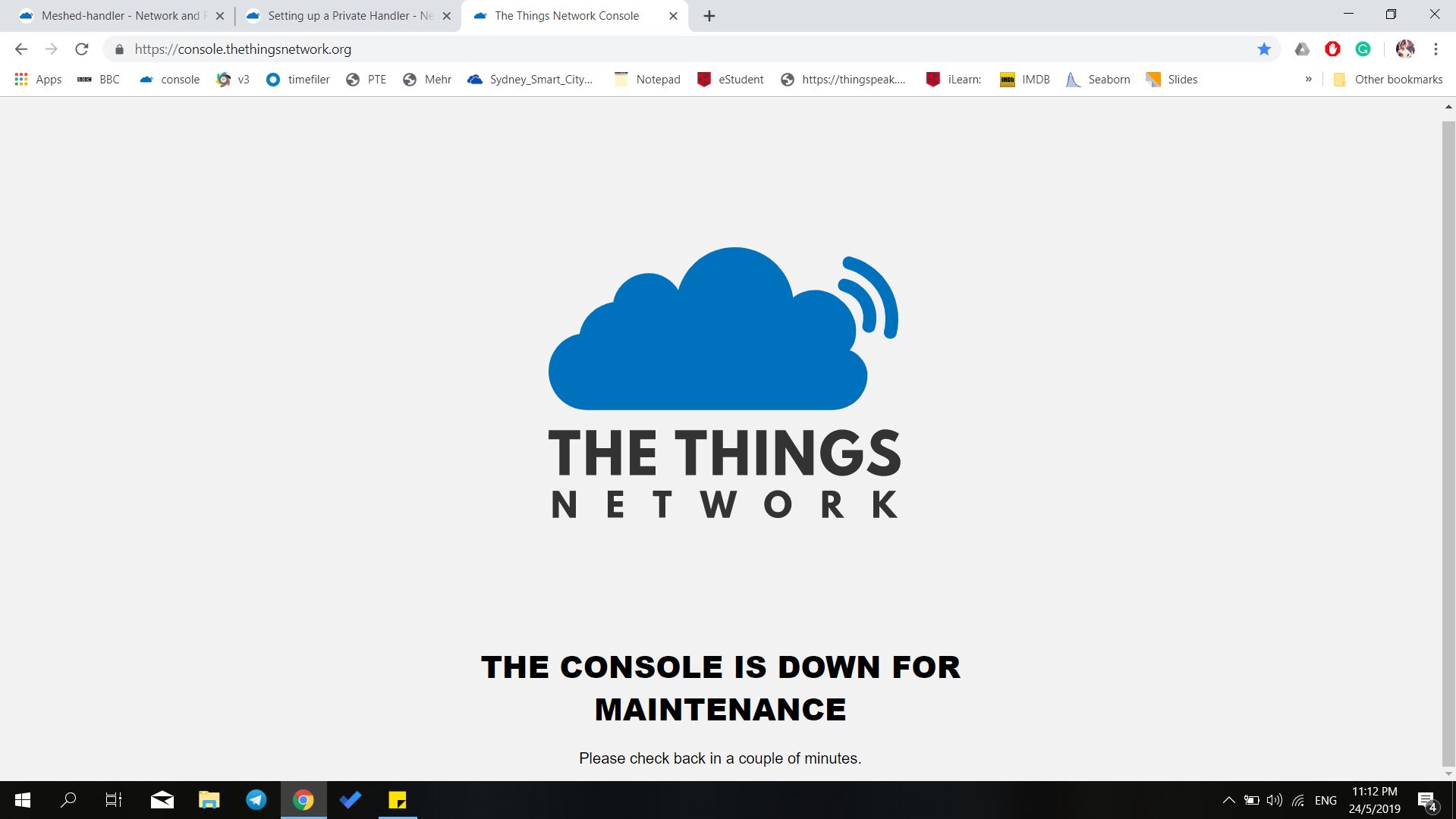

I have been using an application on TTN for the past year without any issues. But two days ago, All my 72 nodes stopped transmitting data at almost the same time (5/23/2019 22:47:45). I have tried to register new devices on the same application but they don’t work.
However, when I register the same device in a different application, they start working.
The only difference between the applications is the handler.
The working application is using ttn-handler-asia-se, and the not working application is using ttn-handler-eu. Would this be the cause?
The image below shows an overview of the not working application.
It’s worth mentioning, that I made a new application using ttn-handler-eu. It is not working either.

Hi Sam. I know there are issue with cross-region routing. Since the gateways you are connecting to are in the Australian region and your application is in the European region, I suspect you are seeing the effects of this issue.
It’s not possible to change an application’s hander AFAIK. I once had a script to migrate devices between applications, which I’ve since lost (@htdvisser - do you still have this?). Alternatively you could export/import using ttnctl and a custom script.
FYI, you should use meshed-handler (Australia) to avoid the cross-region routing issue.
