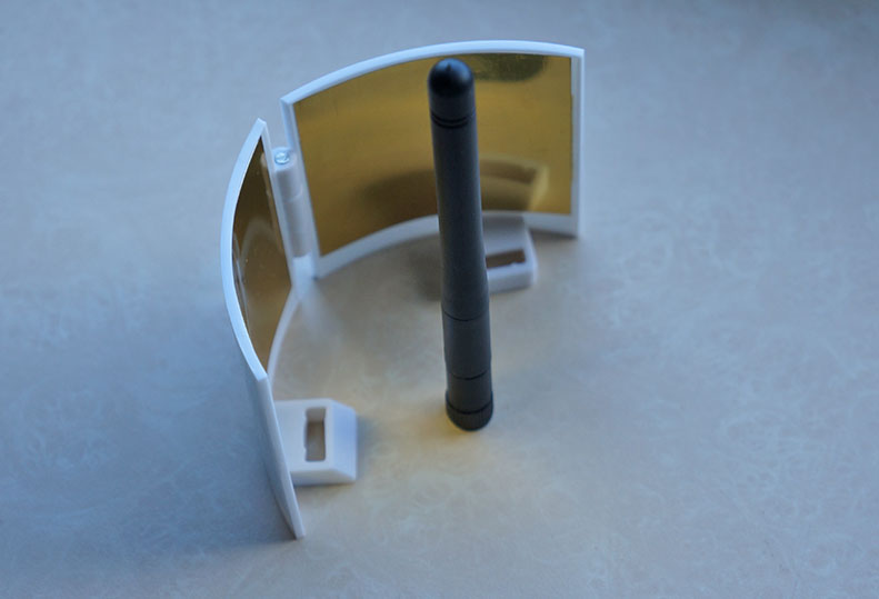

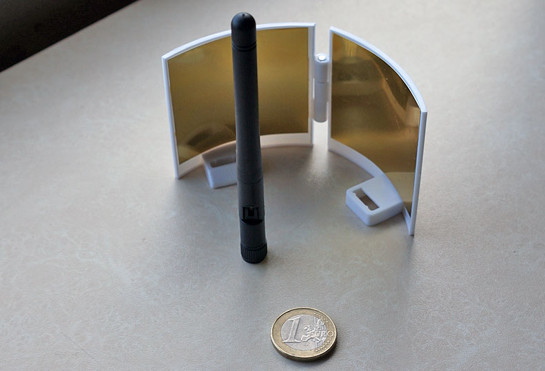

the idea … rotating a reflector around a small antenna to gain a bit in a certain direction.
reflector wil be mounted on a little stepper motor driven platform, with the antenna sticking trough.
well… that’s the theory :crazy_face:
use case : when receiving location data from mobile tracker the antenna follows the tracker

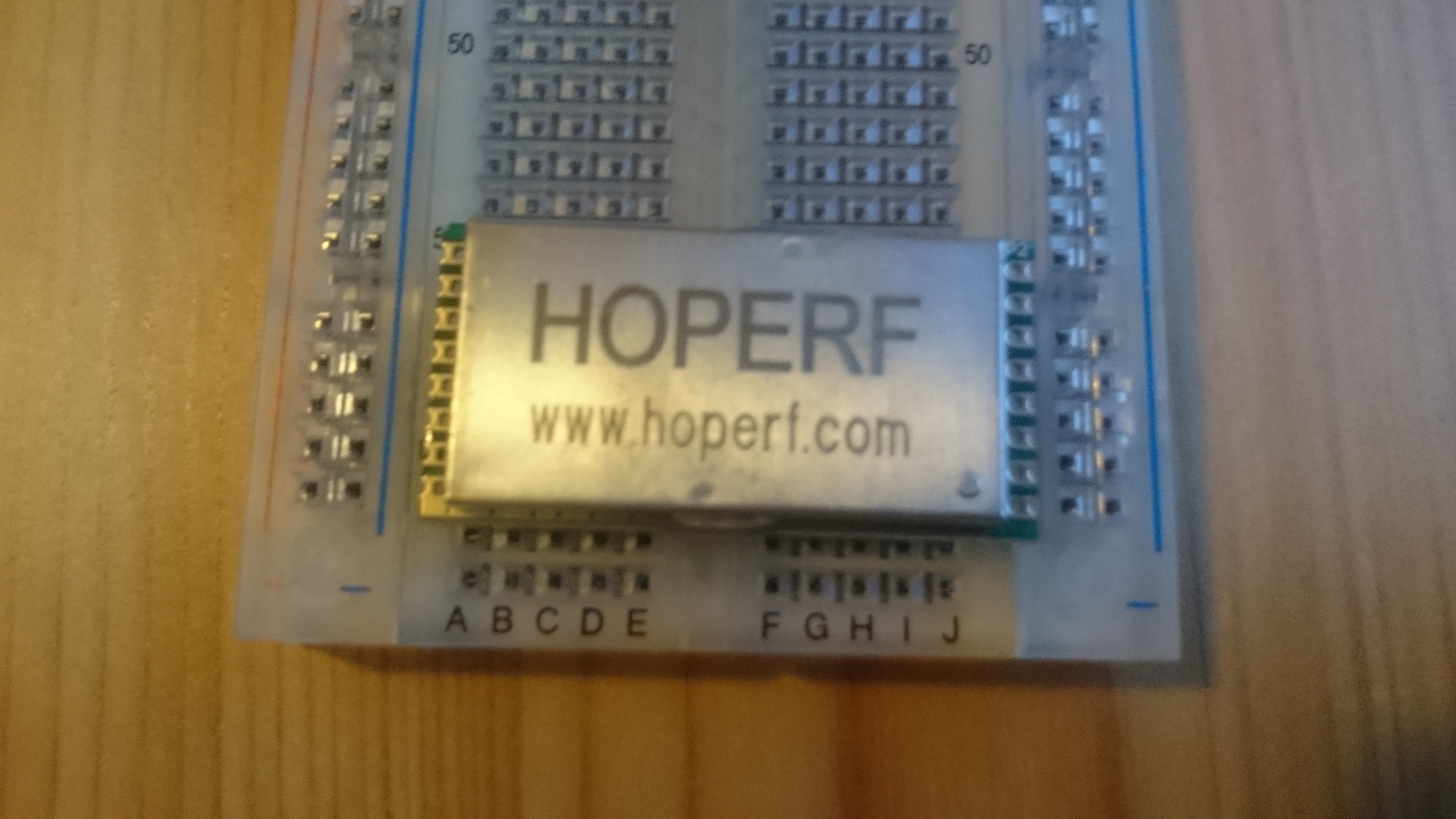

#342
The new RFM95PW is slightly too wide for one breadboard :weary:

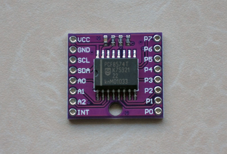

SCL and SDA for multiple SPI devices? :crazy_face:
#346
:wink:

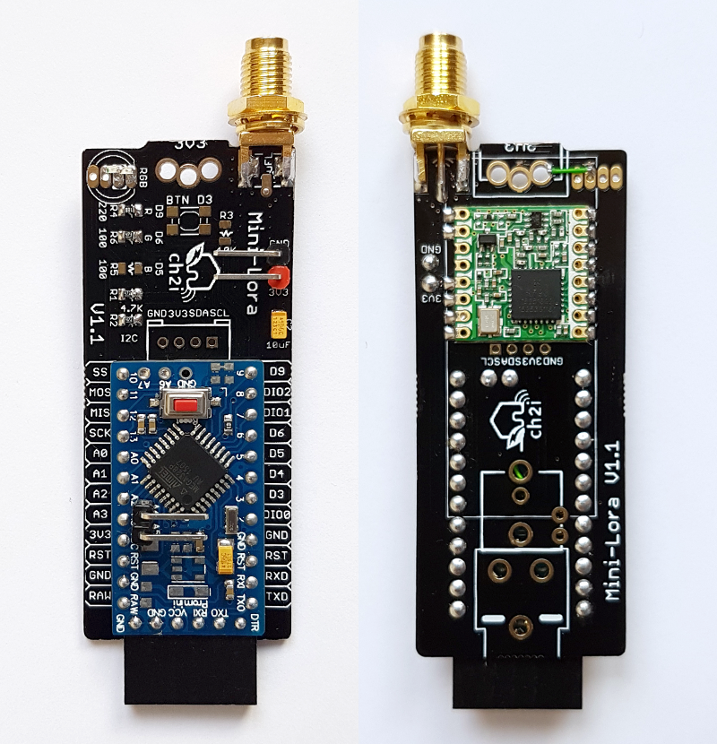

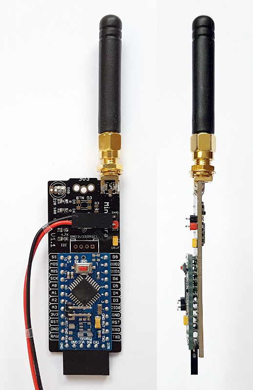

#348

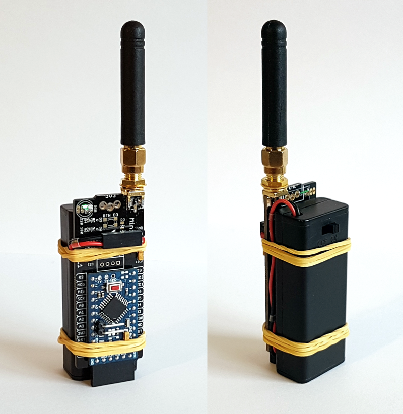

‘LoRa Warrior’
Based on @Charles’ very nice Mini-LoRa PCB (with minor custom modifications).
Arduino Pro Mini (stripped for low-power) + RFM95W module, standard 2x AAA 3V battery compartment and 5cm antenna.
#349
sexy :wink:

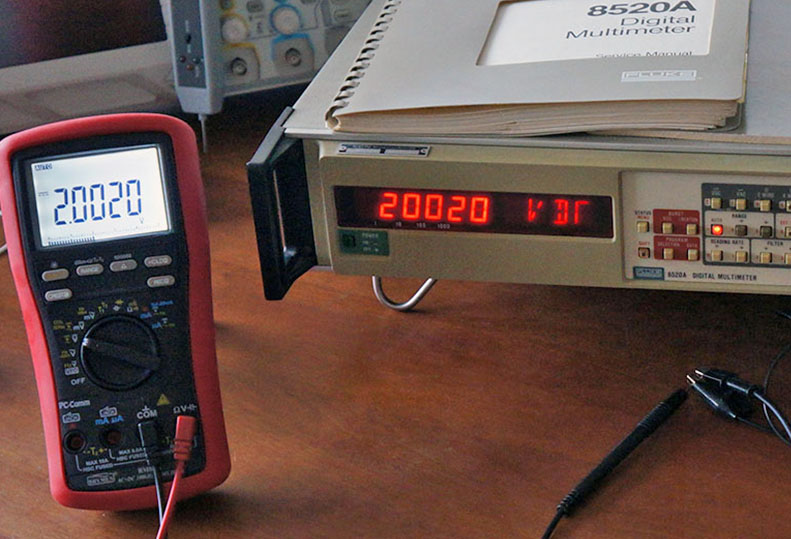

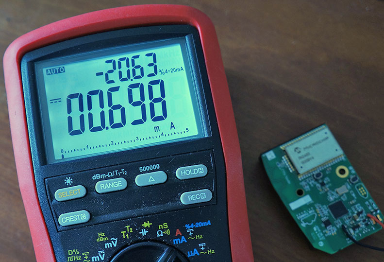

I can recommend this multimeter

If you are in the market for a low power measurement device. The new EEVBlog multimeter has got uA range same as the uCurrent Gold.
#357
are they sold in the EU ?

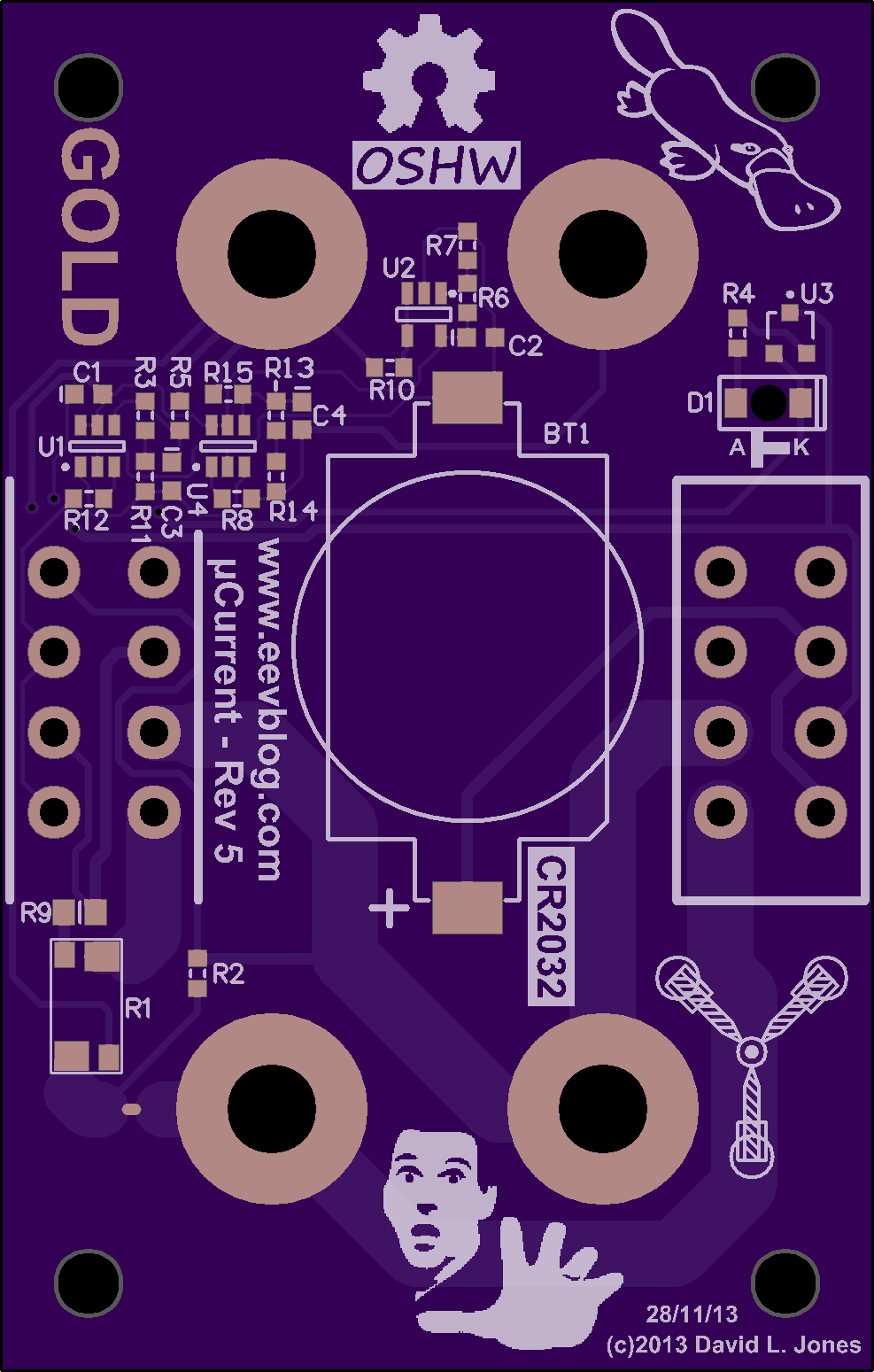

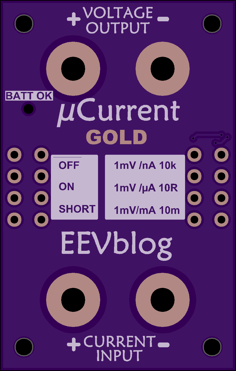

#358
@bluejedi Yes I went to LowPowerLab, Felix don’t do it anymore. so the last solution is a DIY
It’s open source so you can get all here including gerber files and BOM file, should be easy to make :wink:
You can order uCurrent PCB directly on OSHPArk

Nice but around €420, way over my (hobby) budget.
#360
Nice but I think this will suffer the same issues as even very expensive ones when measuring very small currents.
