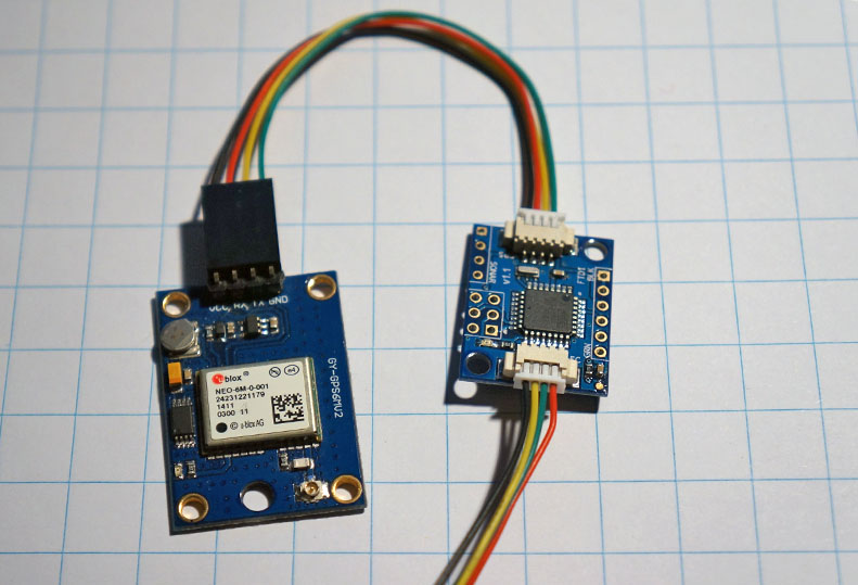

an interesting option is to connect the GPS over I2C with the help of THIS module.
advantage is that you have complete control over this 'converter so you can use it as a filter.
Interesting, the Ublox GPSs do already support I2C of course.
in combination with that type of ‘china’ U blox modules ? … No, never seen that
I played a bit a few years ago with that module and it works, they use it alot in RC world.

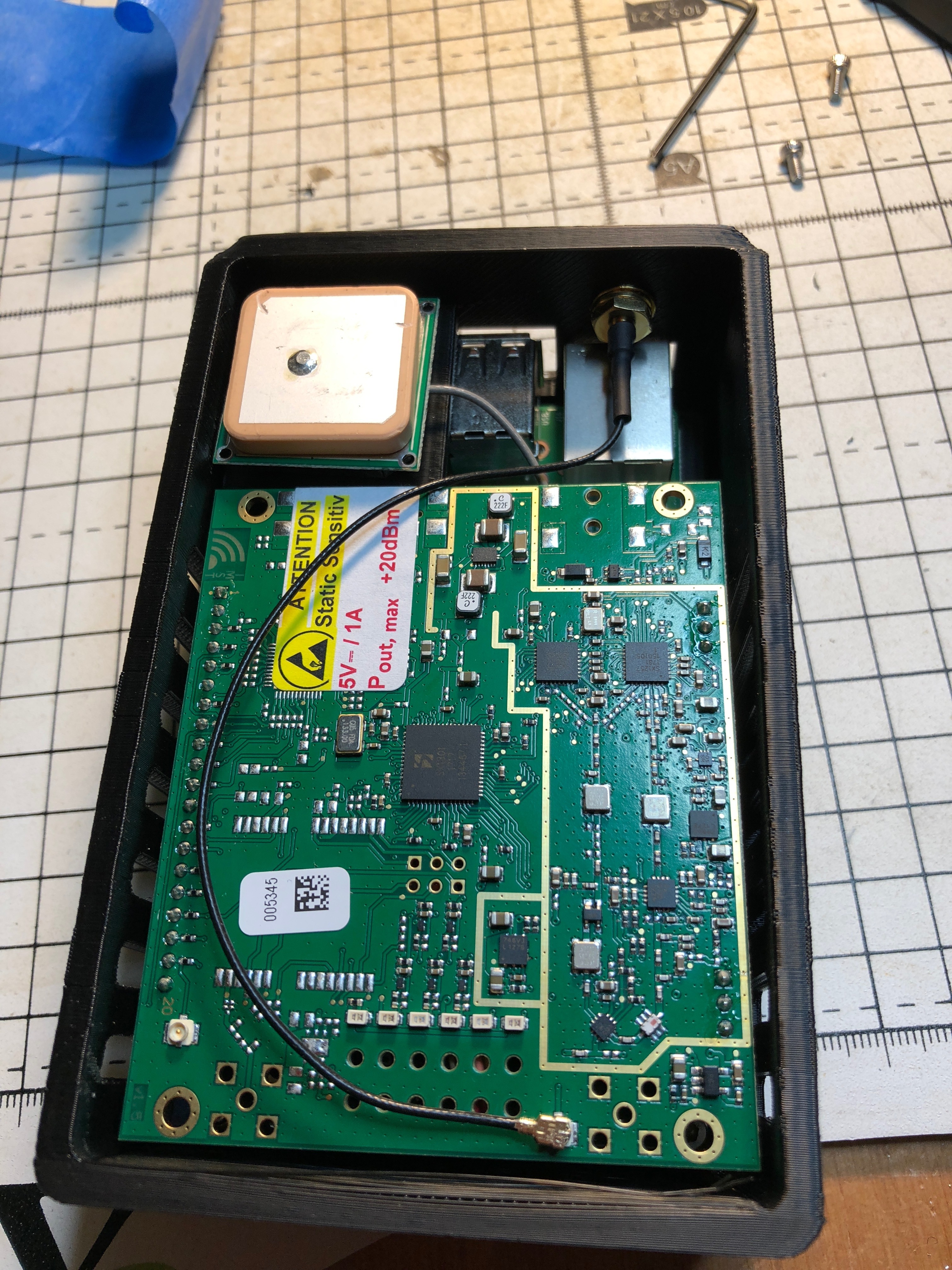

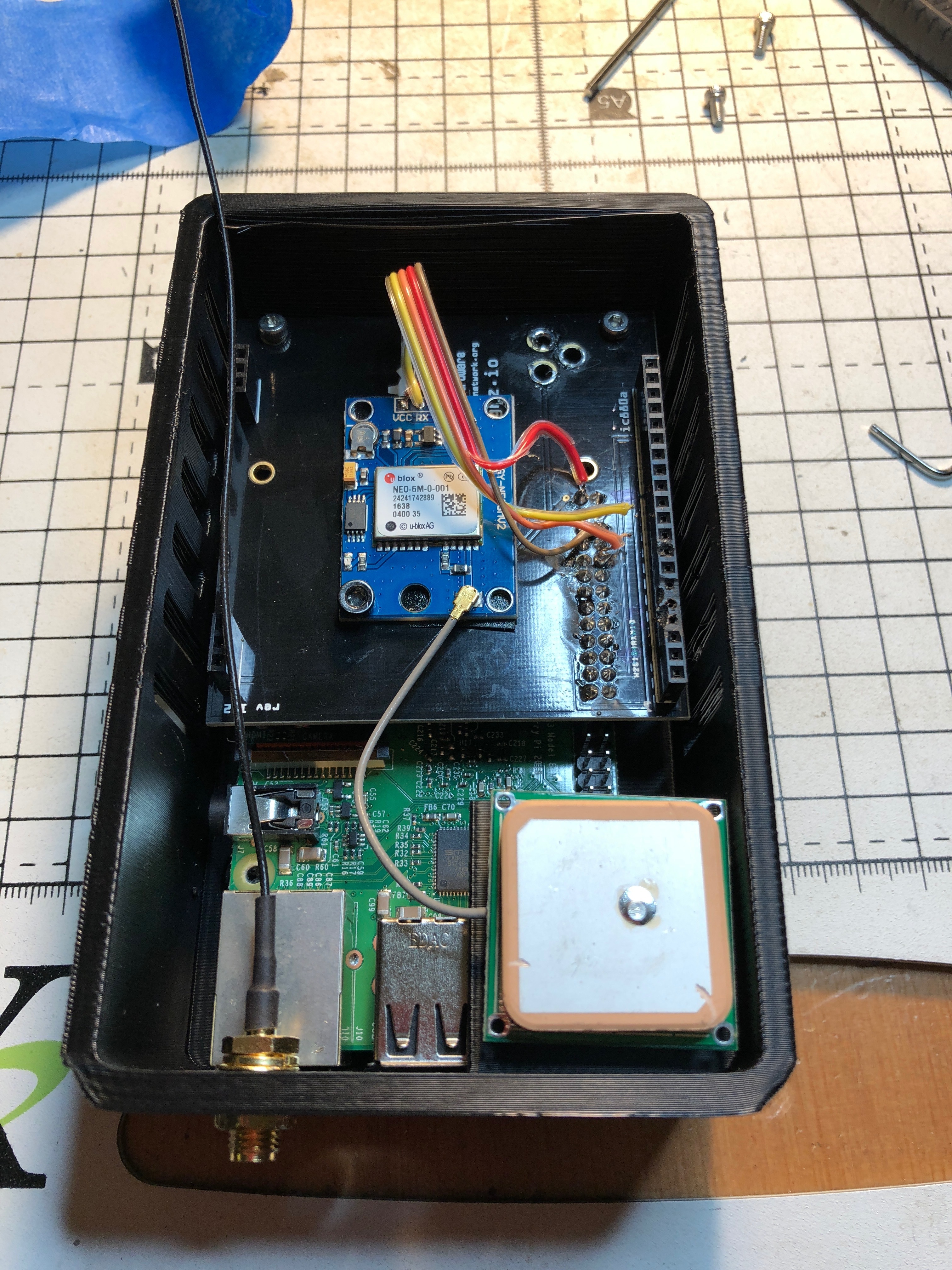

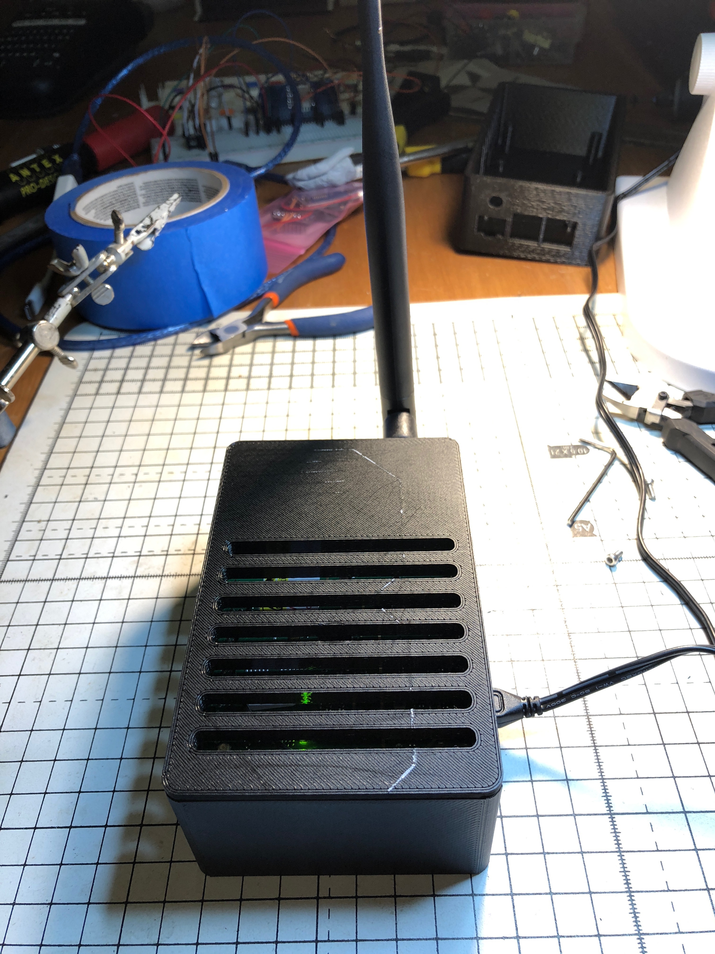

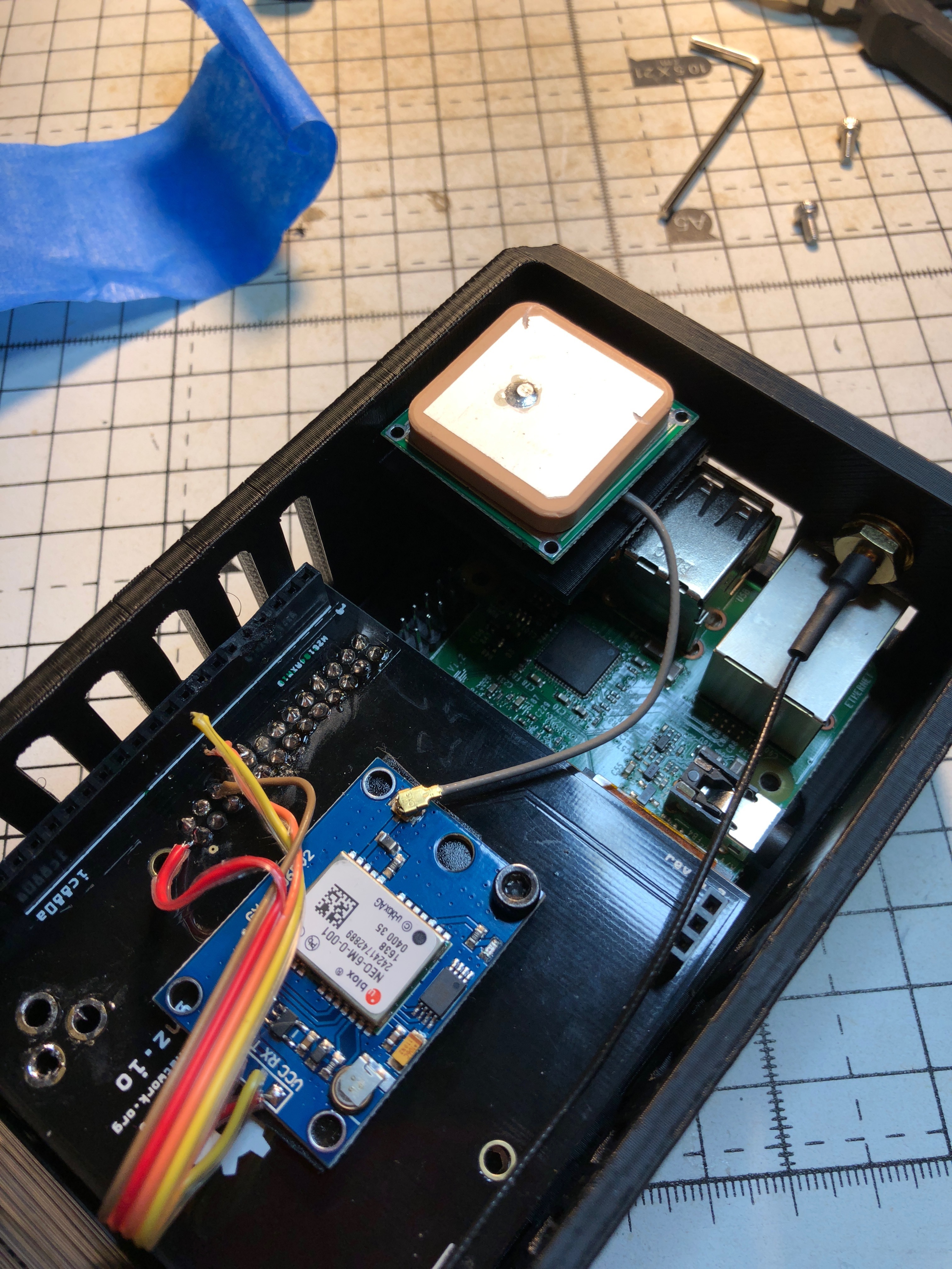

I’m pretty new to the group (and TTN in general). I thought I’d take a break from trying to get the new gateway working, and post some pics of the unit itself.
Case from Thingiverse with a minor mod to hold the GPS antenna. I’m using the backplane between the Raspi and iC880a for the GPS module itself.

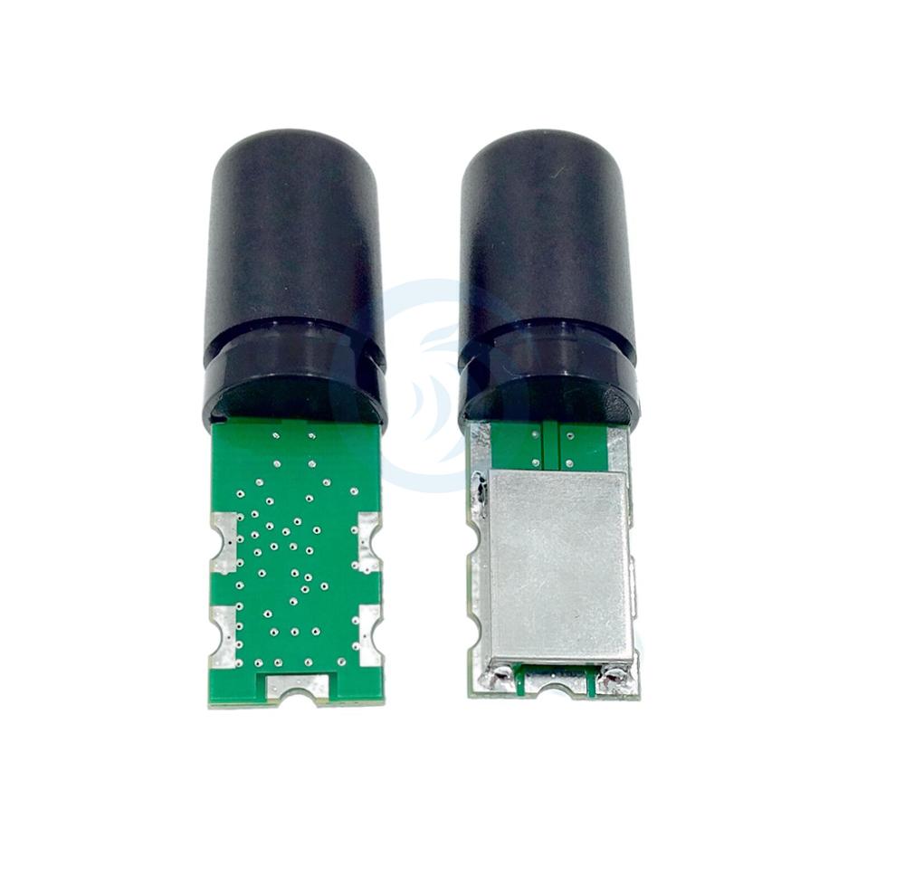

always a problem those ceramic antenna’s… sometimes they are allready mounted on the backside of the GPS module… sometimes they come with a IPX u. fl MALE to RP-SMA cable, in both cases very difficult to mount in/on a non plastic enclosure outdoor handheld device.
Did you noticed that the metal part is rusting after a while ?
So I am gonna test this one

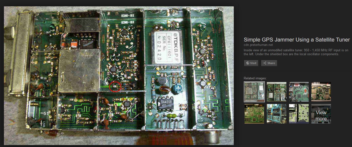

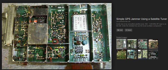

another thing I have been thinking about today , and I write it down here is this :
if you need an accurate timestamp and you have a GPS module in your gateway, what happends to LoRaWAN when the GPS is jammed ?
very well ventilated !
Heh
Well, I can mod the design easily enough, I figured better having too many holes at first rather than too few ![]()
Its a good thing , I like the enclosure , how long did it take to print ?

That case at medium quality was about 4 hours?

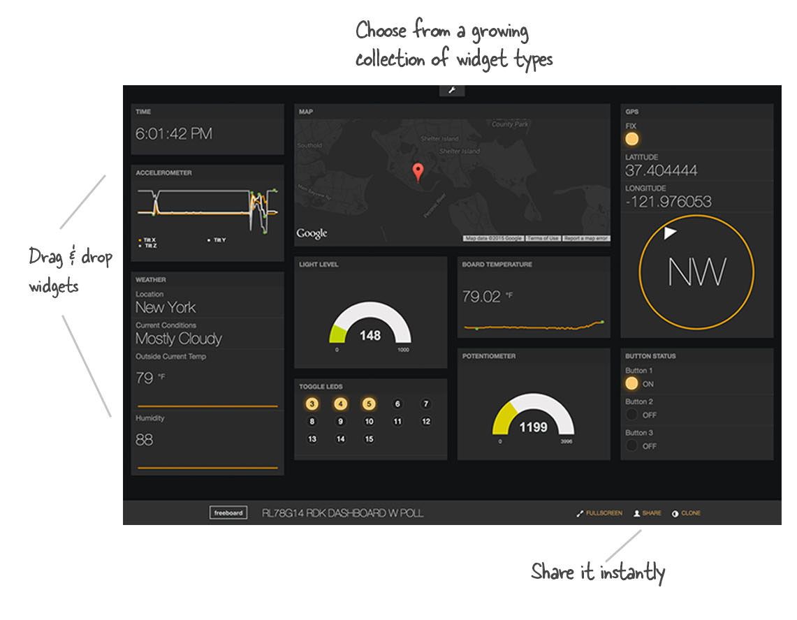

Your freeboard™ account is changing … its no longer free
In 2017, our user growth exploded. While we are thrilled by the usage, it has also significantly increased our hosting costs.
As a result, it’s become impossible for us to continue offering a free-forever, hosted option.
Instead, new users will receive a free, 30-day trial period, after which they will be asked to purchase one of our affordable plans

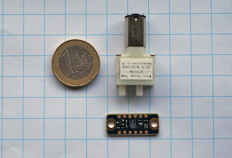

idea : mini desktop office LoRaWAN air quality node
material :
CCS811 Carbon Monoxide CO VOCs Air Quality Numerical Gas Sensor for arduino
want to build that in a little closed ‘box’ and sucking the ‘old’ air out just before measuring with this
DC3V Micro Vacuum Pump Super Mini Air Pump
that’s also an argument for buying/building a 3D printer … I need that little special enclosure
FYI you need to take some extra steps (for instance epoxy or varnish application) with an FDM printed object if you want to get sure of it being air-tight - and it’s the same for water by the way.
Out of curiosity, why do you need a pump ?
