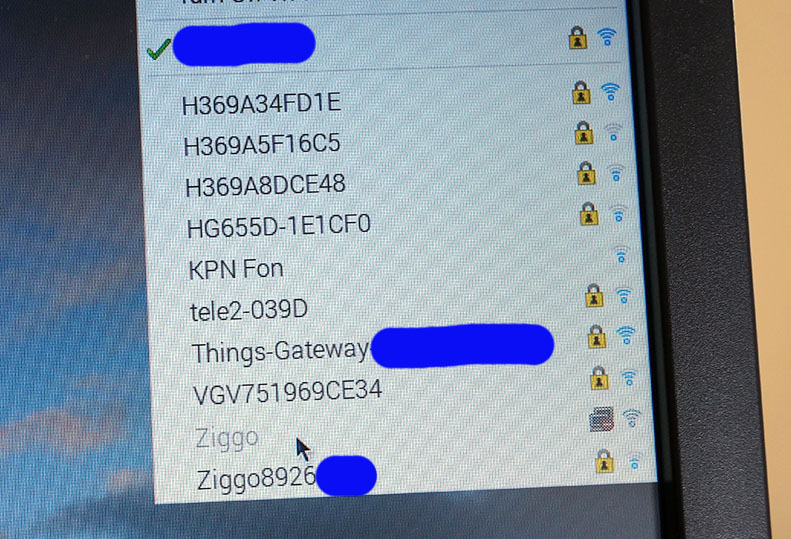

? is it possible to get an RPI (gateway) working on ZIGGO WIFI HOTSPOTS (NL) . anyone tried ?

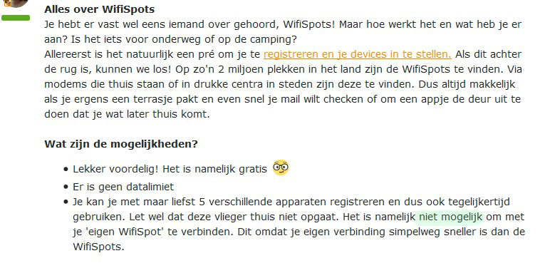

Have you check this message on the ziggo forum? (Dutch)
off course
just checking but I have a problem, you can’t test it on your own ziggo modem, and there’s no ziggo hotspot within reach.
?? Why can’t you?
nope … you can’t connect with your own modem
all ZIGGO Wifispots have the reserved SSID ‘Ziggo’
the one you see ‘blanked’ is your own (if switched on) So you can’t connect to that one and need another one ‘in your street’ according to the site info.
Now I know why people stop and park their car… apparently I’m the only one with that wifispot switched on
I tried but UPC/ziggo is blocking port 1700 (if I am correct with this number) so it does not work.
You can use your “own” ziggo public wifi access point by just putting the right SSID and passcode in the RPI. I do use a separate wifi router which might change things.
yes I was afraid of that

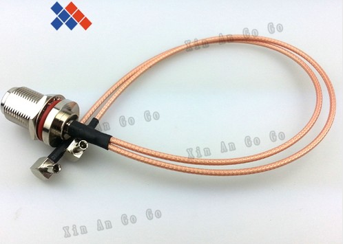

nice… matches with RAK magic stick ![]()
RF N female to Y type 2X TS9 male Right Angle Splitter Combiner cable pigtail RG316 ![]()

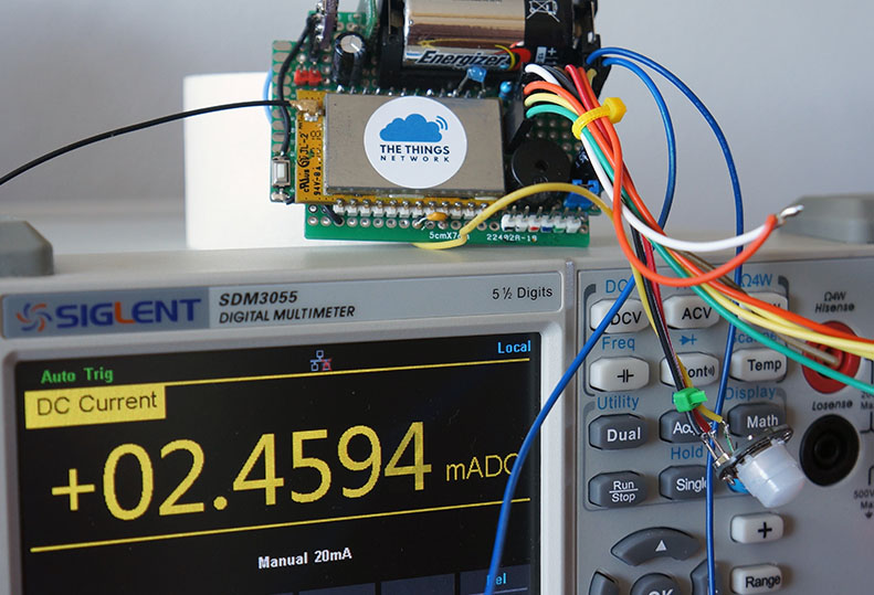

no no no no no NOOOOOOOOOOOOO … that decimal point is in the wrong position
* the rfm95 is not sleeping in this code … how much currentdraw from a sleeping rfm95 … anyone ?
but it’s talking ’ TTN
Less than 1uA, done properly.

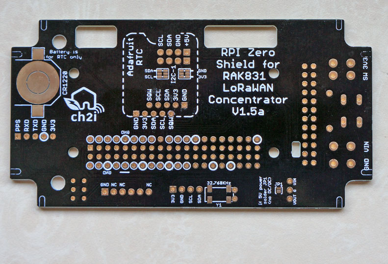

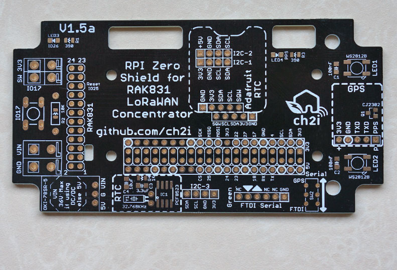

CH2I’s RPi Zero / RAK 831 shield v1.5a (MERCI @Charles ! )
