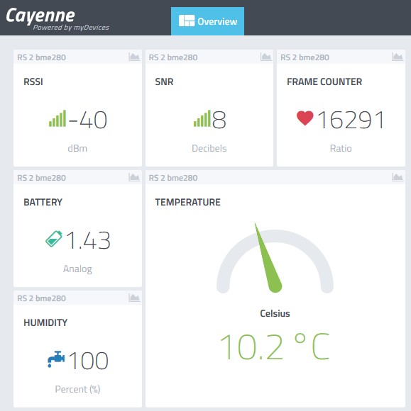

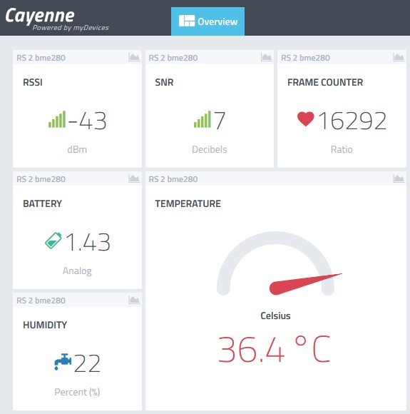

In my code I generate a node ‘frame counter’ and also the TTN backend has a frame counter.
Every time I transmit a frame the arduino increases the counter variable by one and transmit that value.
(for Cayenne I use ‘luminosity’)
The TTN backend , when receives this packet, also increases by one so these 2 values must be equal or we missed a frame.
For example, if it starts freezing like -5, there is a chance that the RN2483 (old model) wil stop transmitting and when then later the temperature rises, it will start working again… these 2 counters could point to that possible problem.

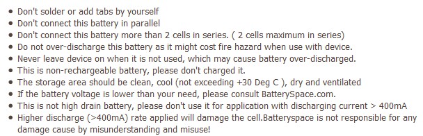

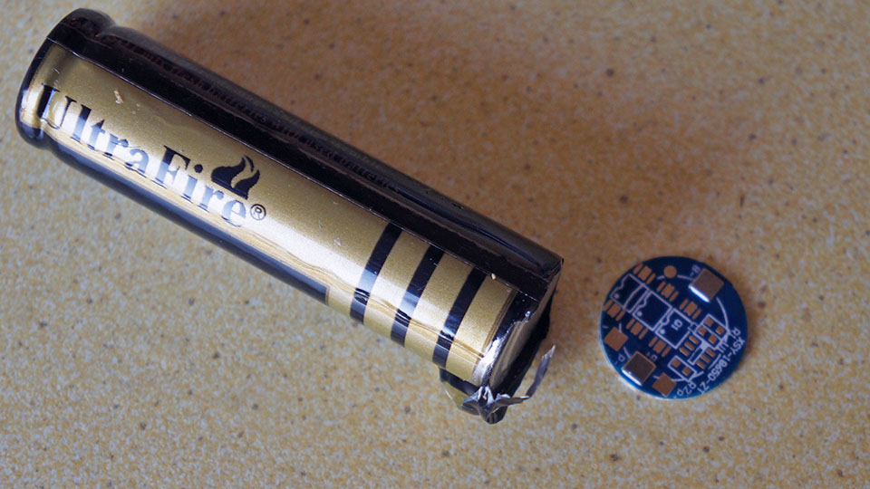

that’s why I couldn’t charge this new very cheap battery … the protection circuit has no components.

for the second time in 2 months trying to get the very fast 100% humidity reading from the BME280 sensor below the 100 :sunglasses:

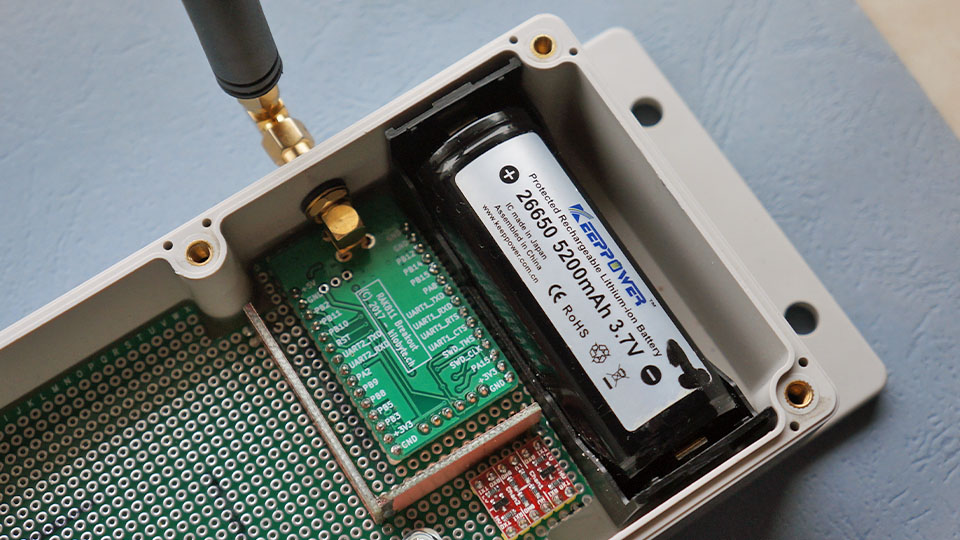

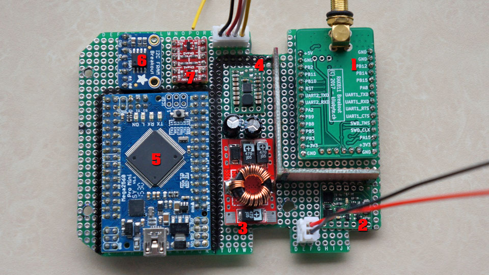

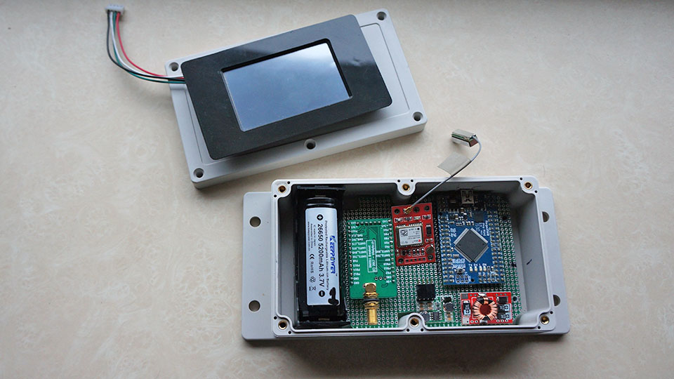

RAK811 portable programmable TTN node under construction :sunglasses:

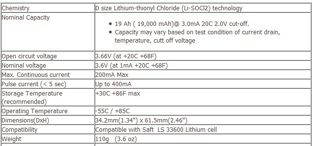

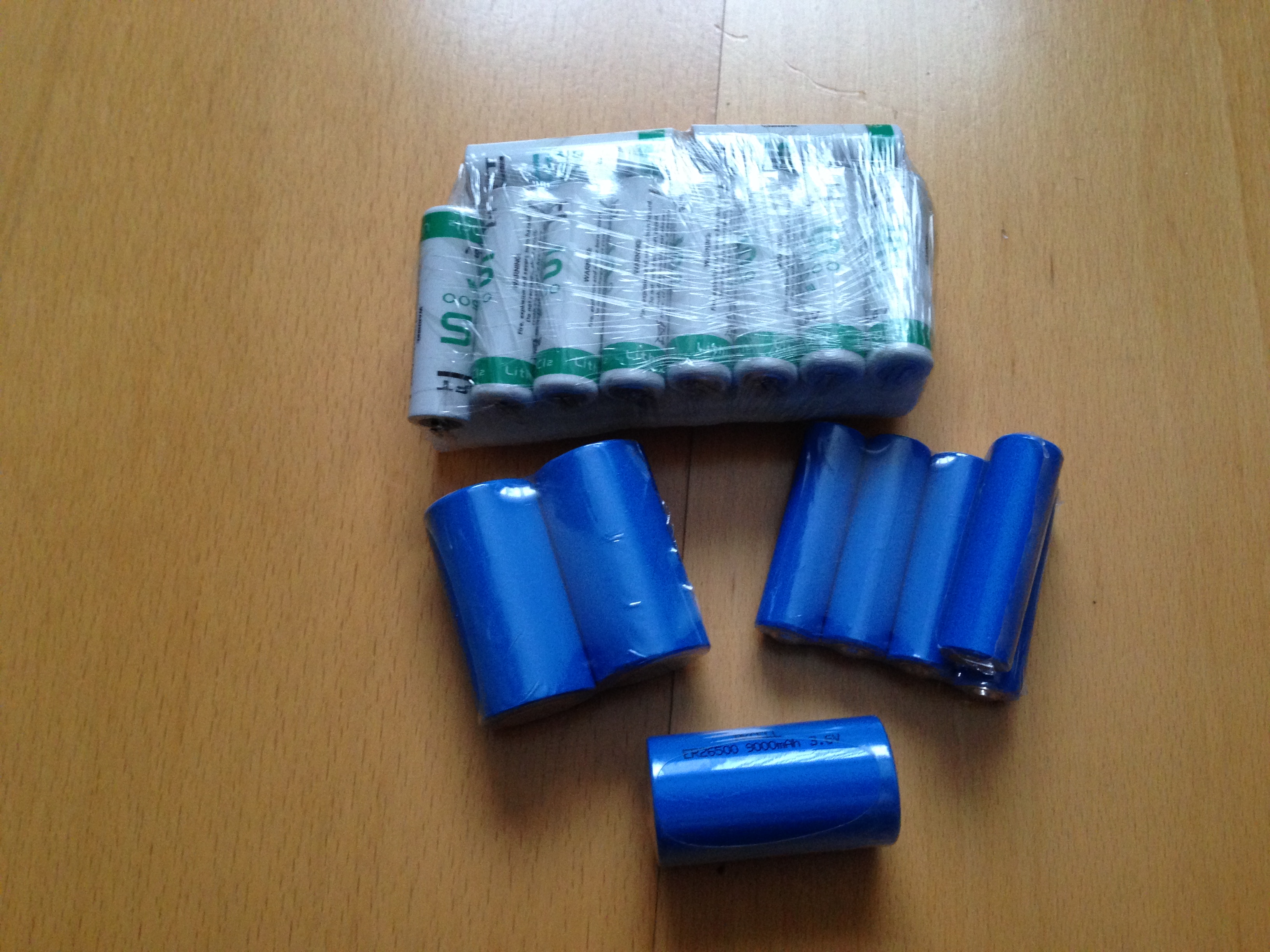

almost forgot that I ordered them… 19000 mA - 3.6 V non rechargeable in D format :sunglasses:
ER34615-1
ER34615-2
the D size holders arrived to :
x576
Power4Node
mine arrived too, only smaller brother and sister :wink:

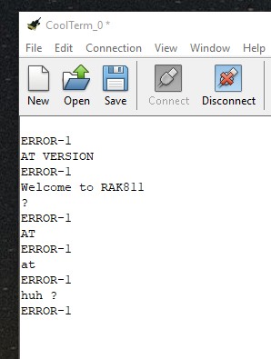

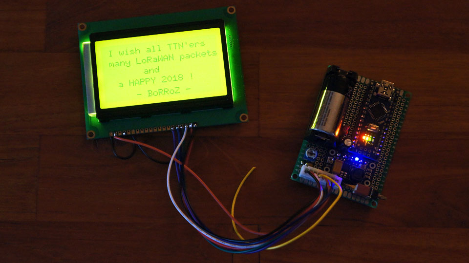

‘quick and dirty’ rak811 measurement board with an ‘leonardo micro’ as uart controller
x575

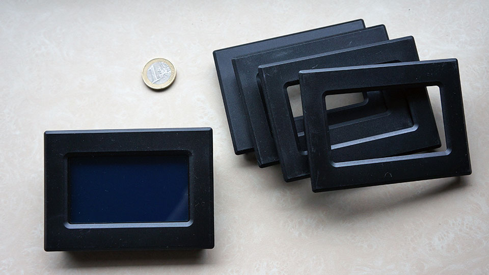

finally found a good solution to mount 12864 LCD displays :sunglasses:

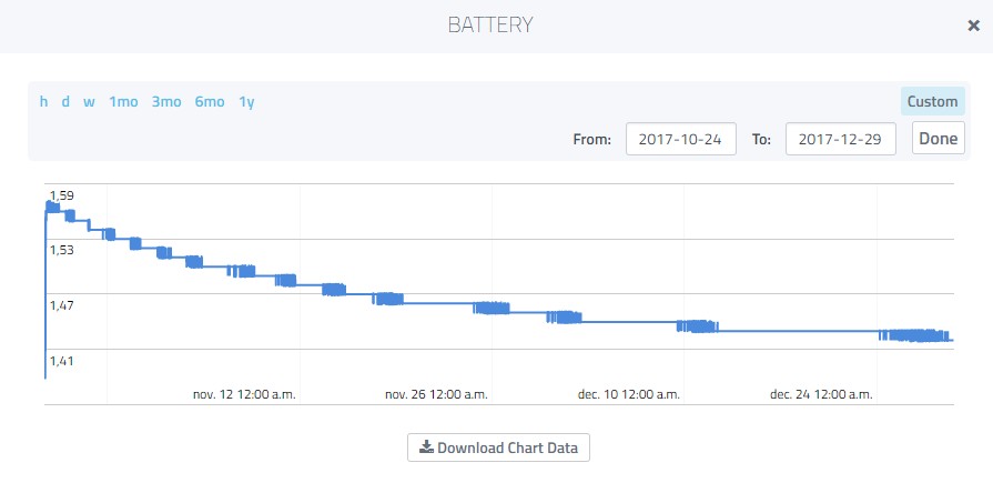

AA battery drainage rn2483A node with 5 min interval

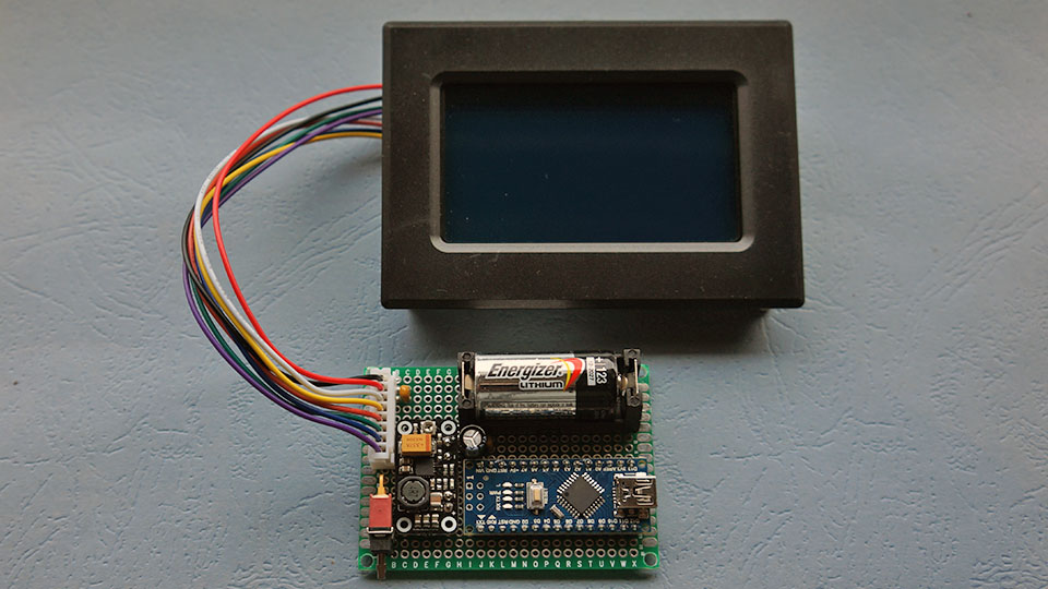

I’m planning to use these small dc/dc converters … got a few in today
