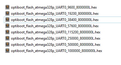

Not tried changing it, the default appears to be the 38400 baud version.
Might be worth experimenting, having the 1000000baud version would be good, 26 times faster.
1000000baud does not seem to work with an 8Mhz processor.
500000baud seems OK.

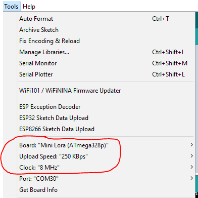

So to resume, you can burn MiniCore bootloader or mine (both have same base), but mini core Arduino Boards does not allow Arduino IDE to select serial port speed (for uploading), so I just uploaded my boards definition to help you with Mini Lora board. It’s located here
cool… I will try that, saves time when debugging tnx

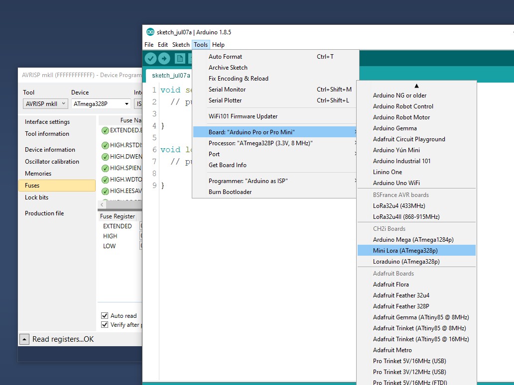

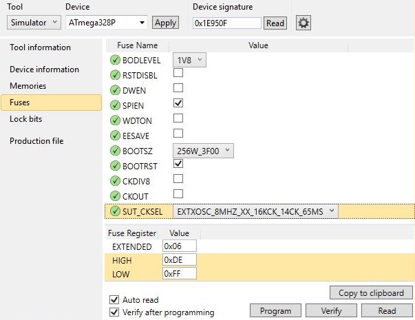

and if I use this bootloader
what setings do I use ?? have the CH2I boards installed
@BoRRoZ
This bootloader is quite old (first old try and don’t know what serial speed it is.
So, please use one of (depending if your Arduino target is 8Mhz or 16MHz)
optiboot_flash_atmega328p_250000_8MHZ.hex
optiboot_flash_atmega328p_250000_16MHZ.hex
Flash Memories with the hex file above

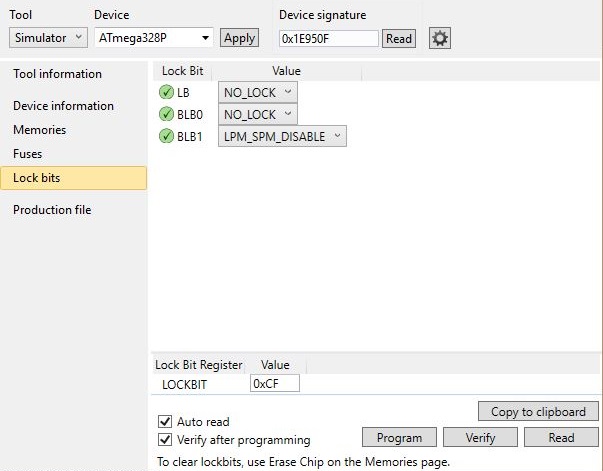

Flash Fuses
- Then Flash lockbit (lock bits should be flashed last EACH time you flash bootloader)

Yes, was a bug in board definition, it’s now fixed, and I added the new board LoRa Radio Node
Check out the pre defined boards in the readme.
