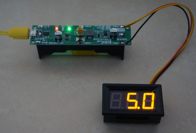

single 18650 mini ups

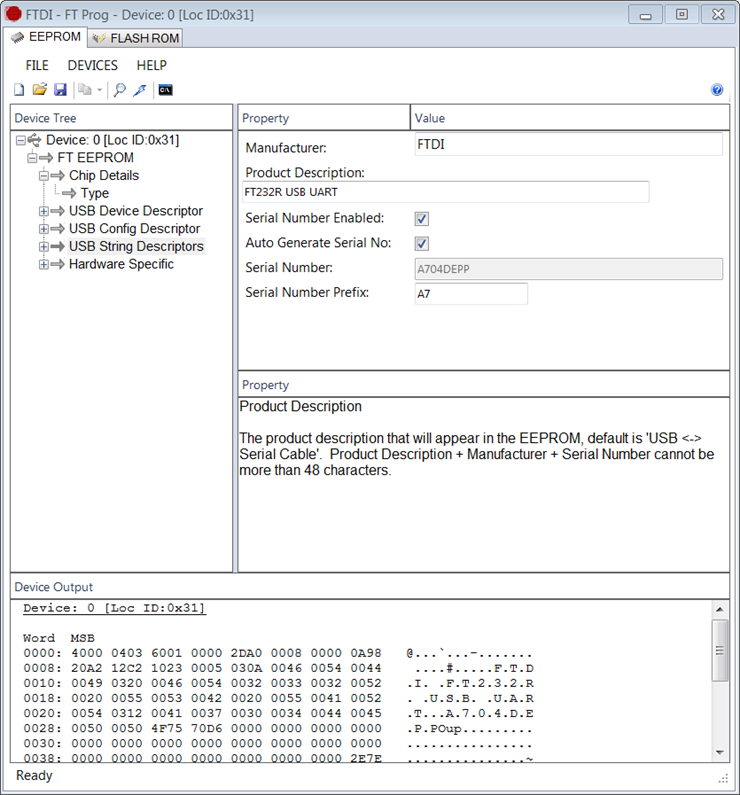

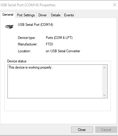

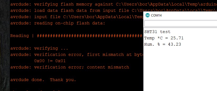

that’s new… after the bootloader update and now the higher speed I get always verification error’s.
but the code compiles and works… any idea ?

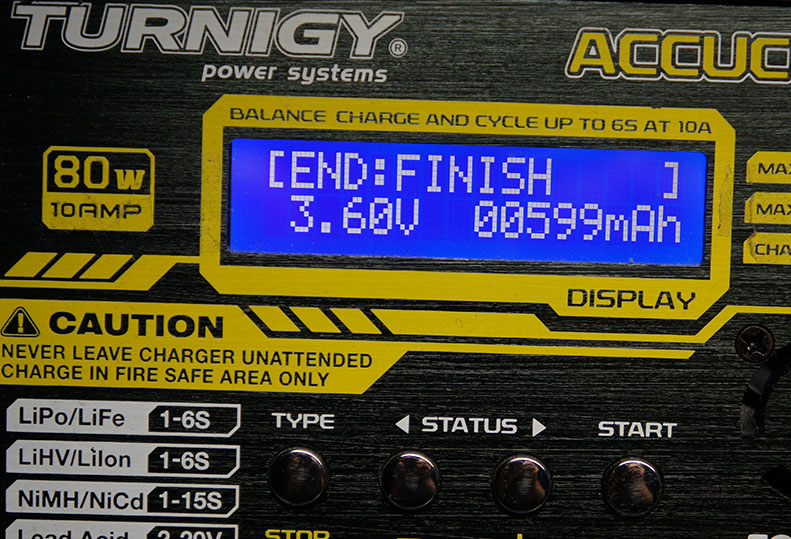

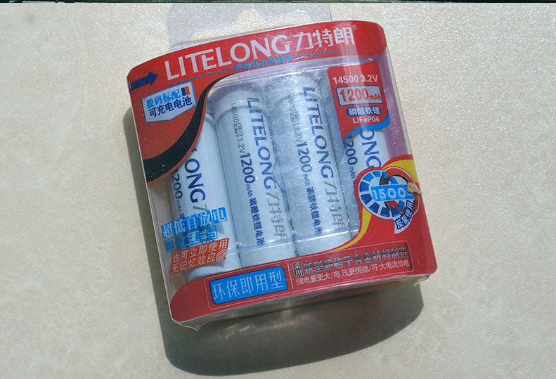

@bluejedi … ok … you’re right… 1200 mAh should be 600 mAh
In short… don’t buy LIELONG batteries !
- and it’s getting worse, I suspect that they can’t be recharged at all, I complained yesterday but that is removed/not published
what speed, what FTDI type ? maybe too high ? never saw that

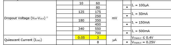

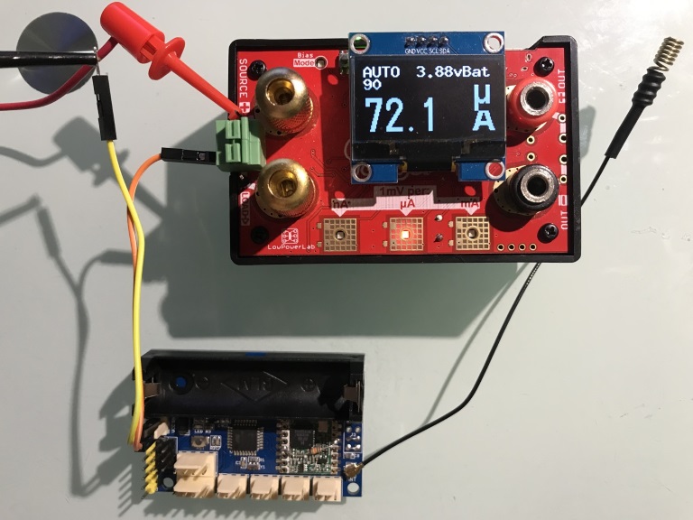

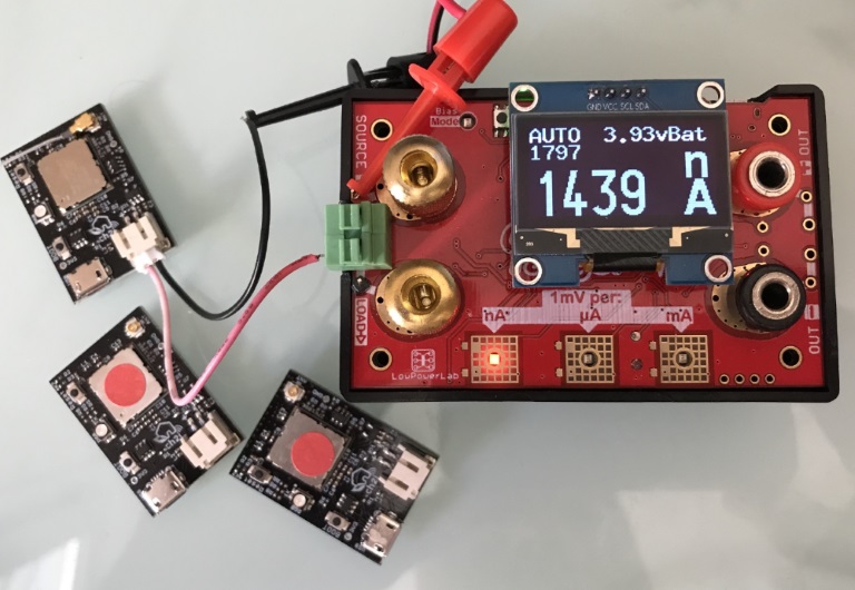

Not bad at all (VCC = 3.6V)

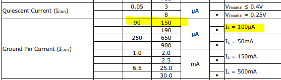

Fault credit to SPX3819 Regulator Quiescient Current ?? Strange because that’s the only component consuming, and different from Mini LoRa
Correct , Charles, learn to read datasheet, the fault is really from regulaor
So remove, bypass or change regulator could bring you to 2uA? Not sure Now I’m sure it’s the regulator
Note that LED on D13 (SPI SCK) is not a good choice either, unable to blink during join because SCK line is used my LMIC to drive SPI
So I prefer this one, note it’s nA not uA

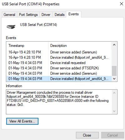

had a closer look but I think something went wrong after an (w10) update… have to investigate further.

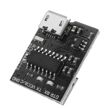

it’s a 'normal FTDI and @ 250k

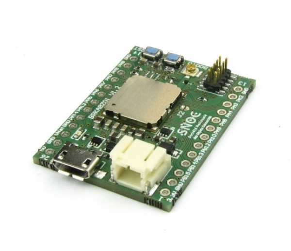

these little boards , can you tell us more , see your logo on them ?

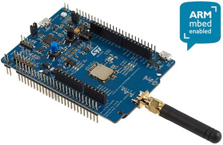

@Charles Are those Murata Lora modules or some else?
was looking into them yesterday. https://www.murata.com/products/connectivitymodule/lpwa/lora
Well talking FTDI, my experience is to say “nothing is normal” until you buy a real FTDI chip cable for $20, I had really bad experience with some FTDI fake that break the chip
So now I’m using this one (got a ton) you can select 3.3V or 5V with onboard regulator, no fake chip risk, it’s a chineese one
The little board are murata one for a customer POC
Hi have removed both protective diode and regultator and am currently at 11 uA while in sleep.
Correct, it’s this one CMWX1ZZABZ-078

That’s really interesting because something is strange, I put the same code on Mini LoRa got 4uA in sleep and here 70uA and datasheet of regulator SPX3819 says 5uA max, so I should be under 10uA, this is driving me mad
I used a code base derived from @lex_ph2lb to get this result.

true… I’ll try a few different usb-serial modules first
