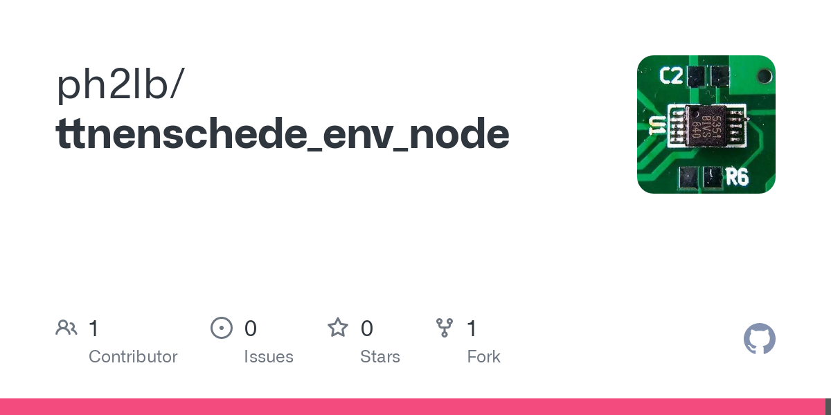

and of course I’ll have to ask… where can I find it , lex’s code ?
for battery level I have CH2I lib so no resister divider
14399 nA … WOW… I’m jealous :rofl:
I think he maybe is using this one as described in this post :
@pe1mew, please correct me if i’m wrong.
