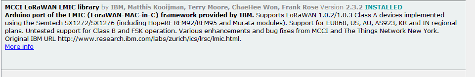

I am now using the arduino-lmic library (newest version):
Using library arduino-lmic-master at version 3.2.0 in folder: C:\Users\bobin\OneDrive\Dokumente\Arduino\libraries\arduino-lmic-master
