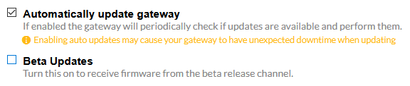

Hello,
Do you know if there is something particular to do to trigger the install of this FW update ? Our TTIG was online for 2 weeks straight with the following update parameters in the TTN console, and not much happened. I’d like to try it to see if this could help in solving some join issues we’ve been having.

Yeah indeed. We did roll out updates which we paused for a while. This will resume in the coming weeks. And indeed as mentioned, this update does not influence LoRaWAN functions of the TTIG. Version 2.0.0 already supports all of that.
Please check my post here; Rollout of Basic Station 2.0.4 for TTIGs
