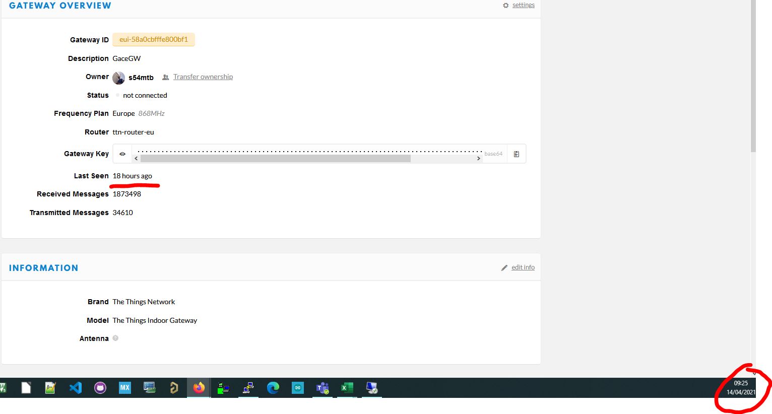

It is a well know thing that the gateway status isn’t working well, so this has no real value without you telling us if any uplinks are flowing through the gateway. Leaving aside the lack of text with the implied assumption that someone else figure it out for you.
OK, sorry. The TTIG gateways are shown as not connected, but the devices in the console shows traffic through them.
So if you read this thread and particularly the link given a few posts up by @Jeff-UK, you’ll find out that this is the new normal.
