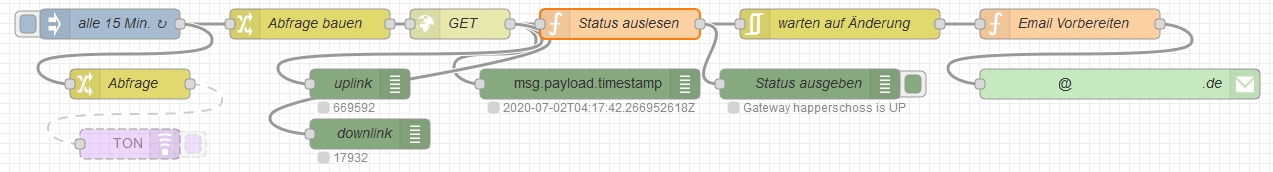

hey gooood morning – interesting idea to ask status via ttnctl in node-red – i am doing it with the GET command via the http-request api from TTN ---- but sometimtes the api is not working and indicates that all our gateways are off – (but they are not) — can you share the node and/or flow ?
http://noc.thethingsnetwork.org:8085/api/v2/gateways/{{{query}}}
the {query} is variable is built before with the name of the monitored gateway (with a function node) – also i ask every 15 minutes and check the time difference – if we have a difference between the calls – the status is “UP” - otherwise if the time is same or empty i send “DOWN” ---- afterwards i use email and/or telegram bot to inform our local communtiy team about the breakdown ----
if someone is interested in the flow just send message …
