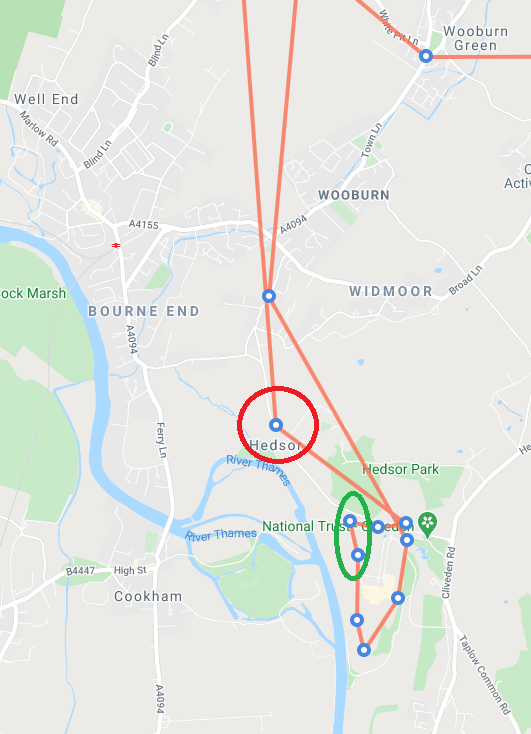

Whilst the Marlow GW above was intended to cover an area roughly 100m - 2km from deployed site (working with other GW’s in the area), yesterday whilst out doing some coverage tracking tests along the Thames Valley/Clivden escarpment using RAK and Dragino based GPS trackers I saw some signals picked up which I am sure (red circle) in one case and 2 highly probable (green elipse) signals on the Dragino LGT92 (Havent had chance to check the GW meta data to confirm), which were collected by the GW some 5-6+km away on elevated locations.

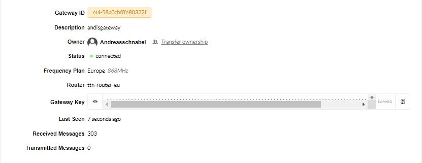

Hello! I have the same Problem…solid green LED and the Status is “not connected” and there is noch traffic.
The Gateway ID is eui-58a0cbfffe80332f
Can somebody help me solve this issue?
Thanks in advanced
Andreas
Today the Gateway ist connected, its received Messages but didnt transmitt the Data.
Any idea?
Thanks! Andreas
