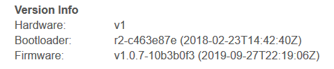

Ok … that seemed to work and get me closer! I’m now at v1.06?
Version Info
Hardware: v1
Bootloader: r1-7167873a (2017-06-02T13:48:18Z)
Firmware: v1.0.6-d8cb4c30 (2019-05-17T07:19:39Z)
Are most people running the “Beta” version to get to v1.0.7?

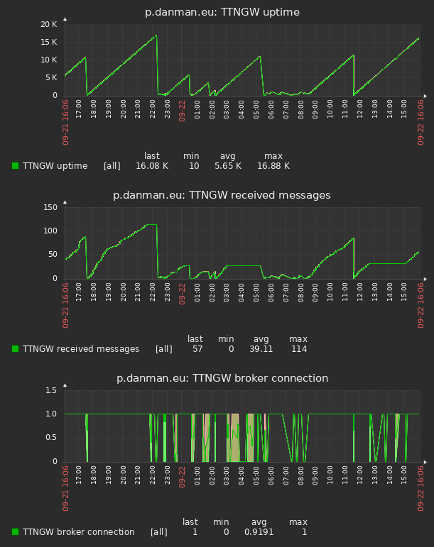

Is there someone still experiencing reconnect issues? I want my gateway connected via WiFi and I was able to make some improvements in the firmware so I went from this:
to this:
Here is my current branch:
I can also provide firmware images if someone is interrested.
There are still some minor issues but it is at least acceptable now.

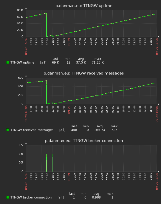

I’ve also created a esp8266 firmware which captures logs on TTNGW and sends them to my syslog so I have all logs stored on my server like this:

Hi, Great work! It is the first serious attempt outside TTI and Tweetonig I know to improve this firmware. Thank you. As I cannot compile myself I am happy to test and share my experience.
Ok guys, here is the latest compiled version for you to try:
https://s.danman.eu/ttngw/
Upgrade the usual way: FAT formated SD card with folder “update” and these files in.
Keep you posted about the results
Today I found time to start the test. I have copied the new firmware to the uSD card and booted the gateway.
now we wait and see.
As can be seen I use V2 bootloader.
Hi @danmaneu Here are the first results over last night. In my case it is not promising other than that it seems that connection is recovered faster with this firmware.
I have information from to types of logging:
gateway logging
Where my gateway never goes doew when it is connected over ethernet, tonight is was idietified by the script multiple times:
11:10 PM Gateway "ttn_pe1mew_gateway_1" seems down! Last message was 9 minutes, 3 seconds ago.
11:20 PM Gateway "ttn_pe1mew_gateway_1" is back in operation since 22:20:00 2019-10-05.
1:50 AM Gateway "ttn_pe1mew_gateway_1" seems down! Last message was 7 minutes, 20 seconds ago.
2:10 AM Gateway "ttn_pe1mew_gateway_1" seems down! Last message was 27 minutes, 20 seconds ago.
2:20 AM Gateway "ttn_pe1mew_gateway_1" is back in operation since 01:20:02 2019-10-06.
4:10 AM Gateway "ttn_pe1mew_gateway_1" seems down! Last message was 4 minutes, 2 seconds ago.
4:30 AM Gateway "ttn_pe1mew_gateway_1" is back in operation since 03:29:09 2019-10-06.
6:00 AM Gateway "ttn_pe1mew_gateway_1" seems down! Last message was 10 minutes, 55 seconds ago.
6:20 AM Gateway "ttn_pe1mew_gateway_1" seems down! Last message was 8 minutes, 10 seconds ago.
6:30 AM Gateway "ttn_pe1mew_gateway_1" is back in operation since 05:28:59 2019-10-06.
7:00 AM Gateway "ttn_pe1mew_gateway_1" seems down! Last message was 6 minutes, 5 seconds ago.
7:10 AM Gateway "ttn_pe1mew_gateway_1" is back in operation since 06:09:56 2019-10-06.
8:10 AM Gateway "ttn_pe1mew_gateway_1" seems down! Last message was 7 minutes, 48 seconds ago.
8:30 AM Gateway "ttn_pe1mew_gateway_1" seems down! Last message was 27 minutes, 48 seconds ago.
9:00 AM Gateway "ttn_pe1mew_gateway_1" seems down! Last message was 57 minutes, 49 seconds ago.
9:30 AM Gateway "ttn_pe1mew_gateway_1" seems down! Last message was 1 hour, 27 minutes, 48 seconds ago.
9:50 AM Gateway "ttn_pe1mew_gateway_1" is back in operation since 08:50:01 2019-10-06.
11:00 AM Gateway "ttn_pe1mew_gateway_1" seems down! Last message was 4 minutes, 44 seconds ago.
11:10 AM Gateway "ttn_pe1mew_gateway_1" is back in operation since 10:10:00 2019-10-06.
