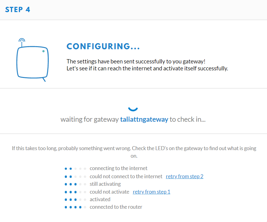

I have registered my TTN Gateway and try to activate it. I come til step 4 and than the Gateway tries to connect to the internet w/o success.TTN GW Actication
LED1 is on LED2 is blining slowly.
If I replace the WiFi by Ethernet it is the same.
What can I do?

Have a look around in this topic. There are many other reports of the configuration process of the TTN gateway getting stuck at the point where it needs to activate over the internet, just after the network settings have been applied. Investigations and tweaking are ongoing. But there is no “end user worthy” fix available at this moment, as far as I know. My gateway suffers from the same. Since I can not spend the time required to seriously dive into the problem, I am checking this forum topic regularly for an update on status and outlook of the issue.
