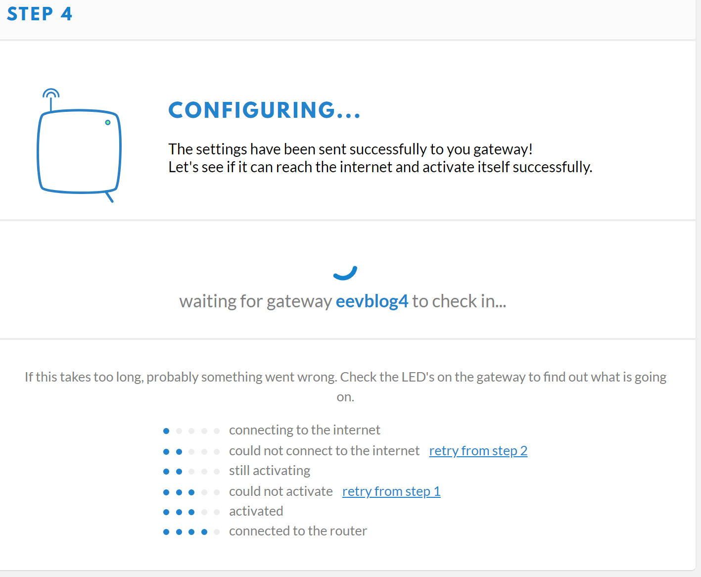

Hi All
Not sure how I can start my own topic on here, so asking this here.
Trying to activate my TTN-001-915 Gateway following the simple instruction.
Tried doing this on a Windows 10 machine connected via ethernet to my WiFi modem router and obviously this isn’t going to be easy, it would not detect the gateway as I don’t know ow to connect and log into it using Windows 10 in this way.
Ok, so I use my phone and connect the Wifi Gateway using the provided password, no problem, try the activate again (using a new device name because it won’t let me use the old one I have used before but haven’t setup!) and it still won’t connect. The LED’s are correct and flashing.
What’s up?
What am I doing stupid?
This is supposed to be an easy 5min setup, and yes I’m making video about doing this, and it’s not a great start.
Dave
EEVblog
Ok I finally got it working on my Microsoft Surface via Wifi connection, but it fails to “checkin”, even though if I log in I can see my gateway is connected and I can map it etc.
What’s going on?
Thanks.
Hi Dave,
Some questions from my side:
  • What connection are you using? Wired or Wireless?
  • Can you tell what indication you see on the LEDs? what is the sequence of the leds?
What I can see is that your gateway is administrated (http://noc.thethingsnetwork.org:8085/api/v2/gateways/eevblog4) but has not send any data to the network:
