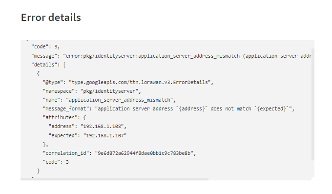

  • I have tried editing the ttn-lw-stack-docker YAML config file’s Console Component URLs sections with 107 as the NS, 108 as the AS, and 109 as the JS. I thought this worked initially and was able to add the gateway into the web console. However, when I tried to add an end device (a sensor), the console screamed an error saying Network Server address mismatch (this happened when I tried adding the device on the AS console), and likewise Application Server address mismatch (when I tried adding the device on the NS console).

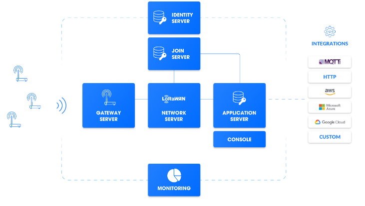

Yes, my bad on this part. Eventually, I would like my entire set-up to look like the image below, just that the JS, NS and AS are on 3 different machines, while all working together as a whole setup. This is so that I would be able to see the key exchanges (would I be able to?) from JS to both NS and AS, and technically achieve the separation of the 3 servers.
Once again, thank you for replying so promptly! Do let me know what other information I am missing, I’ll reply ASAP with the missing info.
